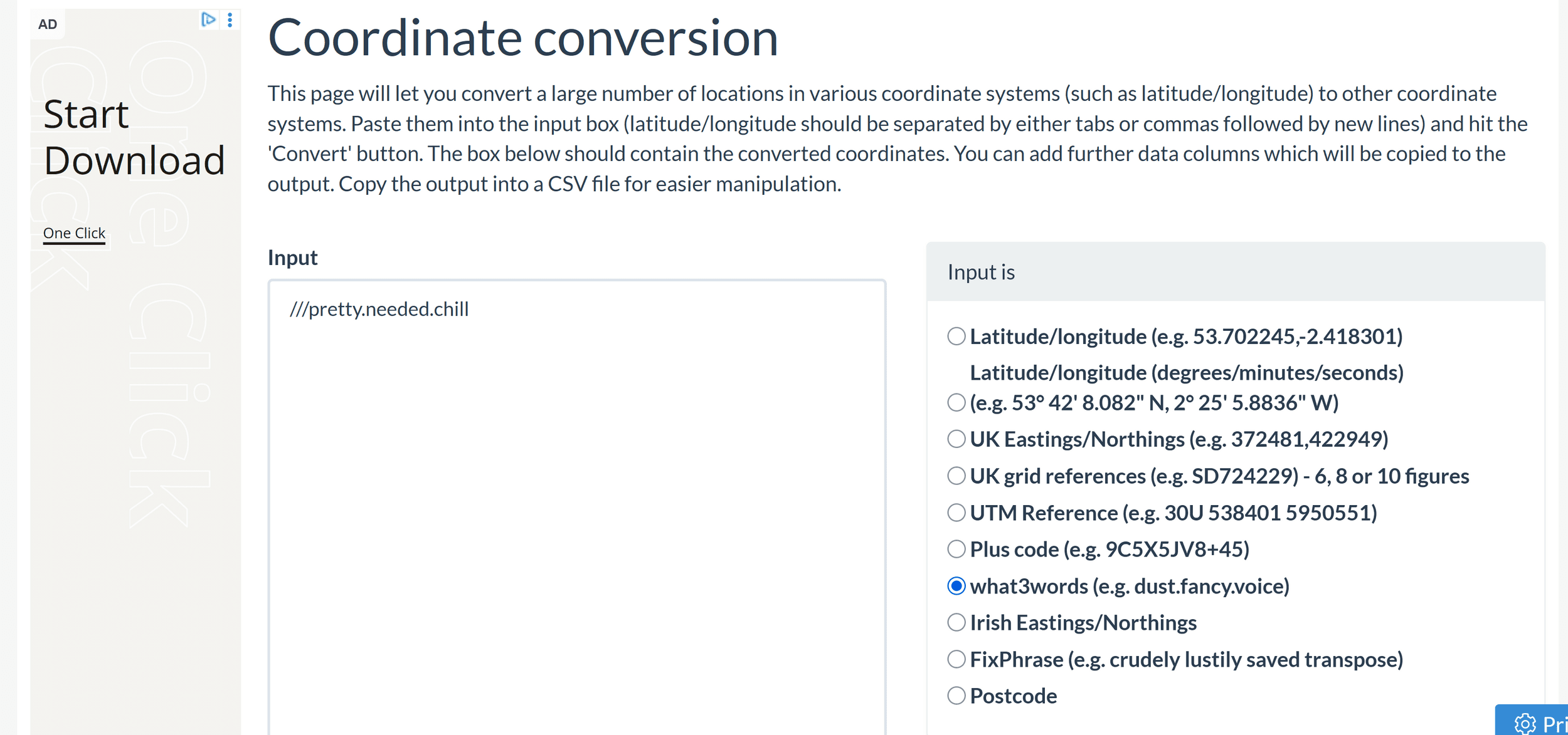

@Tell - do you know if there is any way that what3words can be entered as a navigation point on MIB2 maps? Are there any 3rd party apps that will allow this? Currently running newest 2610 mapping
Try this as a web link

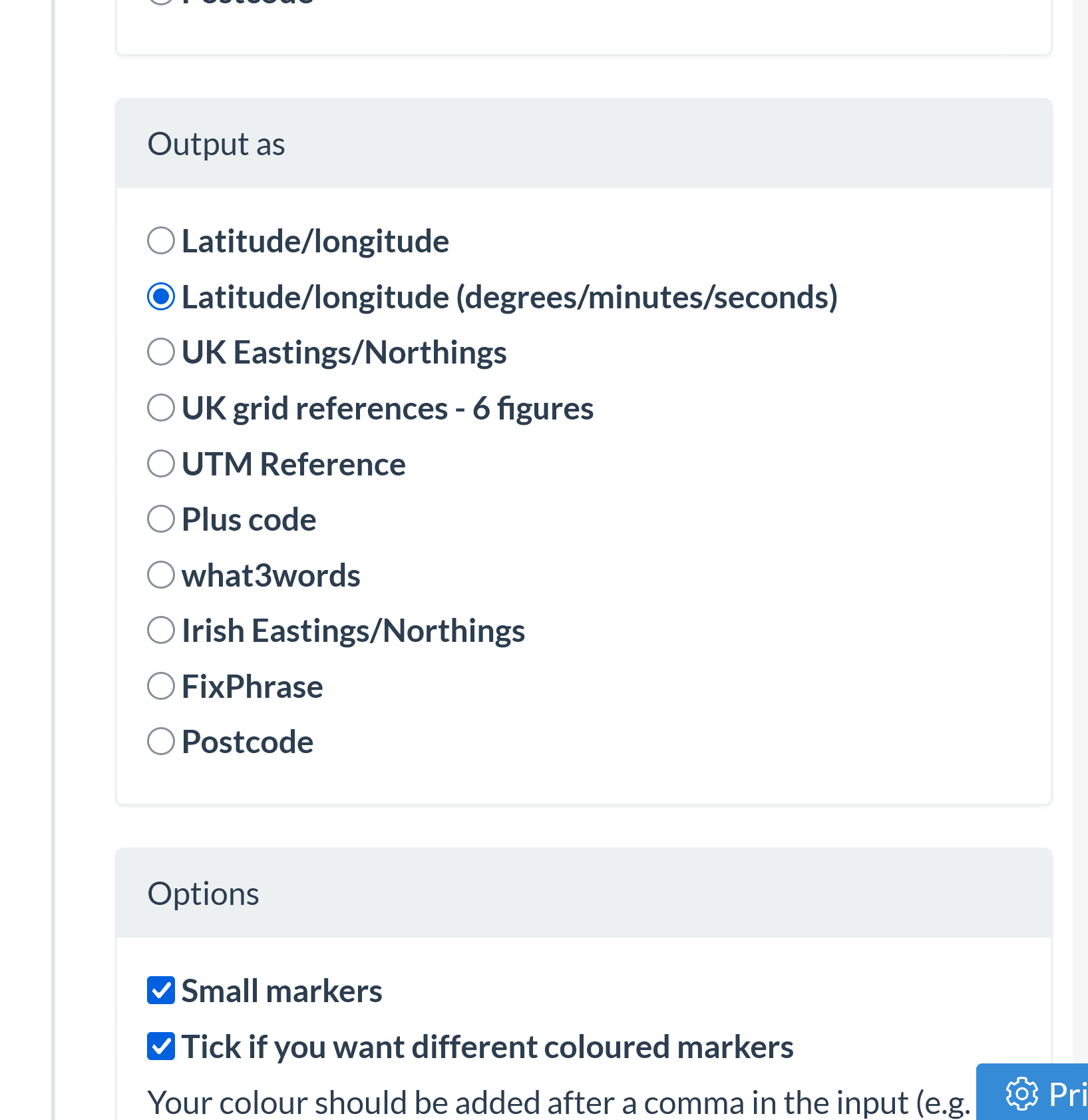

On the cars navigation screen as a new destination entry you dial in degrees, minutes and sends (DMS) it's what the car coordinate system accepts as input.
So that web link gives you DMS.
The abridged instructions with an example.
The answer

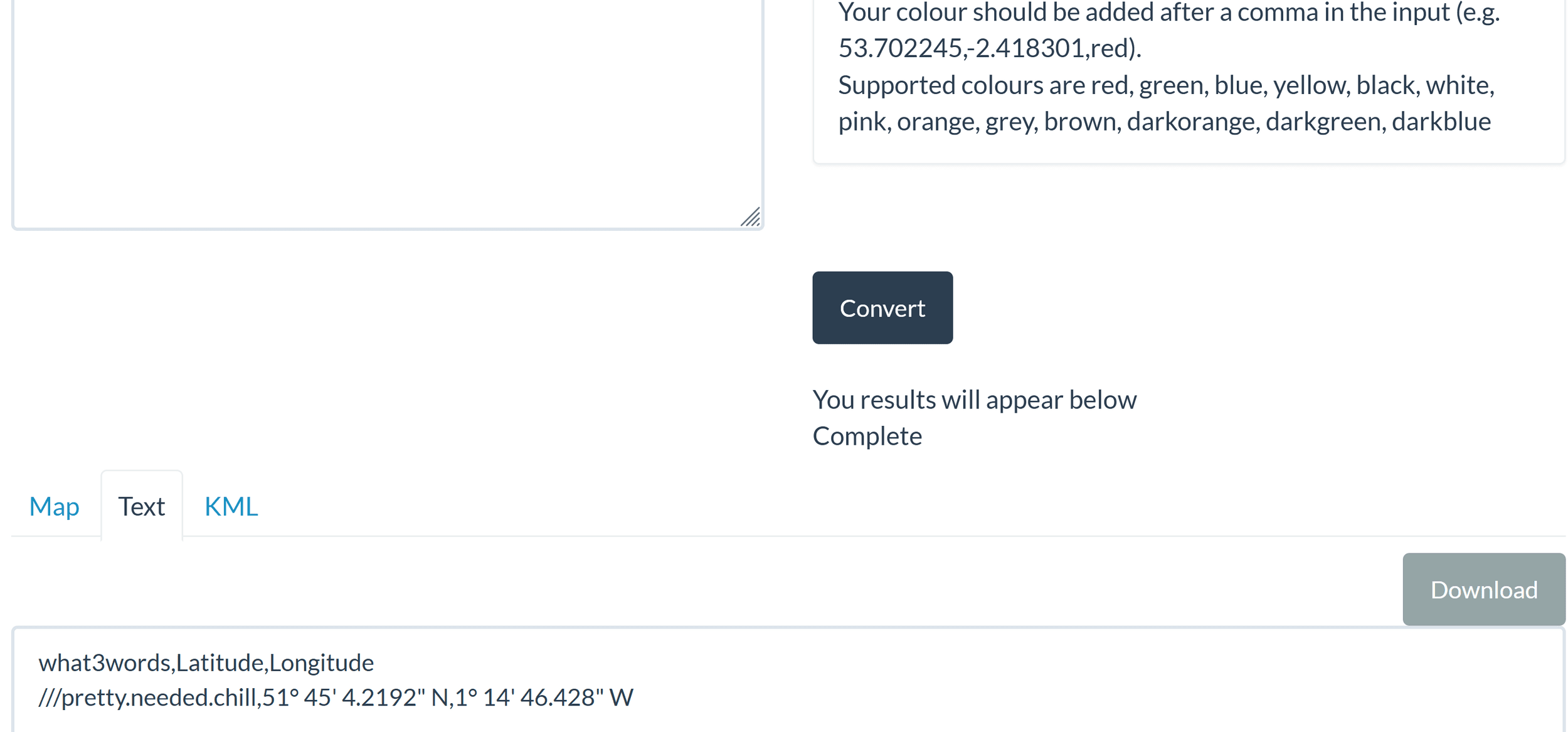

So 51.... dah de dah is your DMS for N and W
this 51° 45' 4.2192" N,1° 14' 46.428" W
that is what you dial in. It’s a bridge in Oxford.
You can do batch conversions with it... also suppose to be Excel sheet addins. My Excel is a bit long in the tooth so I didn't try that and you probably pay for that via Microsoft library.
For normal getting the DMS I use Android app N45E25 which takes either address, standard x,y coordinates and generates DMS. You get Google maps and Openstreet and Streetview although I might be keeping a disused app for the latter. Not sure. It works thou. N45E25 doesn't support importing what3words thou.
I can see if you had a lot of those what3words you could do it via Doogal. Club or something.
