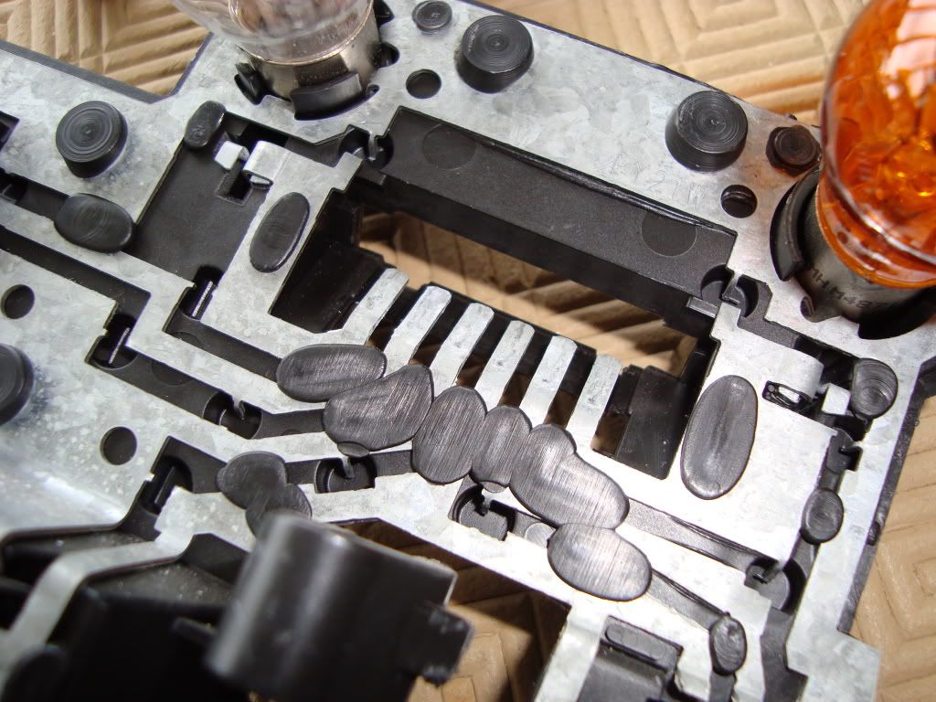

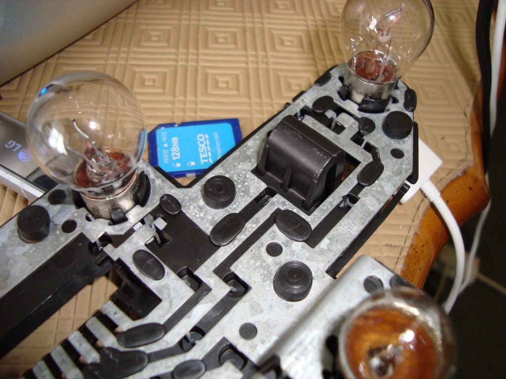

Flapper - I have taken out my light cluster board, and there's only one pin on the right side with the fogs. What do I do? Use the pin from the brake and swap them over? Cause I only need one fog light don't I?... What I was thinking was swapping the brakes for the foglight cluster either side, and using the brake / tail light cluster as a fog light one side... Will that work? :p
P.s I've worked out which pin the brake light in the double filament bulb one is.
A few pictures to go with what I'm saying;

to swap the brake to fog you need to swap the positive wiring pins over - earths are common
you only get a fog on one side anyway so you'll have to fit a bulb in on the ns one
to have 2 fogs (as they are slightly dimmer so adviseable) run a joined wire from drivers to passenger
