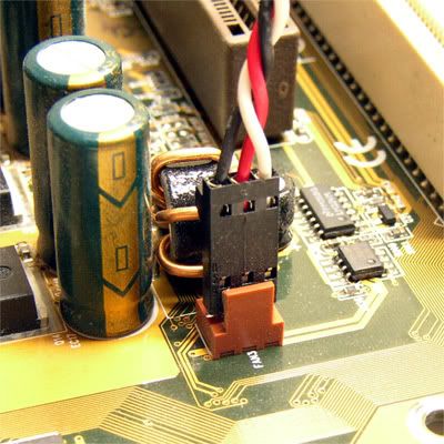

OK - they're REALLY not the same as PC connectors, being like this e.g;
How do I get these devils out in the light connectors!? :(
