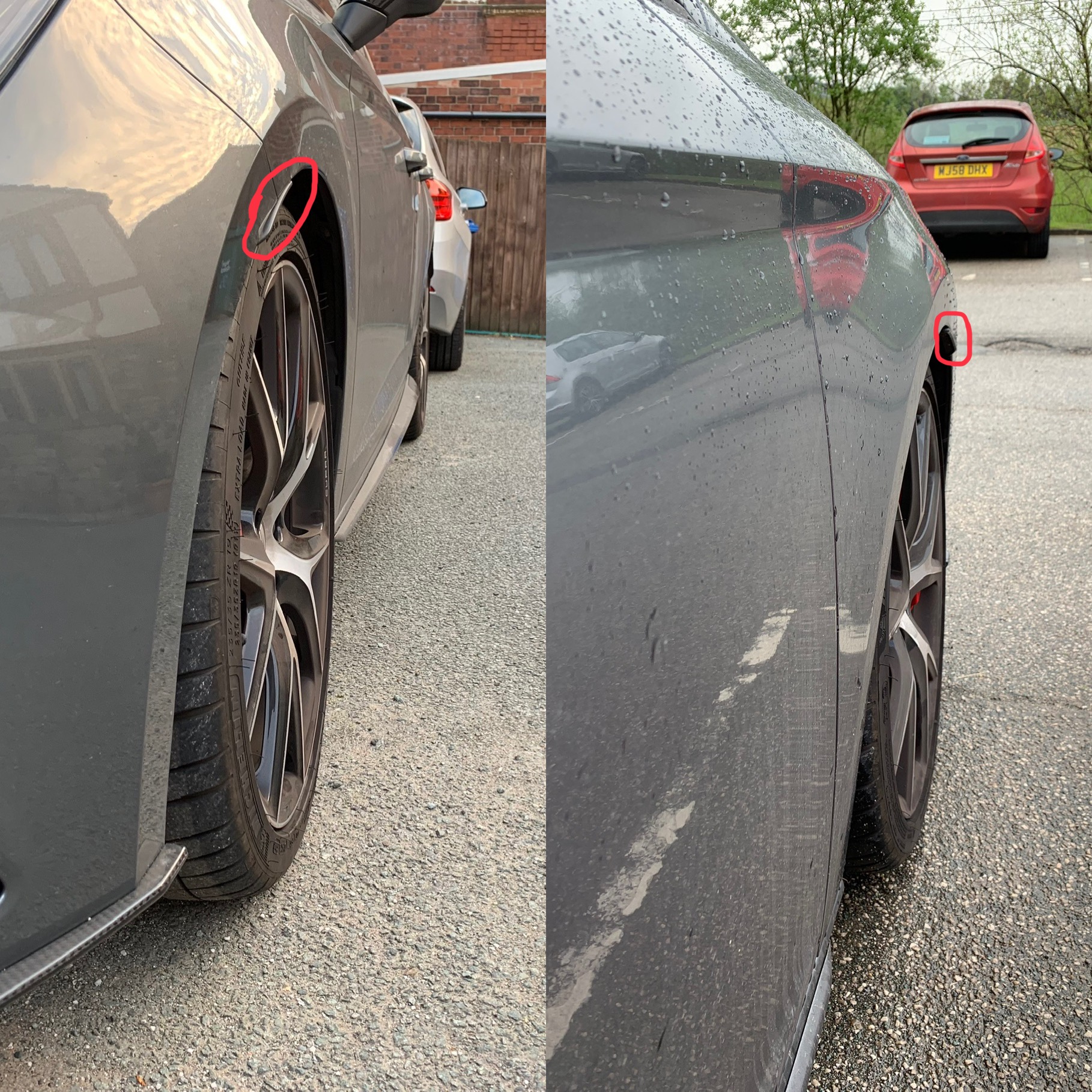

So after agonising what spacer size to order, measuring 3 different times and then still going for a conservative size based on my measurements, I’ve got a bit of rubbing on big bumps.
Rear is definitely the little plastic bits that are fitted, front I’m not as sure.
So how do you remove these, I had a quick look but it had gone dark. Are they screwed in, or is it just a clip.
Any help appreciated :)

Sorry definitely not the arch liner.
These things...
I took mine off a long time ago but I seem to recall they are held in place with screws but I only found that out after I cut them off.
However as its a nice sunny day today I am sure you will be able to have a look.
Reactions: Damo H
No Idea, I have seen comments they stop spray in the wet but cant say as I have noticed any difference since removing them.
what are they actually for exactly?
They’re fitted to many cars with wider wheels and tyres, to cover the exposed tread when viewed from above.
I think it’s a legal requirement that a car’s tyre tread isn’t exposed / can’t be seen when viewed from above, so to remove these where they’re fitted might be an MOT fail, especially if, like the OP, anyone is planning on fitting spacers that’ll push the wheels / tyres out further. I very much doubt that anyone who’d removed these would be prosecuted if they were stopped by the police though - would they even notice?
My VW Polo GTI has 7j wheels and it doesn’t have these little plastic lips on the rear wheel arches, but Polo GTI’s with 7.5j wheels do have them fitted as the edge of the tyre extends out further, which does suggest they’re fitted to cover exposed tyre tread when viewed from above.

15mm front, 10mm rear. Thought I was being conservative with my measurements.
Took the lip off of the front but it still rubs. It was rubbing on the little nodule in the arch liner that a screw sits under (one that connects bumper and metal arch panel and also hold that plastic lip thingy too). Didn’t want to try smooth it down so took the 10mm off of the rear and put it on the front. No more rubbing.
Shame really as looked perfect. Still looks good now (at the front) but rear has nothing at moment. Thinking 5mm at the rear to balance the look out.
Down side is the sets I bought had matching locking nuts front and rear (H&R), where as the shorter bolts and spacers for 5mm at the rear may not match. Got to try and explain to a German supplier if they can source me the same locking nuts to fit 5mm.
Either that or gamble that the 15mm longer bolts will be ok with the 10mm spacers and the 10mm longer bolts ok with 5mm spacers.

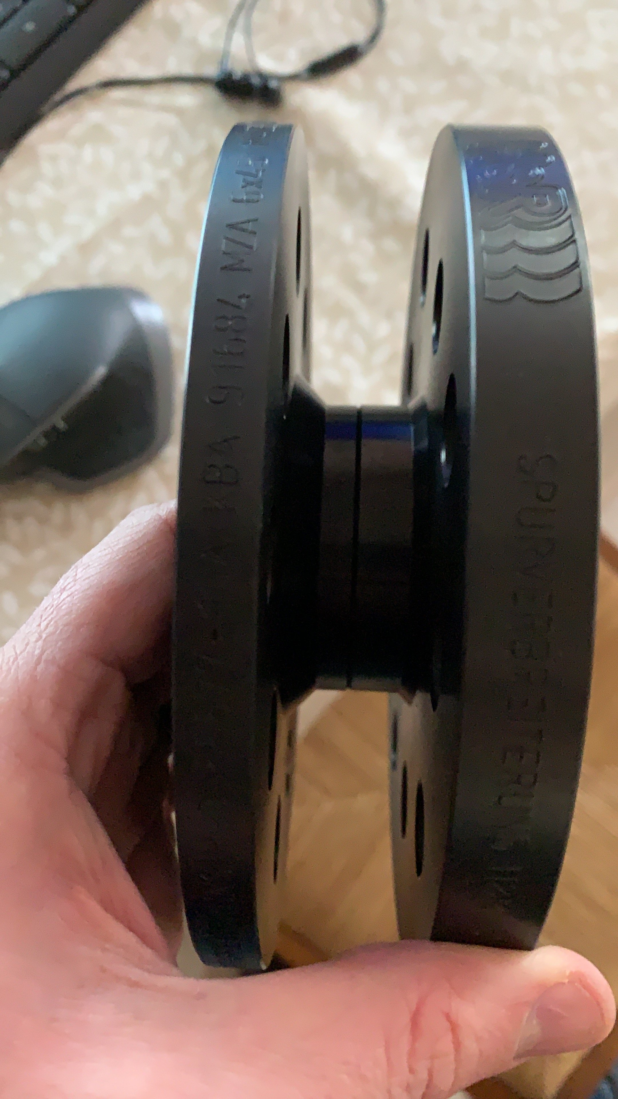

Well according to H&R for me they only do 10mm and 3mm to fit the rear axle of a 4 drive. Their 8mm is for front only. In fact the 10mm I ordered where specific to fit the rear axle of the 4drive. If you look at this pic you can see the difference between the 15mm any axle, and the 10mm any axle...

No I 100% understood what you meant.
I’m just saying my plan before your suggestion, was to look at 5mm rear. But sadly H&R only do 3 or 10 for the rear of mine.
My 10mm that are on the front now can fit both axles. But not all H&R 10mm fit the rear.
