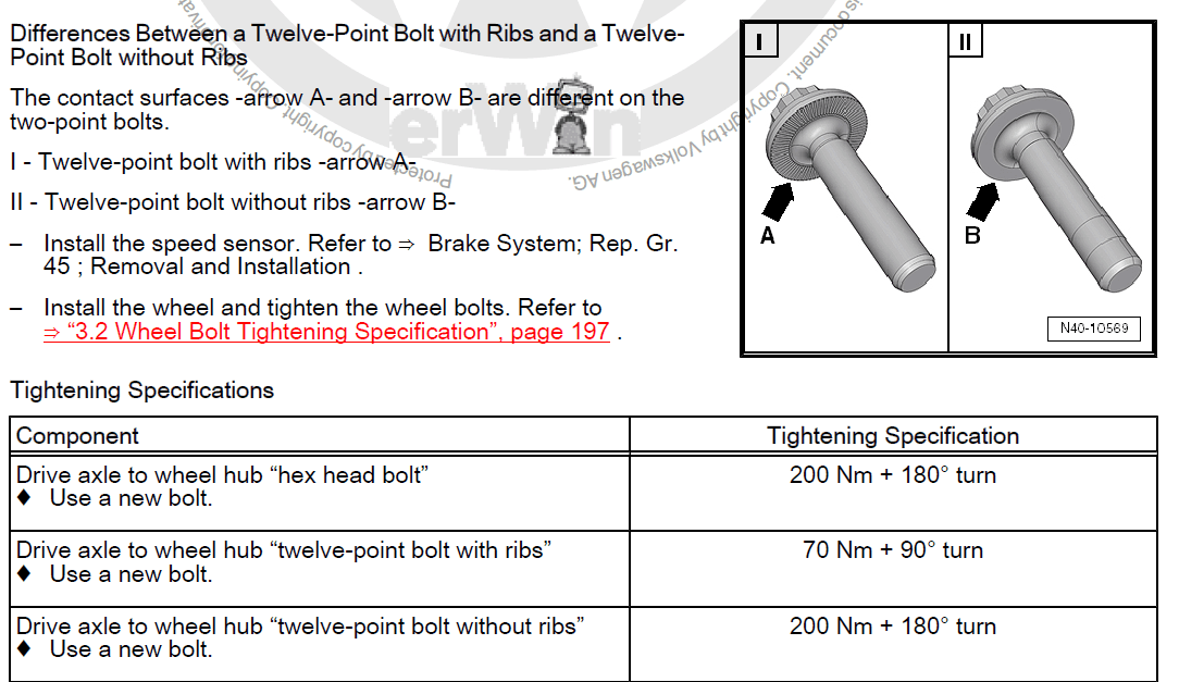

The bolts with the ribbed / serrated clamping face are 70Nm + 90°
200Nm + 180° is for the bolts without the serrated clamping face
The three triple square bolts (M12 XZN) holding the bearing carrier are 70Nm + 90degs. These have conical/smooth seats. These were fine.
The single large drive shaft bolt has the 200+180deg spec which I struggled with. The bolt which came out had a smooth clamping face - the bolt which came with my bearings had a serrated face.
Or are you saying there is two torque specs for the large drive shaft bolt depending on the clamping face?
Correct.
In addition to the serrated clamping face they are different tensile strengths and therefore have different torque specs. The serrated ones are 10.9 and the non-serrated ones are 8.8

Can you share you source? The Seat manual I have doesn't mention the 70Nm + 90deg.

It's covered in the service manuals for the PQ35 cars... Mk5 / 6 Golf, Mk2 Leon, etc.. as there were a total of 3 different bolt versions used during production for those cars.
I don’t know if Seat actually ever used the serrated version on the Mk3 Leon themselves or if they only used the non-serrated one. It does seem looking at part number supersessions that VAG did fully move over to the non-serrated ones at some point. The same non-serrated bolt is now listed for the Mk2 and Mk3 Leons, and equivalent models from other brands.
Since all the VAG service manuals are written for use in their own workshops where the ETKA listed spare parts will be used there would be no reason to mention the serrated ones in the service manual if they were never used on the Mk3 Leon.
