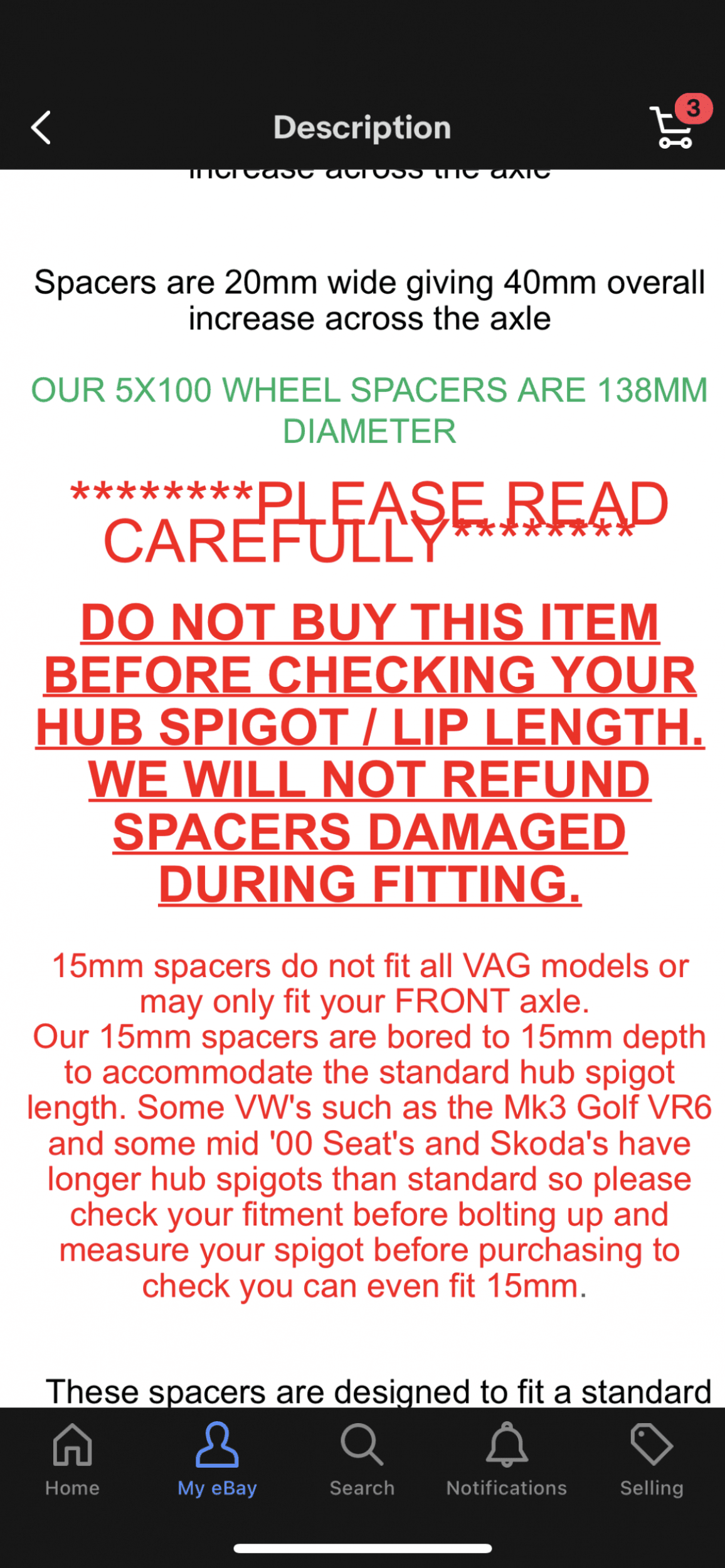

I think it was the depth of the hubcentric part of the spacer that was the issue, but that measurement isn’t advertised when buying spacers is it?
Apr 16, 2020
18
Think that was my issue, the ones I bought never said anything about that but I’ve got a full refund anyways. I guess I’ll just have to shop around until I find a set that works🤷🏻‍♂️
