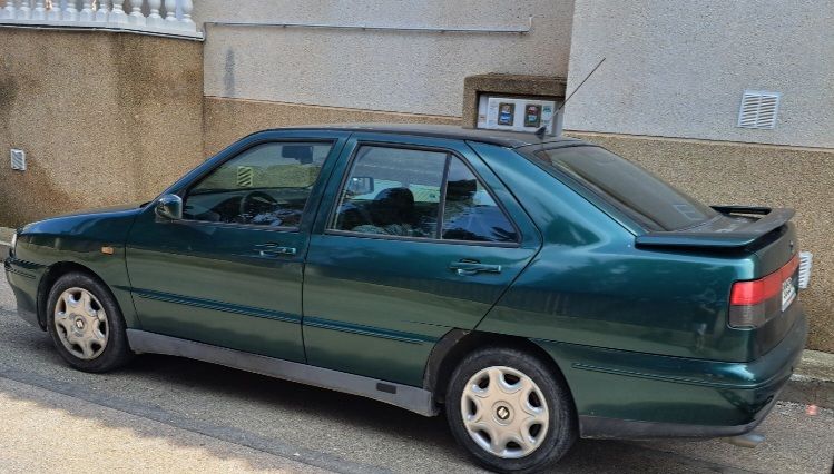

Good afternoon from sunny Torrevieja. I have a 1998 Seat Toledo Mk1 petrol. I am trying to locate the cooling fan controller
At the moment the low speed fan comes on when engine gets hot but does not speed up cooling fan as it gets hotter. I have changed thermo switch and confirm fan works on high and low speed when it's shorted between terminals so figure it has to be controller but I can't find it anywhere!
