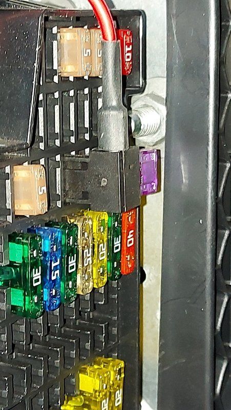

I am trying to put in a hardwire kit for a dashcam The manual is worse than useless as it has no diagram of the fuse box, and all the online diagrams are for lrft hand drive cars with a quite different arrangement. My fuse box is like the one shown here https://www.seatcupra.net/forums/threads/dash-cam-hardwire-facelift-leon.462887/
I don't want to piiyback onto anything vital for safety or the running of the car like engine management or ABS. Does anyone have a diagram for this fusebox on the right side of the dash?

I tried piggy backing as shown, but this proved to be a permanent live when I want ignition only power.

I have no problem working safely with a multimeter and have in fact now found and used a vacant fuse slot that is ignition only. The diagrams in the link above are all wrong for my car. If you scroll nearly to the bottom there is a diagram for 2009-2012 cars, but the instrument panel diagram may be OK for left hand drive cars with a fuse box on the left, but bears little relation to the fuse box at the right hand end of the dash on my car. It would have helped a lot if SEAT had printed a fuse diagram and stuck it inside the plastic panel that you have to prize off to get at the fuses. As it stands I have no idea what any of the fuses in there are for, so if something were to fail I would just have to pull fuses one by one until I found the one that had failed.

I did not take a photo but of it, but if you look at the photo above you will see a row of full size fuses. The whole row appear to be powered with the ignition on but not otherwise. I used the vacant slot next to the 30A fuse at the left of the row.
