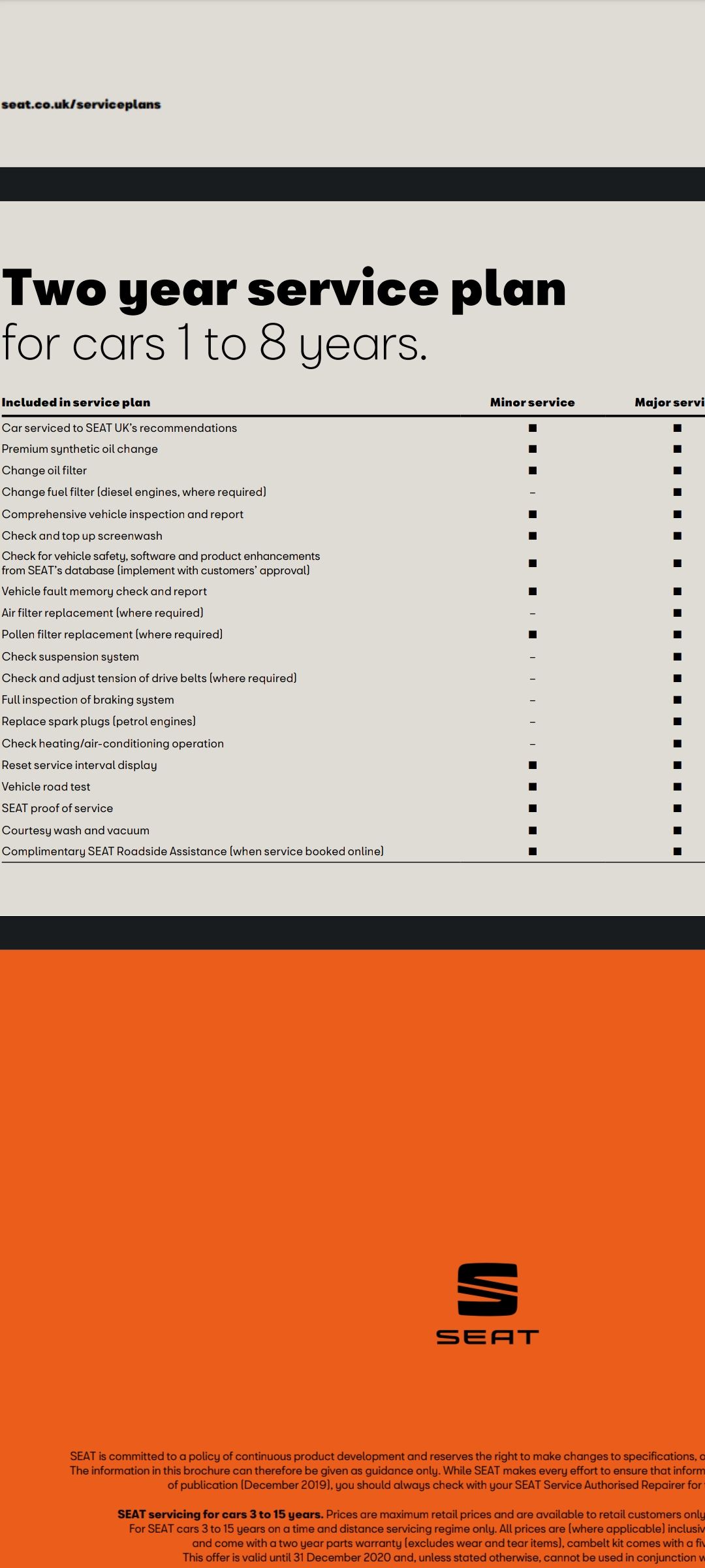

It depends on what services he's been offered, I suspect that it would be a minor service AND a major service.
Seats major service doesnt include dsg, coolant, brake fluid, haldex etc its very basic. But if youve got any advice to offer the pauly go ahead. ?
I wouldn't say that it's 'very basic', so if you go to an indy and ask for a major service would you definitely get all those extra things done?

Thanks for the replies. There's a prep invoice for £450 from the supplying dealer, that includes the Haldex oil and brake fluid change 5k miles ago. If the major service doesn't include the DSG oil, I'll have that done by a specialist. Ultimately the services are free oil changes, and an entry in the service history. Plus a check over to see if any warranty work is required. I think there may be a video to highlight what has been done too? I'll probably give the test drive and wash a miss though.
