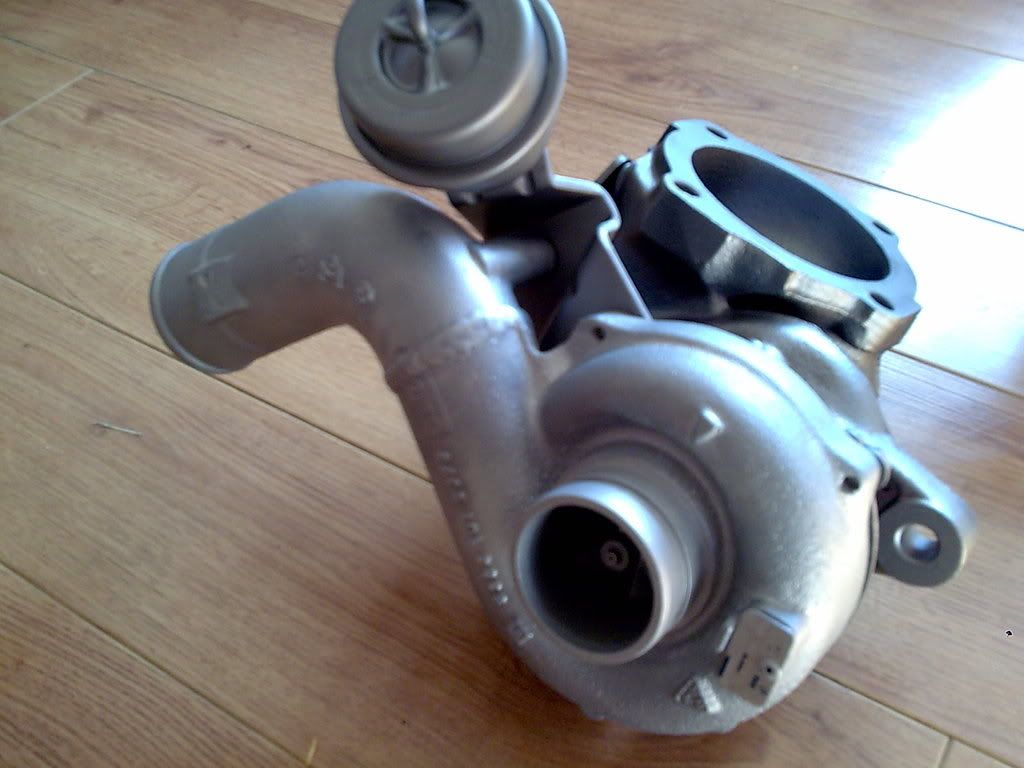

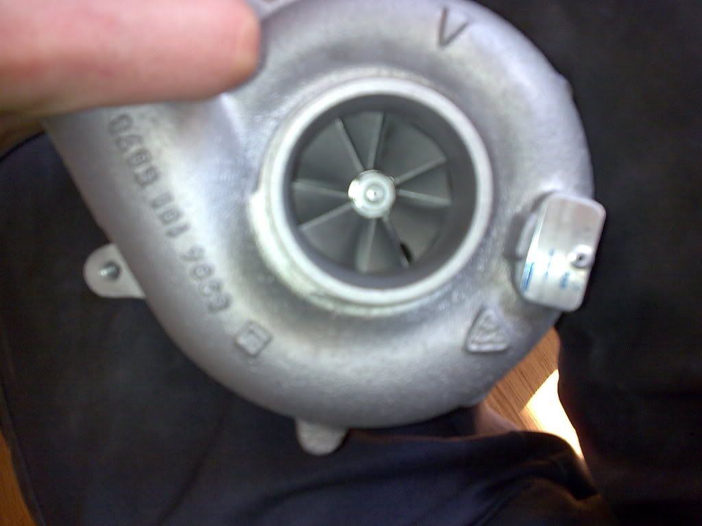

you can take a ko3 or ko3s they just keep the exhaust part and put on a ko4 housing with turbine blades from rs6 turbo. manner on here got 276hp with hybrid turbo you can use lcr tip here you can see the hybrid turbo

was made by CR Turbos. cost i think £590, and thats witth all the delivery charges as they pick up and drop off the turbo from your house,

you need 225 injectors and maf 4bar fuel pressure reg! and a new map. and to get the best out of it fmic tip full exhaust system and the rest
