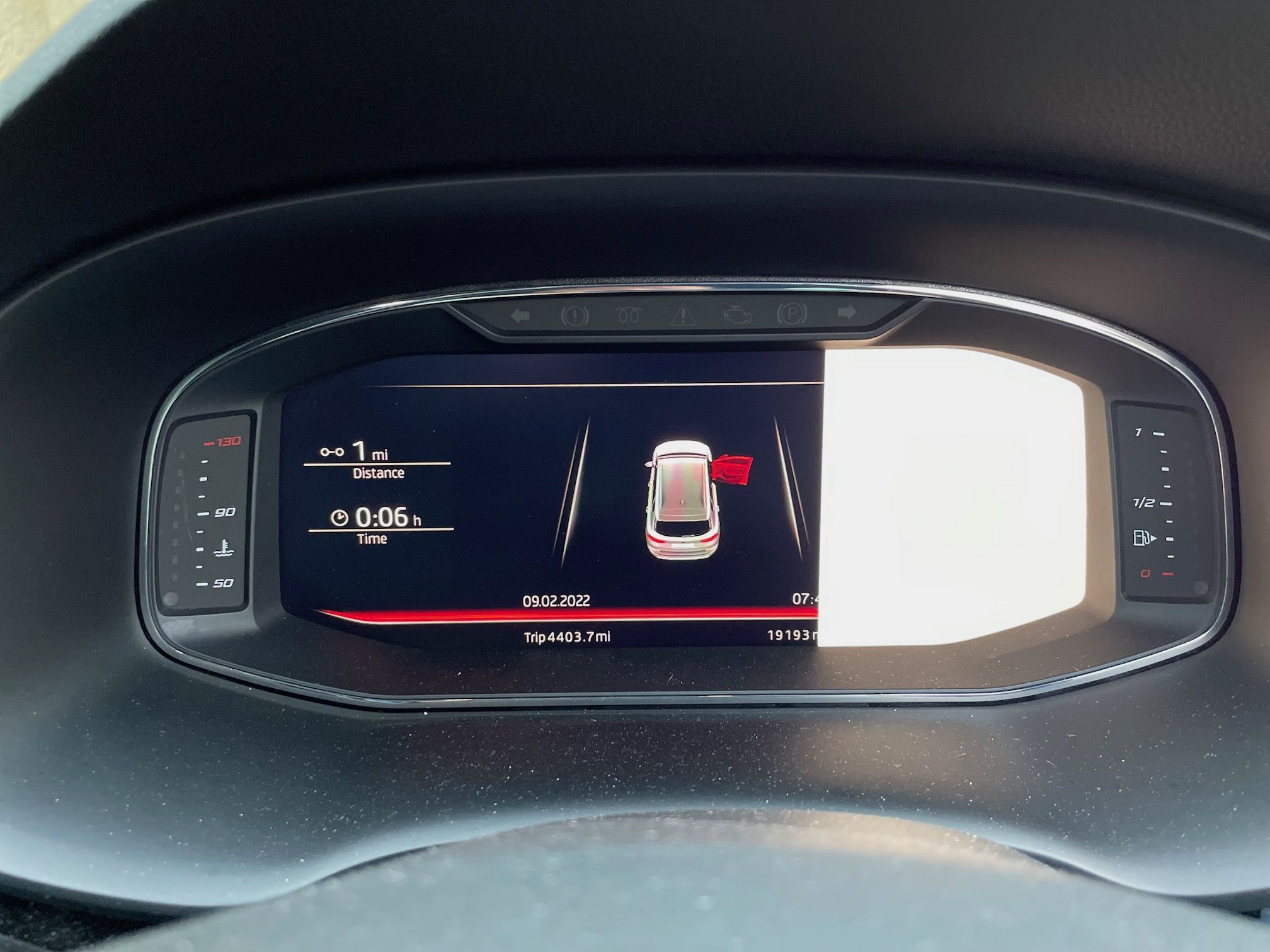

Hi - anyone know of the fault or cure for this problem: the right hand side of the digital cockpit is obscured by a white box. Annoying/alarmingly, it's covering the entire speedo making it unsafe to drive. Anyone else seen this?
Thanks
Well I can only suggest you do a reboot of the infotainment system. Long press on the power button till you see the logo screen come up again. 10 seconds or so... keep holding till you get the reboot. This may fix it other than it's a trip to your dealer. Reboot corrects any wayward programs in the unit if it was that. The unit in the glove box drives the screen display plus the virtual cockpit.
Thanks for the suggestion. Went back to the car a few hours later and the problem had mysteriously fixed itself. Will try the reboot of the infotainment system if it happens again though. Cheers
