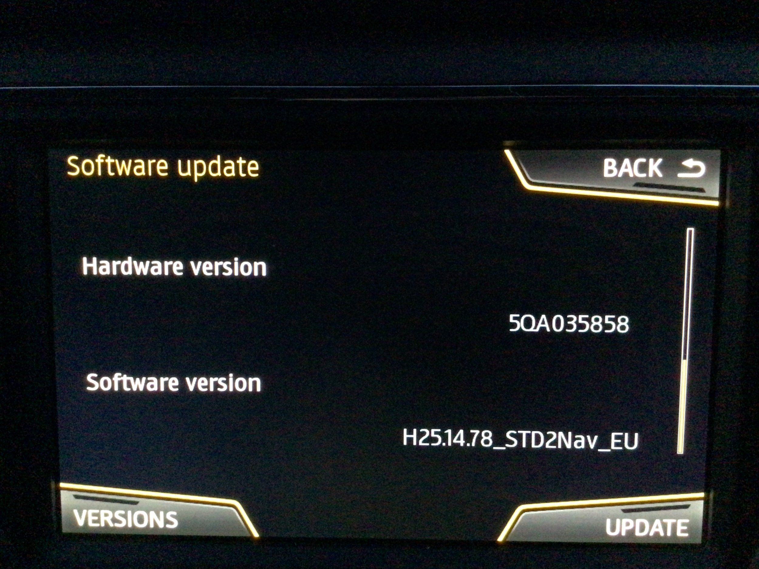

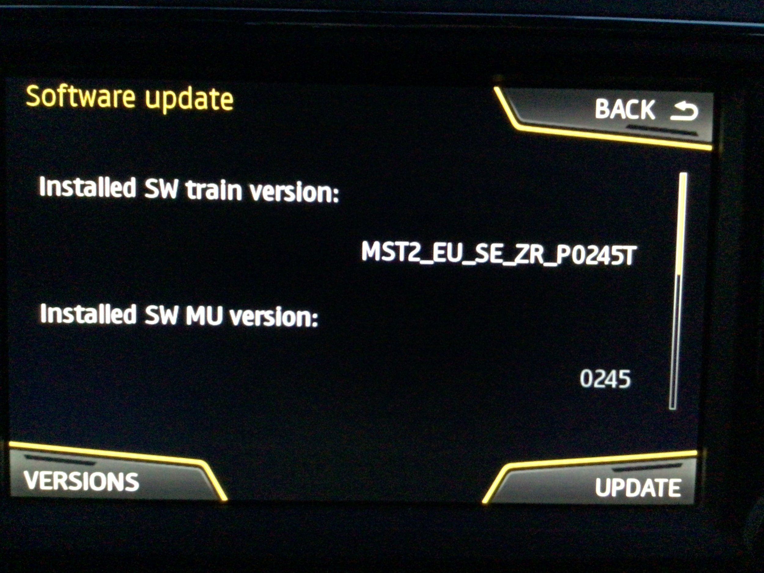

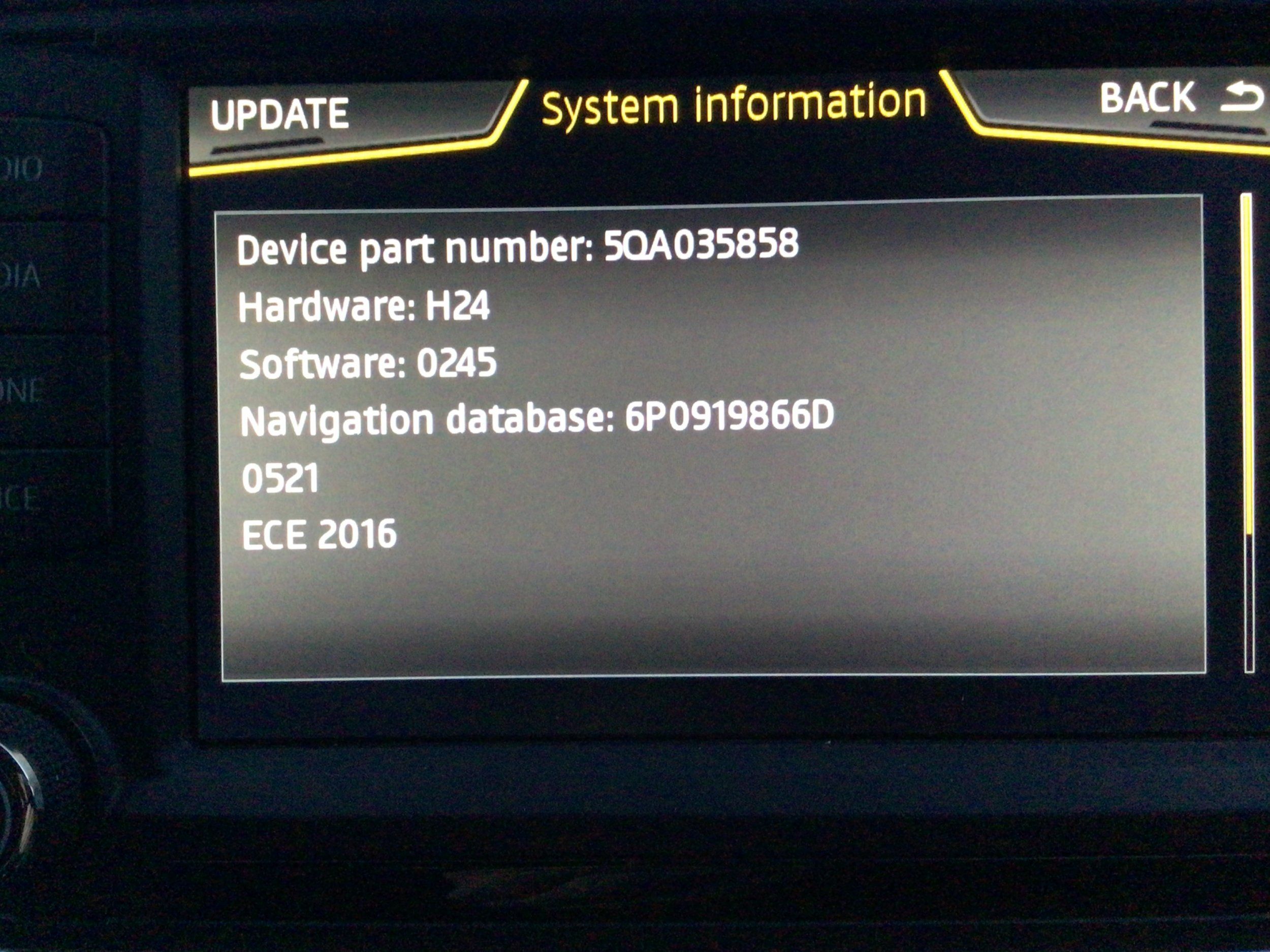

Have you got a pic of your screen? If not, grab one with the screen showing the device part number and software version info
Press MENU, press the top right SETUP/SETTINGS option, scroll down to the bottom and press SYSTEM INFORMATION and there should be a software version number along the lines of "MST2_EU_SE_XXXXX" and a part number like "5F0 XXX XXX X or 5QA XXX XXX X" or alike
At least that way we will know what we're dealing with, otherwise it's just shooting blind with advice.

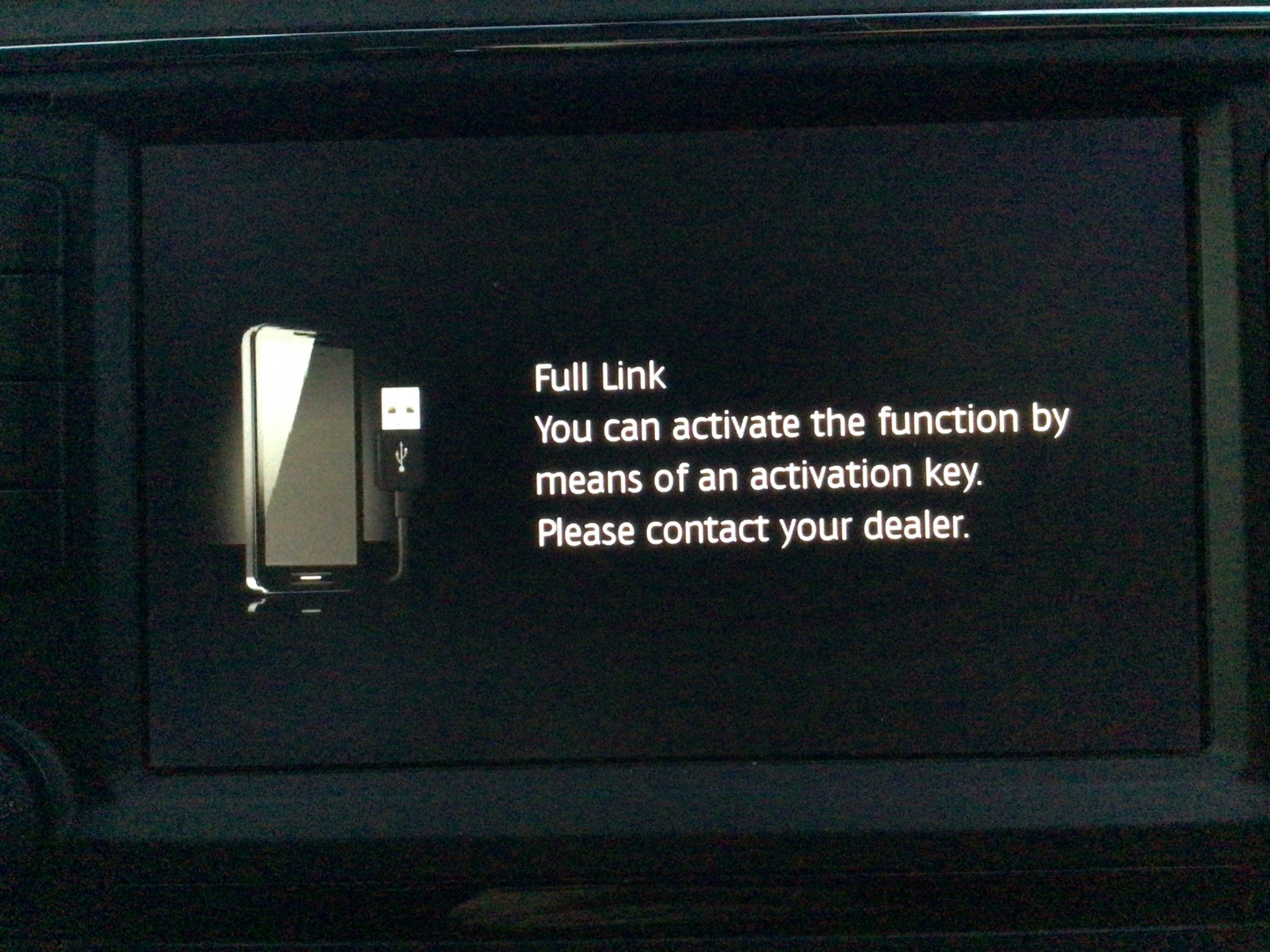

Also, has it got an option for FULL LINK in the menu screen?

Does this information help?
So it does have Full Link, it just needs to be activated. Probable that you have the right USB port but I'd get it checked to be sure.
