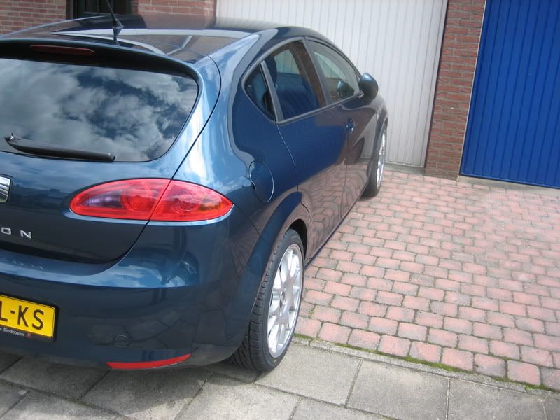

mine are 9mm more outside against standard 18" rims (7,5x18" et 51), guess another 6mm (15mm totally) would by fine. Whatever over 15mm may causes problems, especialy if your car is lowered.
Ps. pic is before lowering
