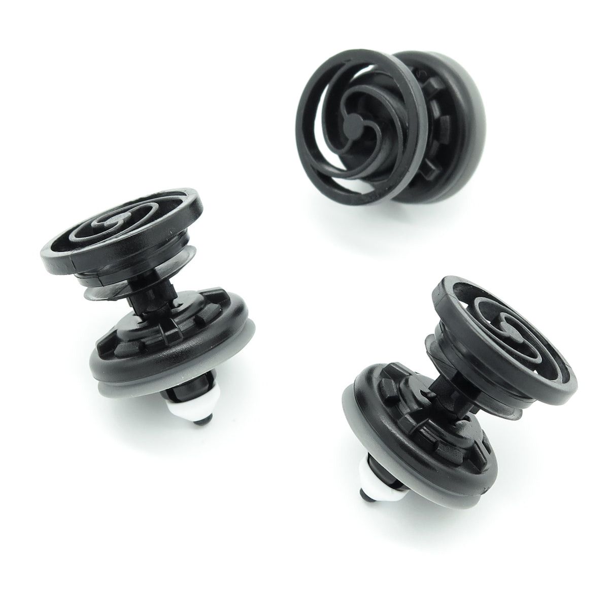

I would make sure you have fresh door clips - some of them will break when removing the door card.
Job is much easier with two people - one to hold the glass whilst the other has his/her hands inside the door detaching and attaching things.
Got new clips from here - way cheaper than from Seat
