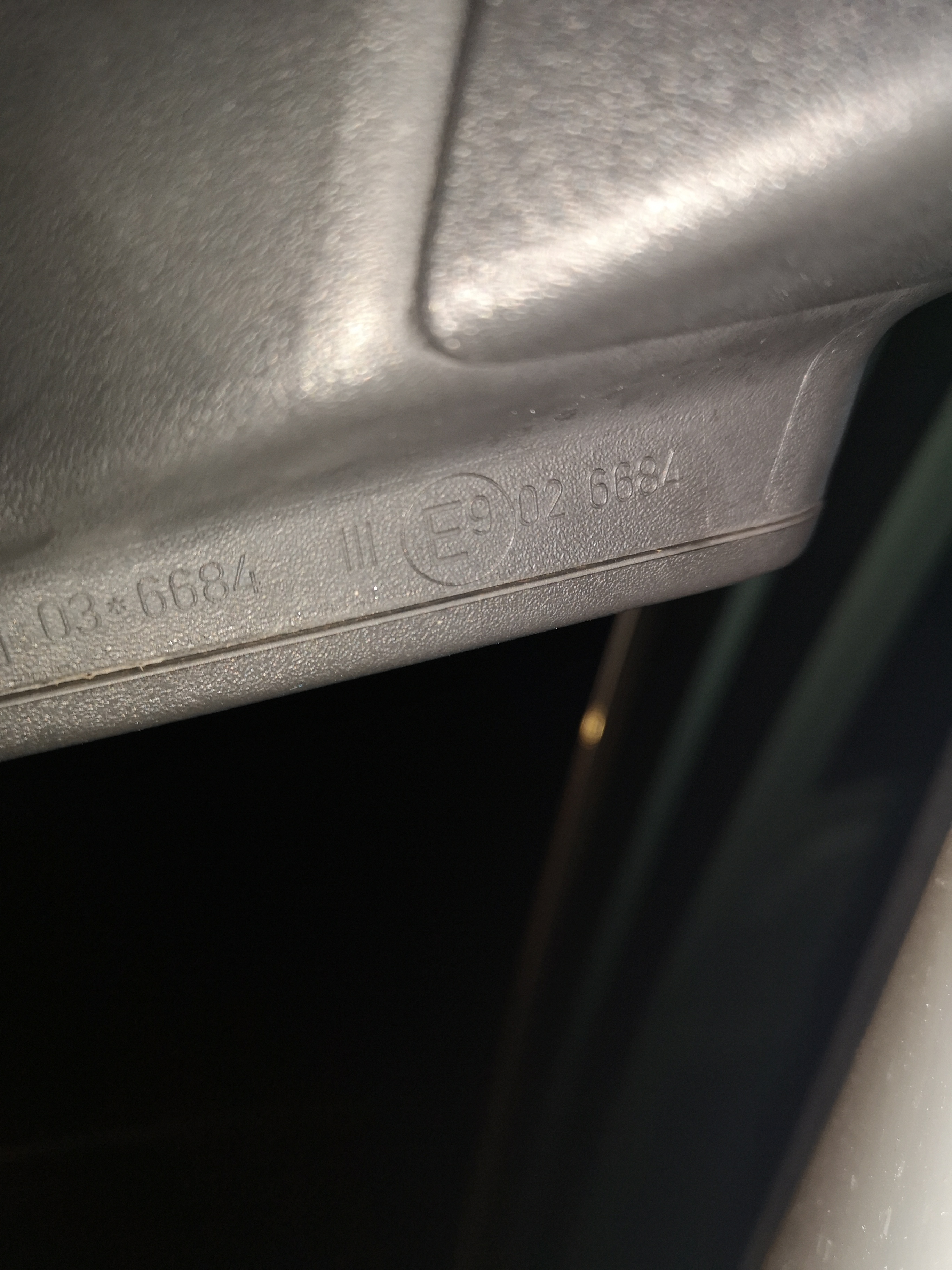

Original wing mirror seems to be
036684, but then it says 026684 aswell?
Can anyone look at the pic and tell me what number is the part number?

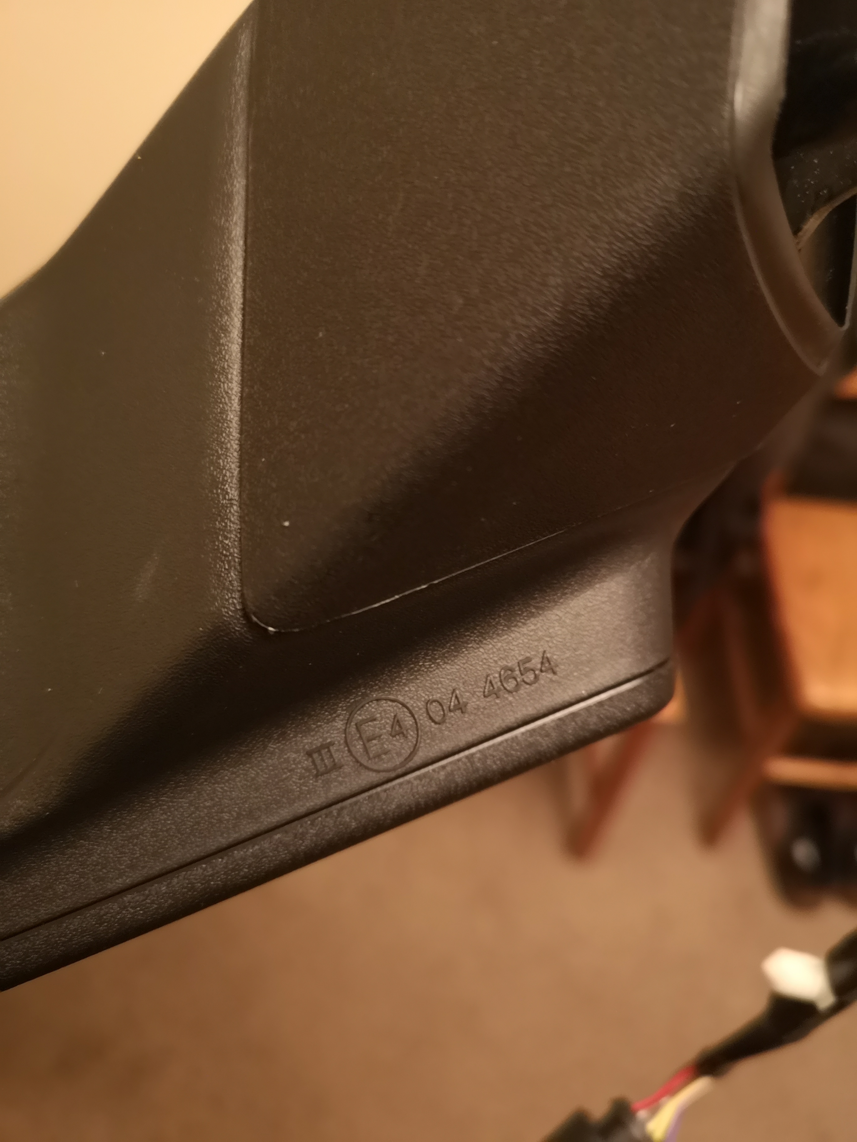

Replacement wing mirror seems to be
044654

The original mirror should have a part number prefixed by 5F. what you have shown there is the Type Approval mark.
Where did you get your replacement from: is it a genuine part or aftermarket?
