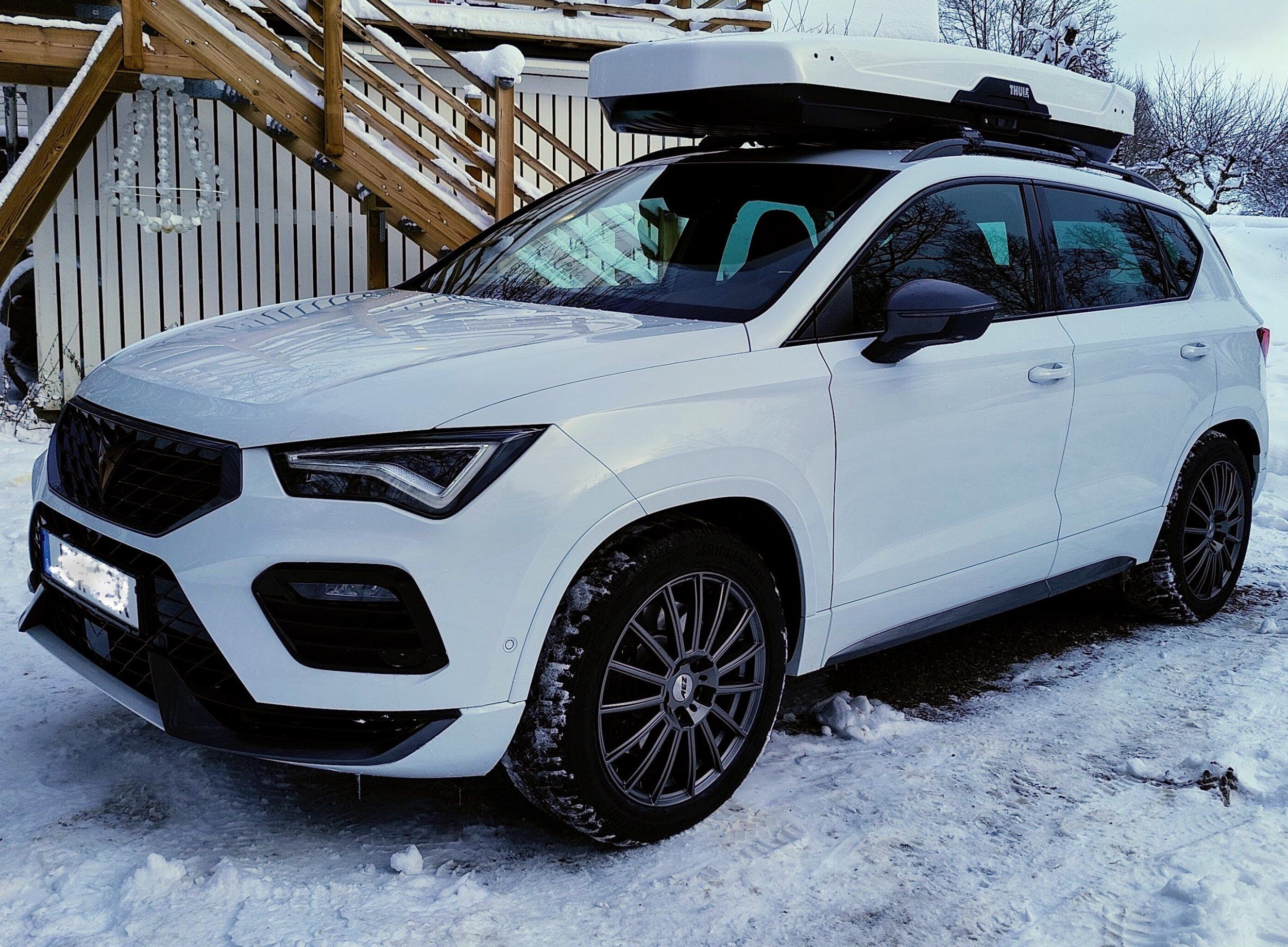

I installed 18" AEZ Steam (https://www.tyreleader.ie/alloy-wheels-brands/aez/steam-3660/) winter alloys with Bridgestone Blizzak LM005 235/50 R18 101V XL.
The fitter set the pressures, I'm going to check them this week and set accordingly. Having just driven 1500km in snow, hardpack snow roads, ice, rain and tarmac, between -10c and +1c they are very good winter tyres.
