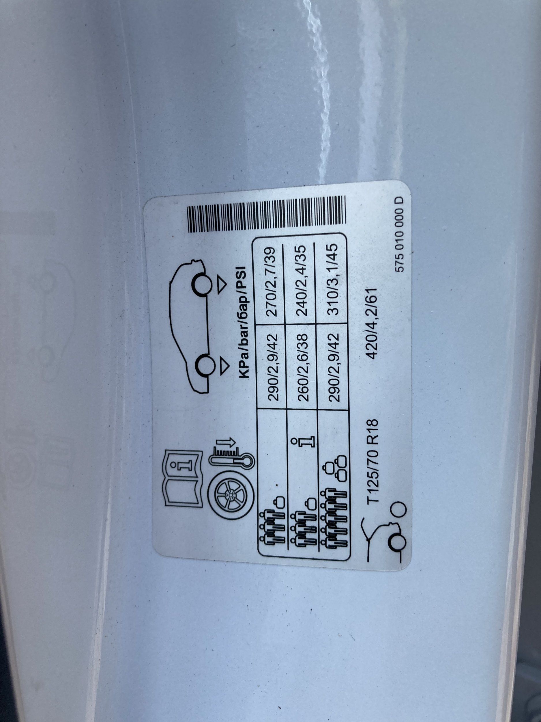

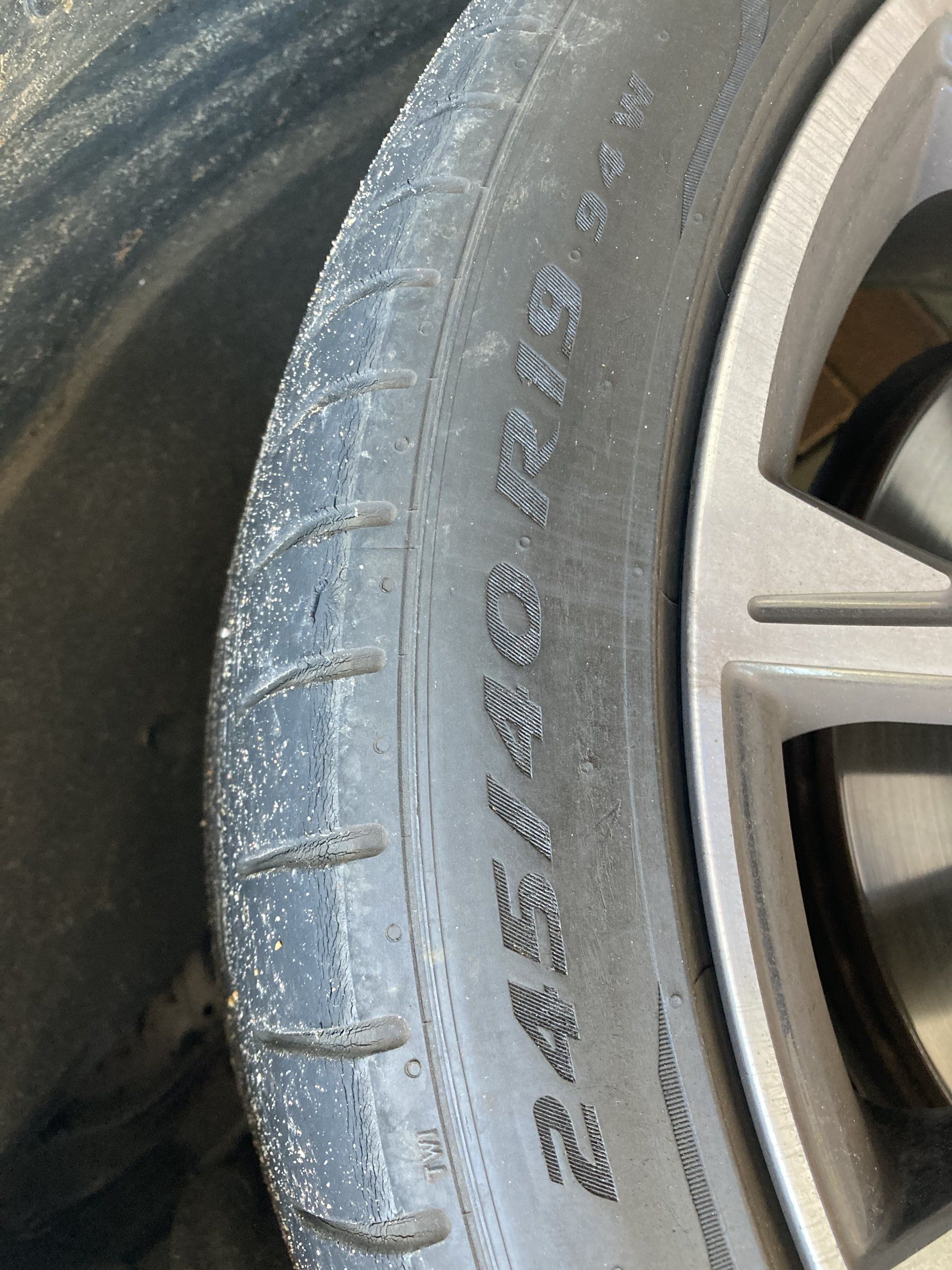

I have a standard 2019 Cupra Ateca 2.0 Tsi 4 drive, but mine has 245/40/19 tyres. So I can’t help I’m afraid, but for what it’s worth I have attached the door label tyre pressure for mine.

Well, thank you, and that’s interesting - the pressures you have are identical to those stated on mine for the 245/35/20 tyres! And not at all like the ones I’ve been able to find online. I wish I understood the hyroglyph about lower temps though, and the use of the ’i’ symbol. Ah, apparently the ‘i’ pressure figures (for medium load) can be used ”to increase driving comfort” at the expense of increased consumption, so that’s one mystery solved. And further reading of the manual (who knew? ?) reveals the thermometer symbol is nothing to do with winter pressures, it just means check pressures when the tyres are cold. So, really, tyre pressures don’t seem to be that critical, so I’ll probably go with the comfort pressures and see how it feels.

The best answer I am able to offer, from the door pillar label of my Cupra Ateca, is F 2.9bar R 2.7bar for the standard 245/40 19 tyres; with the subsequent caveat of the recommended +0.1 bar for Winter tyres.
