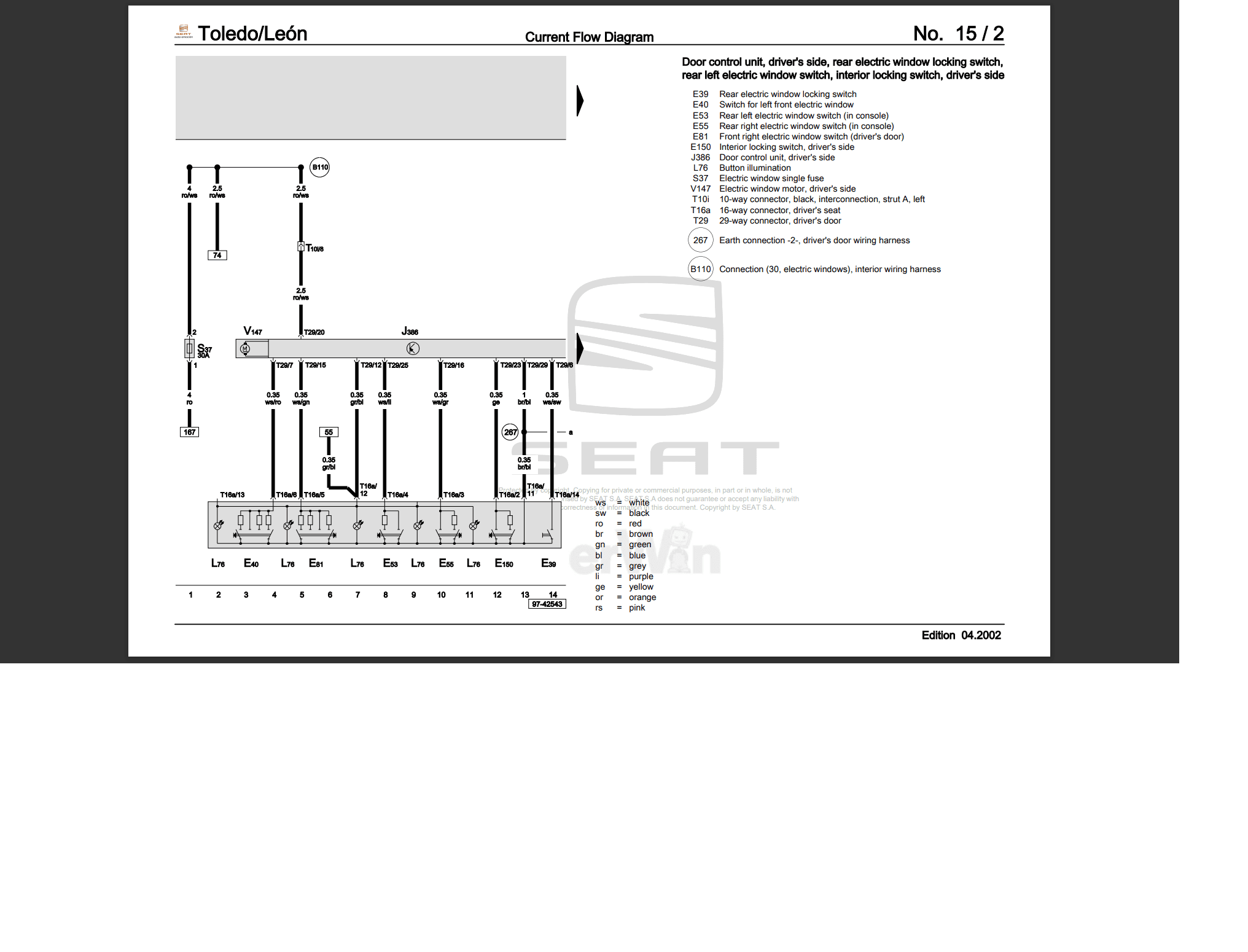

Hi everyone, like most wiring is a huge weakness but hopefully 1 of you will put me right, I just need to know what color the positive and earth is to each door window switch( i assume they all the same at each door) or can I tap into the door speakers they will have 12 volts running to them. It's just to power a led light. Would rather do it my self as I like to try and learn. Thanks for your help guys, I know this may be simple but wires and me don't get along lol.

Hi mate. Door speakers don't have 12v. If you're going to tap into something then the wire coming into the door which is red with a white stripe is 12V
Hi mate. Door speakers don't have 12v. If you're going to tap into something then the wire coming into the door which is red with a white stripe is 12VView attachment 45705
Thanks bud, had a look for something like above but no joy so thanks for that, but if I end up tapping into the red/white wire I assume it's ignition feed and solid brown will be earth. Sorry for sounding dumb just don't like wires but as said wanna try and do bits my self. Much appreciated
No worries mate, wiring diagrams can be confusing. I'm not 100% sure if it's switched igntion or live at all times, i think it's switched but best just check with a multimeter to confirm. Most of the earths are brown or brown with a blue stripe, usually a thicker wire as well.
