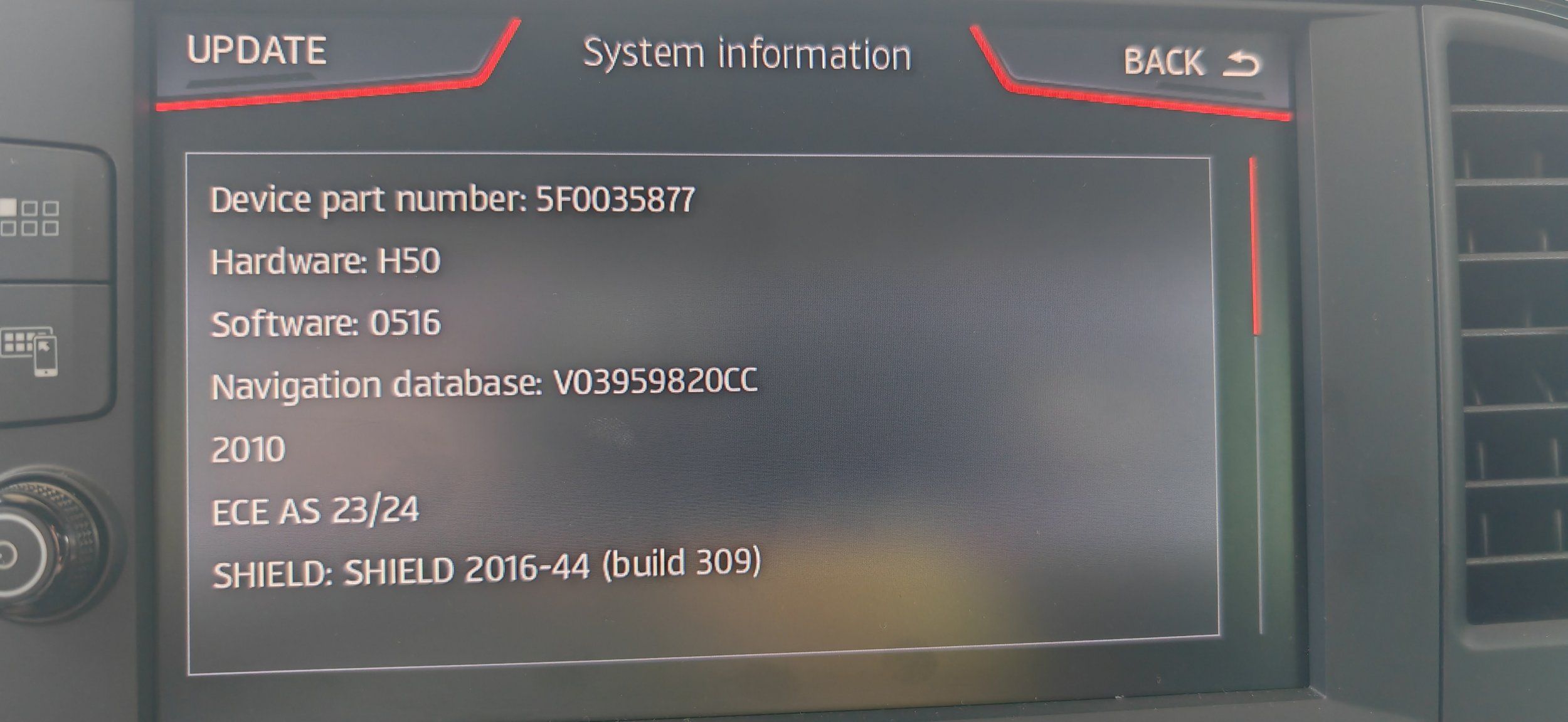

Hi, I bought 2019 Seat Leon Cupra (290 GPF) and was wondering if I can do anything to make the wireless android auto to work.
It works with the USB cable, also already has the full link option included (previous owner said he bought it).
Is there any software upgrade needed or any other trick to make it work?
Hardware: H50
Software: 0516
Any help appreciated, thanks.

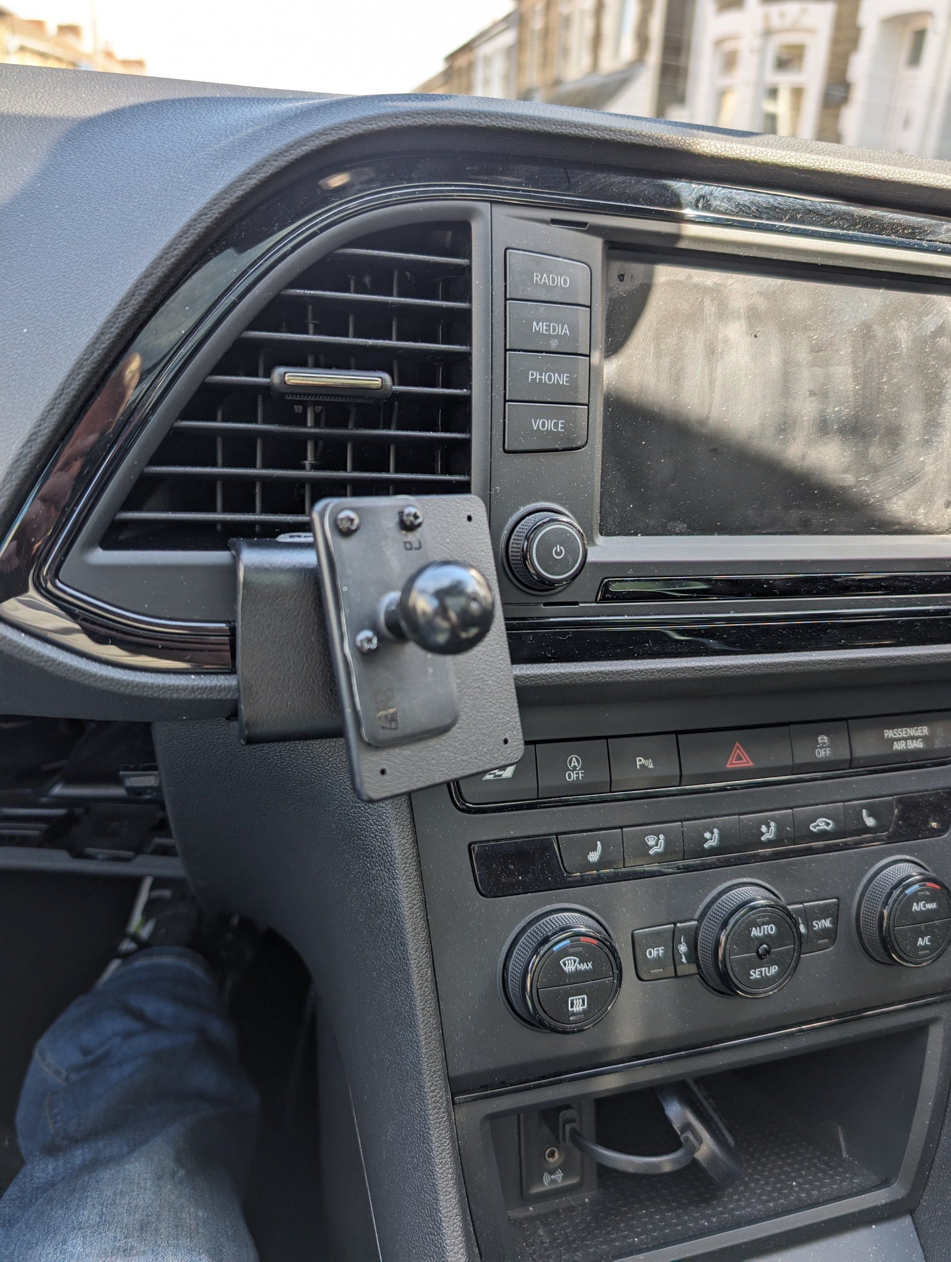

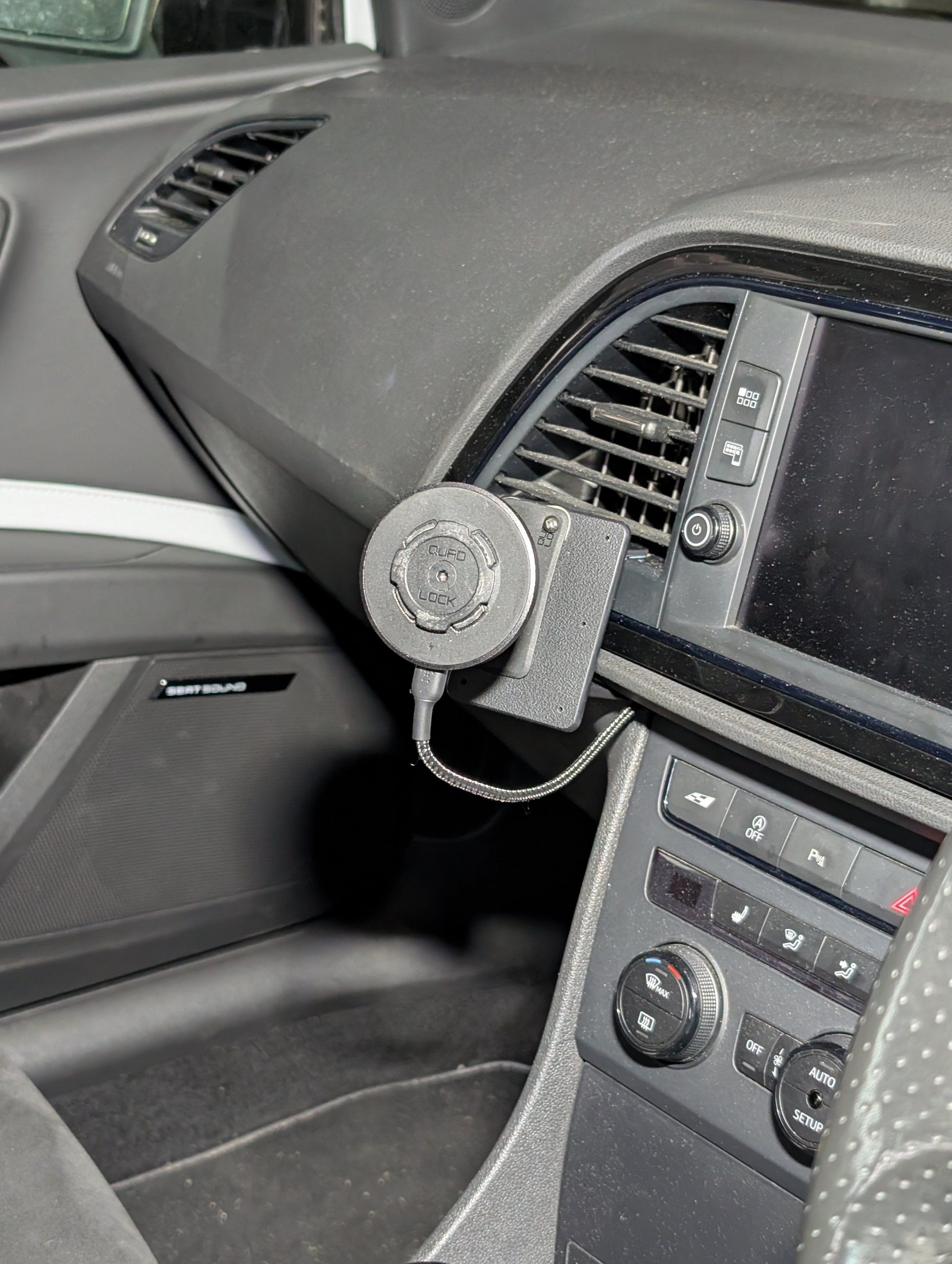

It's all very well having AA/Carplay wireless connectivity, but it doesn't charge your phone if you want to keep it in your pocket!
So for me the wireless device allows me to not have wires all over my dash or centre console, which I hate with a passion.
So I found a company that makes excellent phone holders that also charge your phone wirelessly and aren't a faff to put the phone onto!
Had this in my Transporter and moved it to the car, this set up works flawlessly and keeps the phone high for better signal reception.

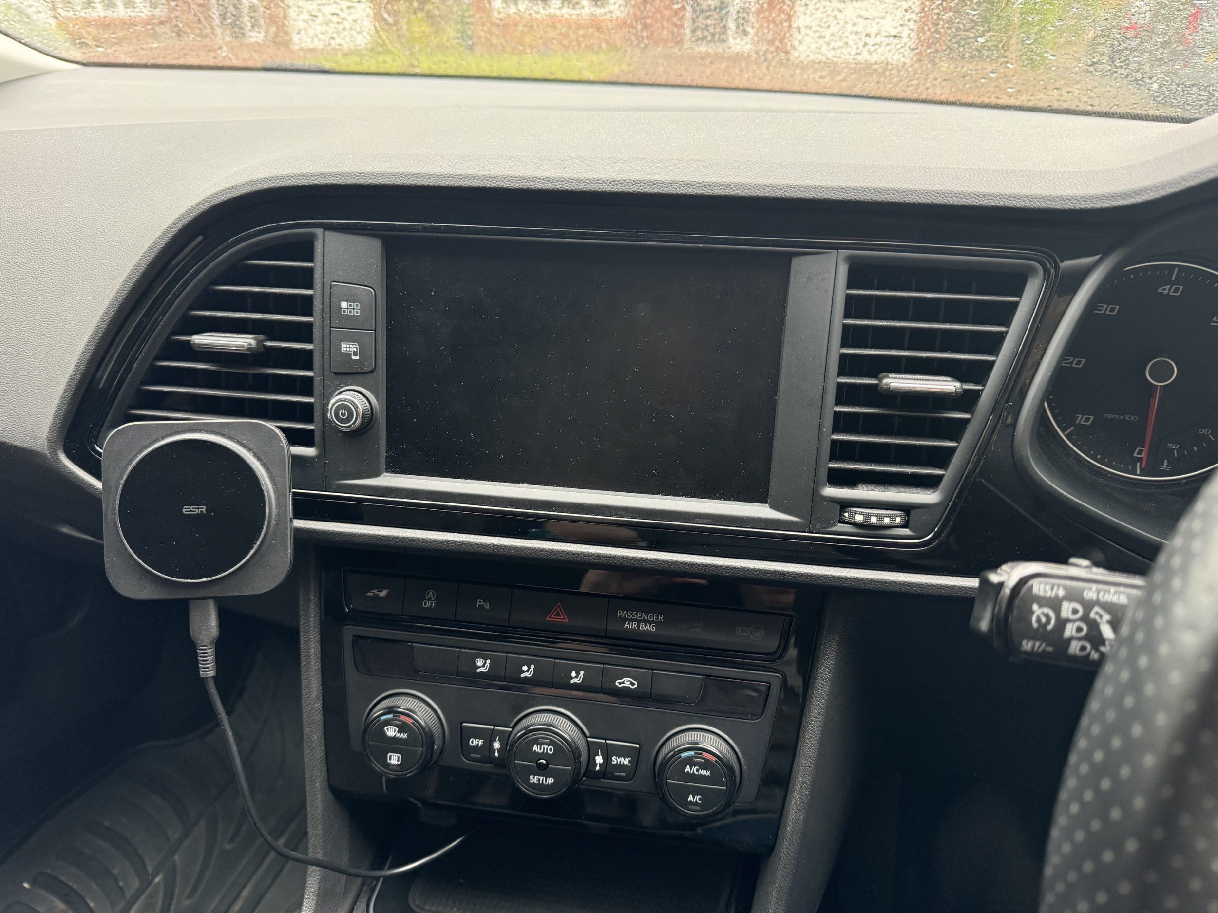

TripleBob
May 3, 2021
364
264
That’s exactly what I did! Brodit mount in exactly the same place yours is, and then I dismantled a MagSafe wireless charger and attached it to the mount so it sits flush (I’ve since routed the wire so you can’t see it)
