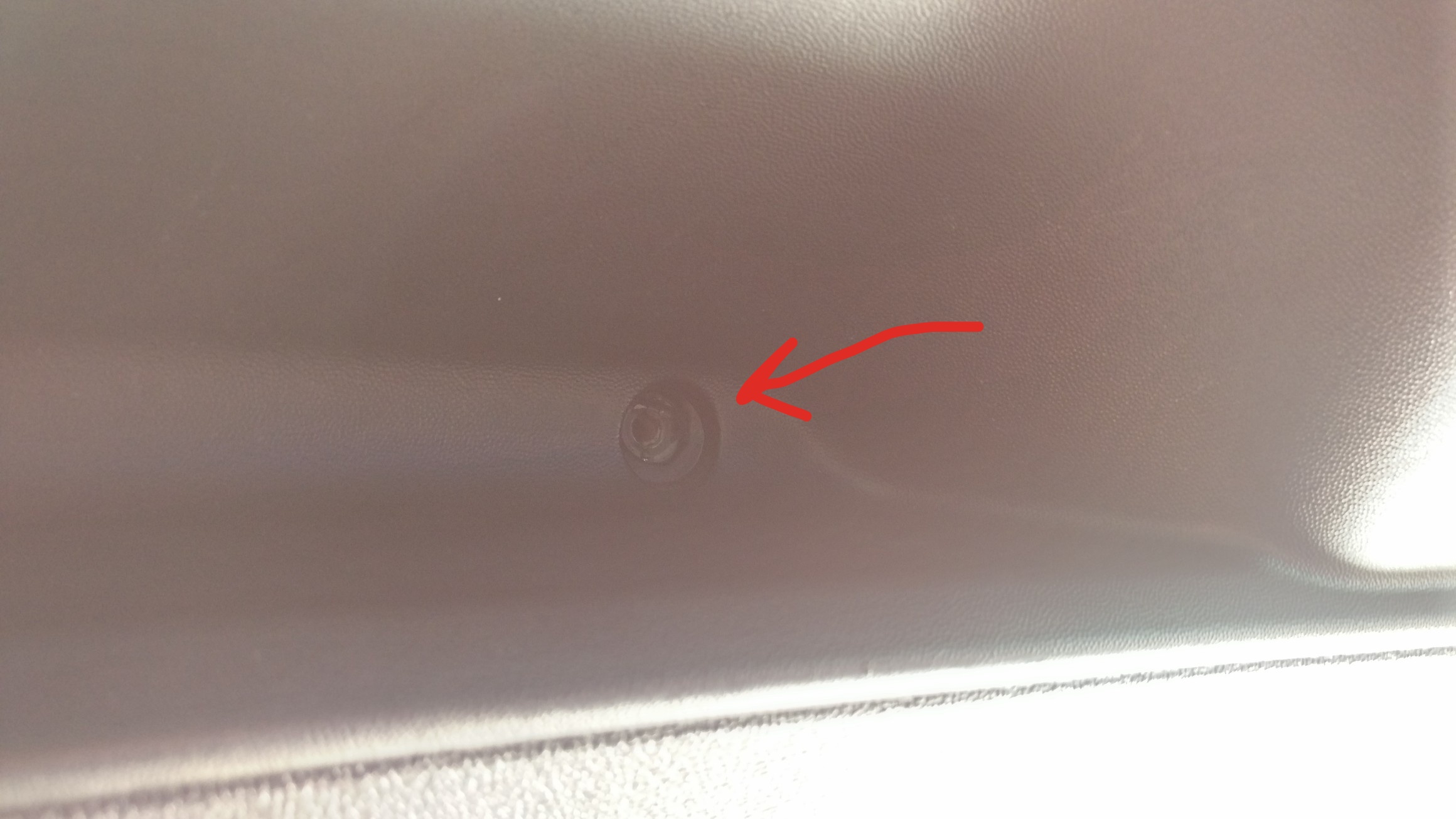

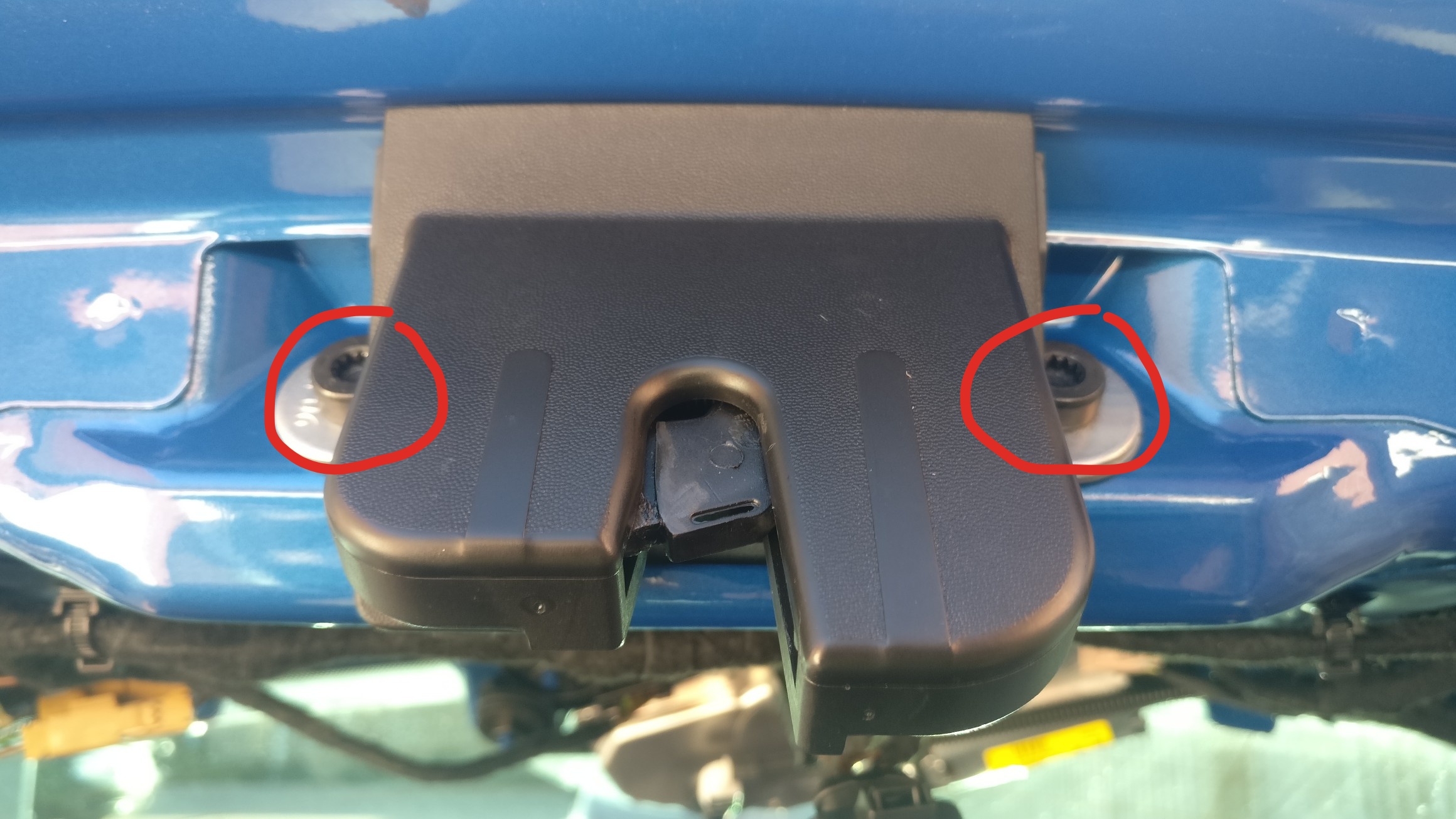

OK so now to undo the first 2 screws holding the trim onto the tailgate. You'll find them by sticking your head into the boot and looking up at the latch you'll see 2 screws (one on either side of the latch)

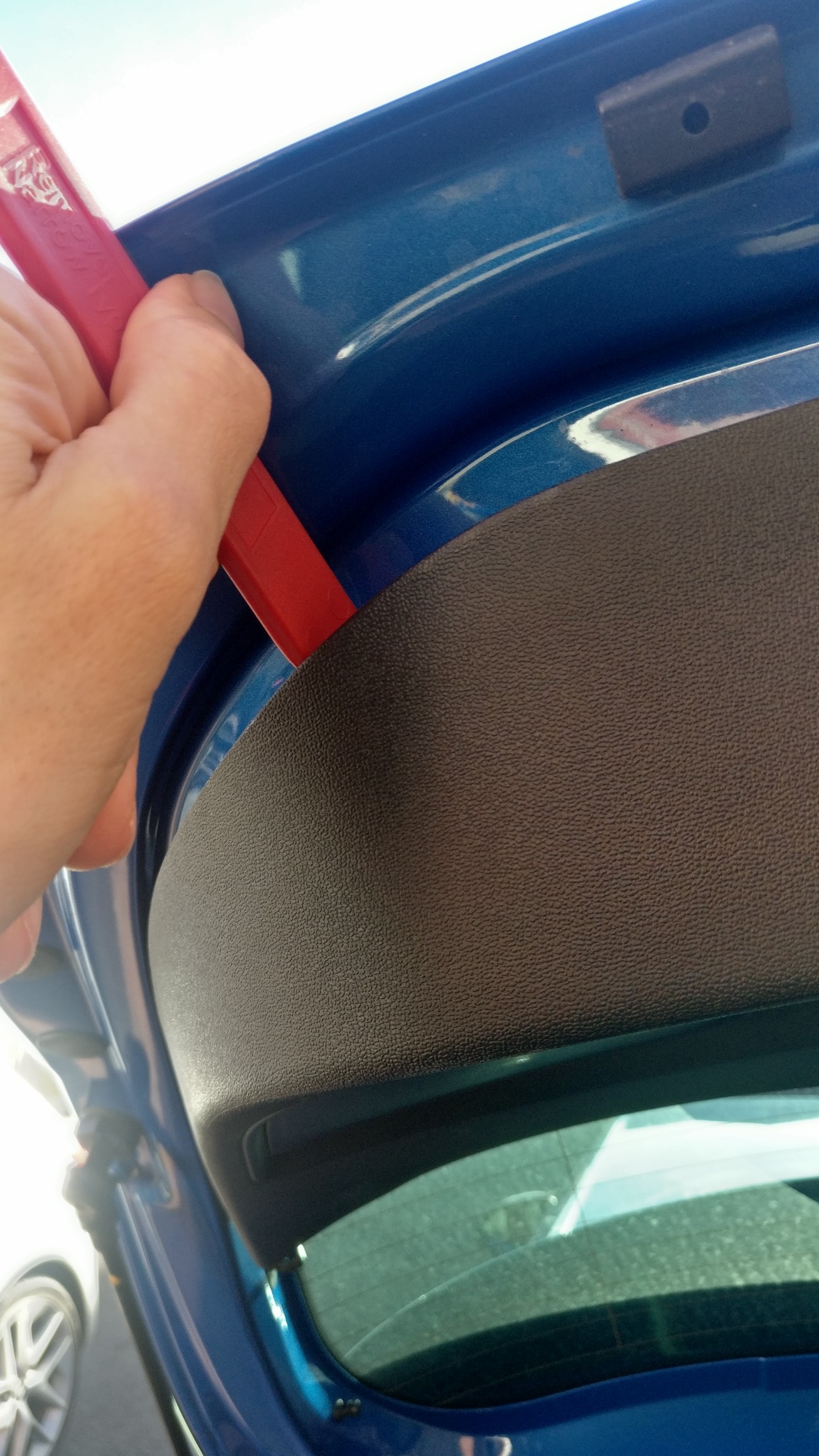

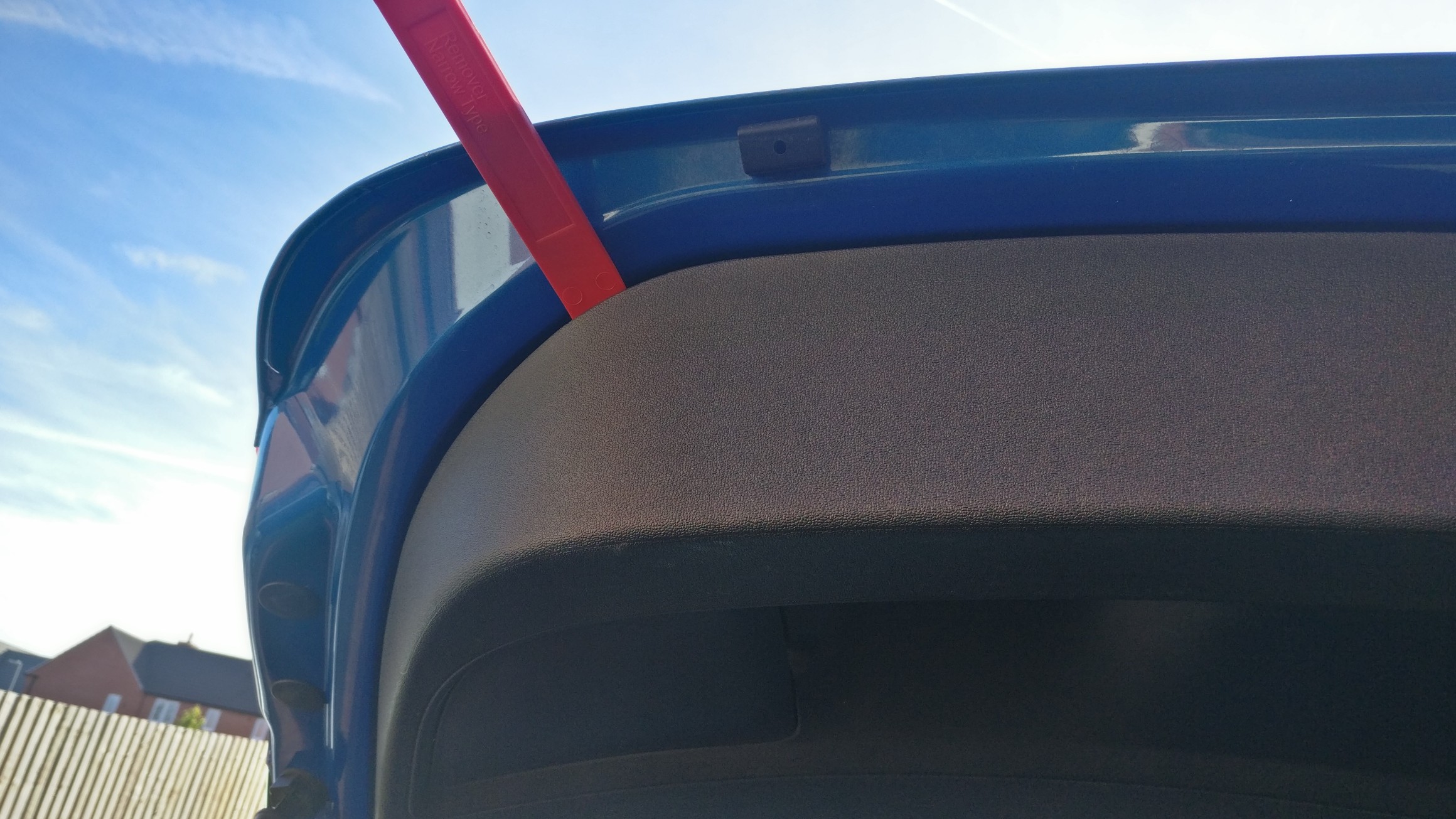

Once both screws are taken out you need to take off the plastic trim, for this you'll need the trim remover at the ready.
Looking at the rear of the car I started by inserting the trim removal tool in about 30cm to the left of the latch, once the tool is in a few inches twist it as this helps release the clips.

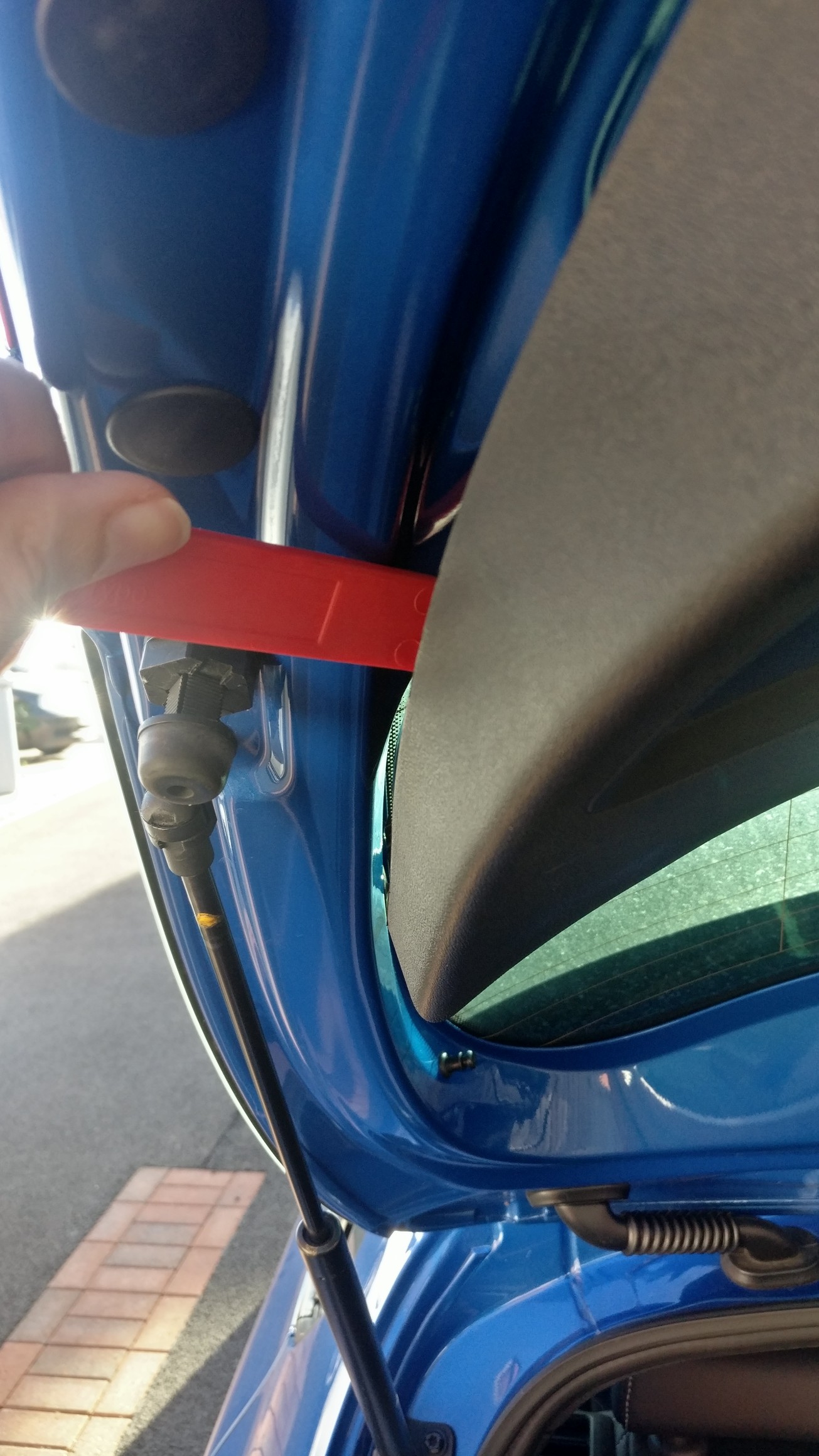

You'll know when the clip is released as its quite a loud pop noise. Now do the same thing going round the left of the trim near the bottom.

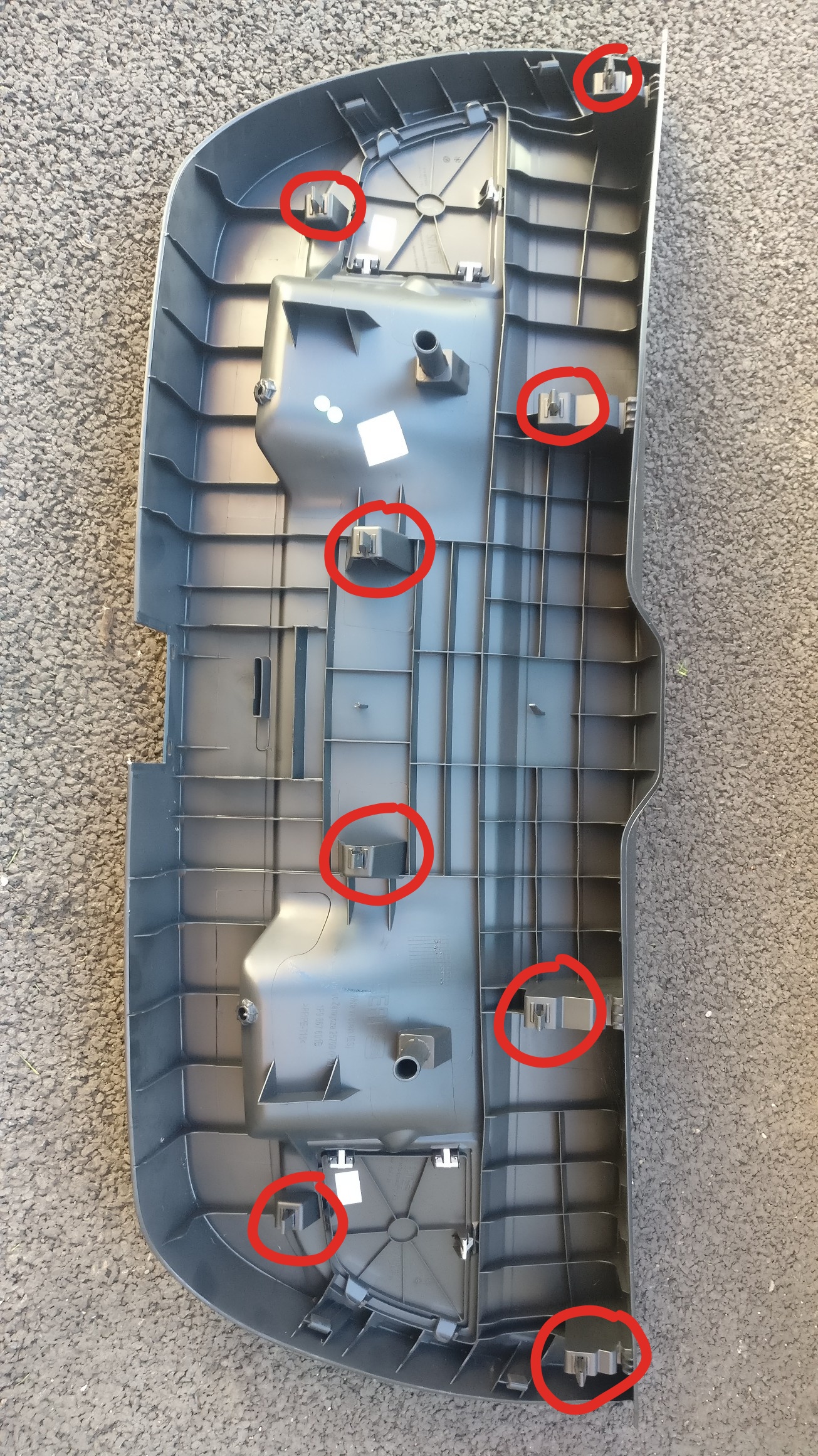

Now do the same on the other side of the trim, once done please see the picture below for the clips locations so you know where to pull for the ones you cannot use the removal tool for.

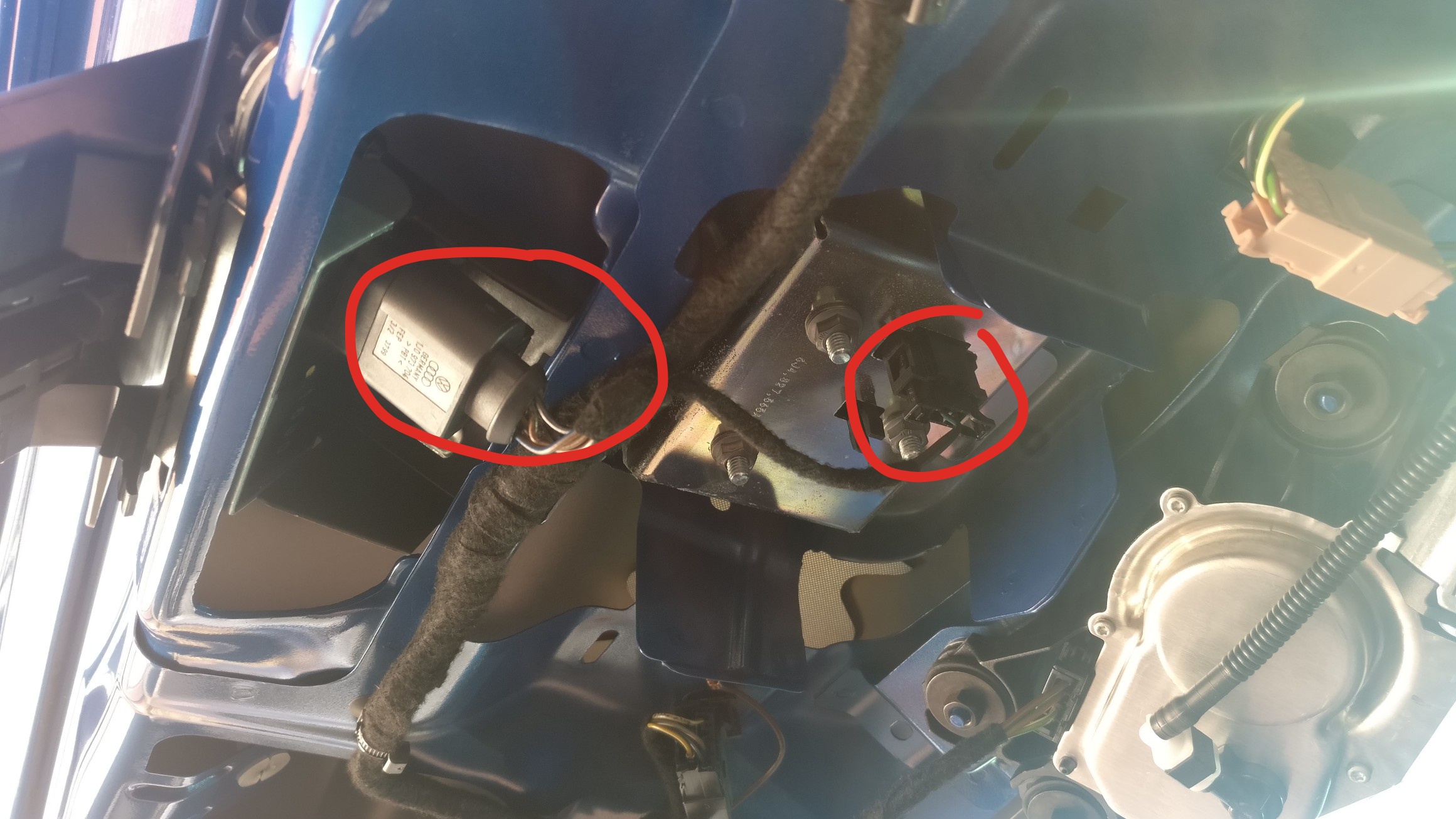

Once the trim is loose it should just drop down, just lay it to one side. You should now be able to see the barebones of the boot workings. You need to unplug two connectors before swapping out the latch both items are circled below.
img_20190515_181922-2320x1305__01-jpg.7003
The one in the middle of the boot disconnects the latch from the boot handle and the one on the left of the pic above is the connector for the latch. The boot handle cable is a pinch connector from the side and pulls down, the latch cable is a pain as you need to insert a long thin bit of metal (I used a smaller long flat head screwdriver) into the hole at the top of the connector shown below.

Once inserted you need to pull the item down so it can release the catch, you should hear a little pop and the connector just pulls away (please note I did use a little bit of force before the pop noise).

Now make sure all the clips are in securely using the picture from the beginning of this guide for locations. Now screw in the 2 screws to secure the trim to the body and you're done.
