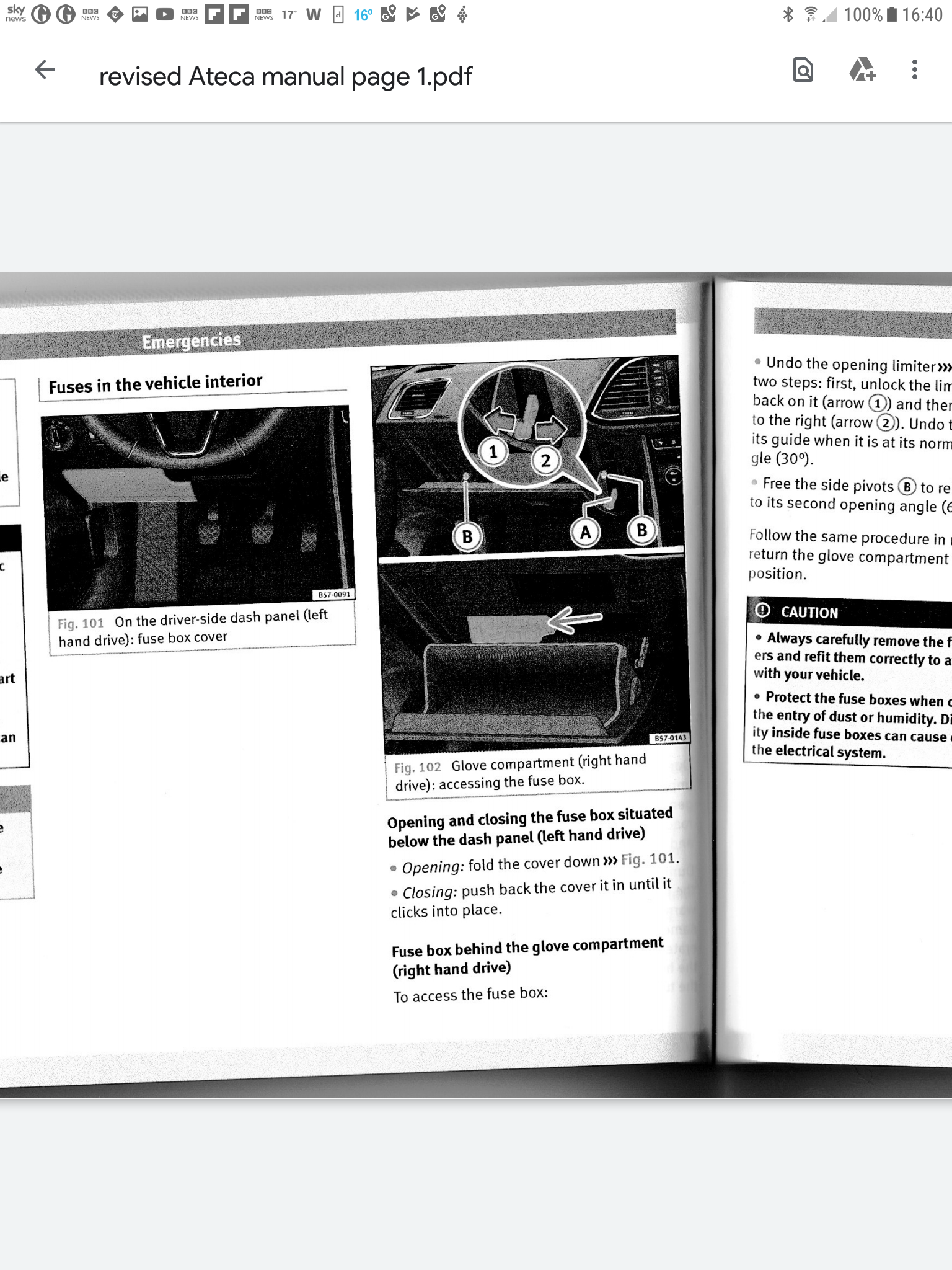

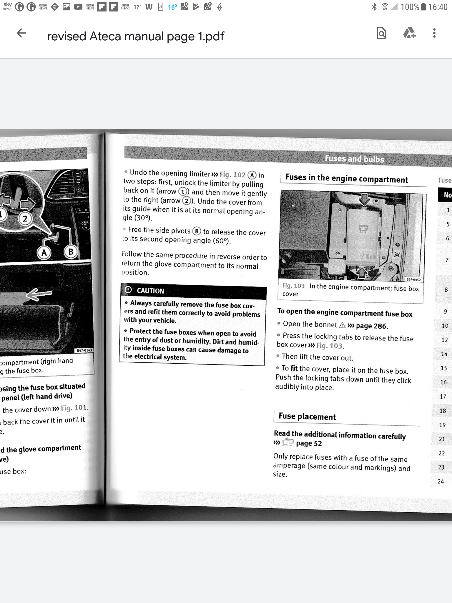

People new to VAG cars wonder where the fuse box is in RHD cars in the passenger area. The Ateca like the Tiguan, Kodiak, Karoq etc it is hidden behind the glove box. It's done to preserve the cabling in the car so the runs are the same as the LHD (assume) but makes it tricky to get at the box. A "dampner" has to be removed so that the glovebox drops right down to reveal the fuse box.
See Ateca manual:

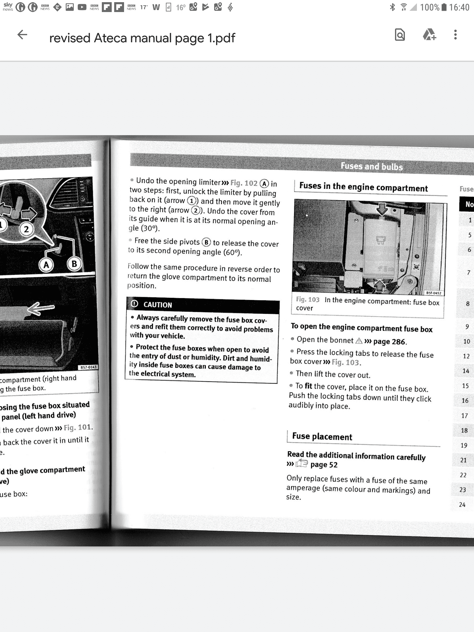

for completeness those under the bonnet:
