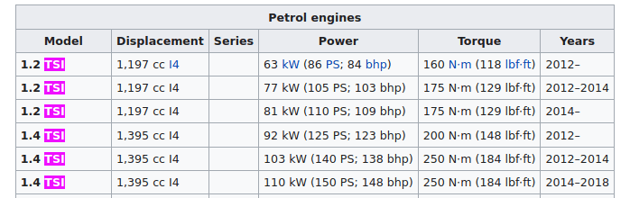

Wikipedia shows the TSi engines have had 3 changes since the mk3 launch:
Am I correct in assuming the brief "2012-" ones were the 8V ones with high oil consumption? There aren't many of these about so easily avoided.
I'm more interested in any differences between the "2012-2014" and the ones which followed 2014. Since the PS are so close, I'm guessing performance is essentially identical but it makes me suspect there might have been an issue which was addressed? Otherwise why replace with almost identical attributes?
My way of looking at that table reckons that only the 110PS 2014 > is a EA211 ie 16V engine.
In any other models and VW Group marques, 105ps = 8V and 110PS = 16V., so why not same here.

Yeah 1.4 is my preference but I do enough town driving and find myself stuck behind a fiat panda often enough to consider picking up a 110ps if there's a serious amount of green queens to be saved. Nevertheless the above confusion still applies to the 1.4 engines, namely are any of the ones in 2012-14 Leons those dastardly 8 valve oil guzzlers? And what changed between pre & post 2014 TSi engines?
2014 is ACT, active cyclinder technology so will go down to 2 cylinders to save fuel when trundling along
