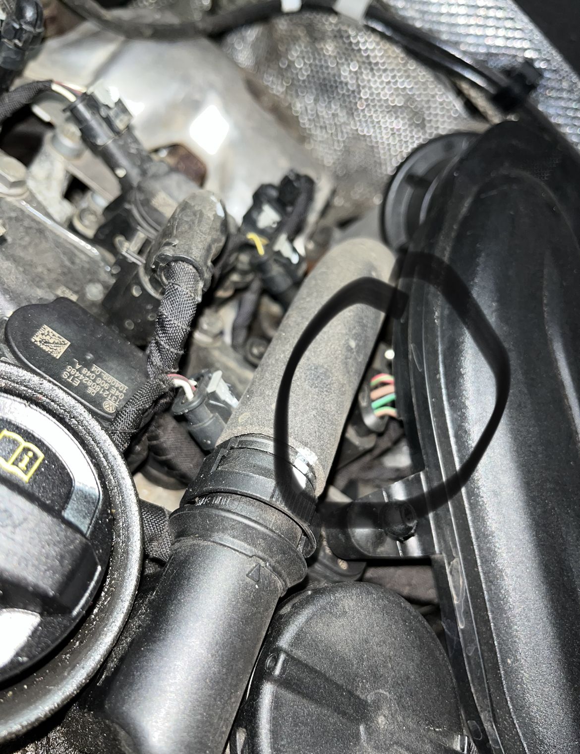

this?
Dont think so that just looks like a connector?
Yeah thought so odd there’s no connector on the pipe unless I’m completely blind.

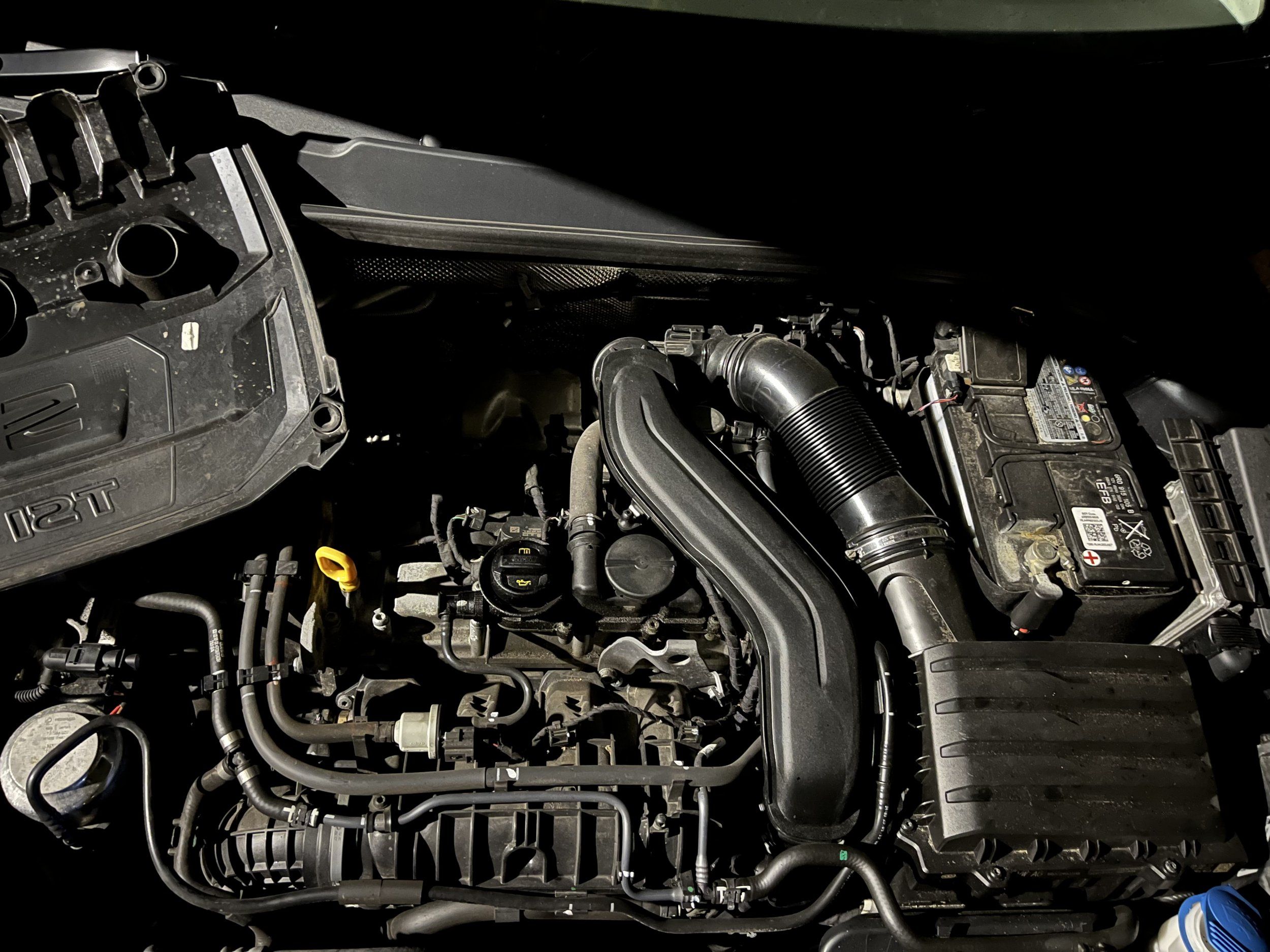

when I took the engine cover off noticed this?
guess have another look in daylight tomorrow
Wonder if it only has a MAP and I’m looking for the wrong thing

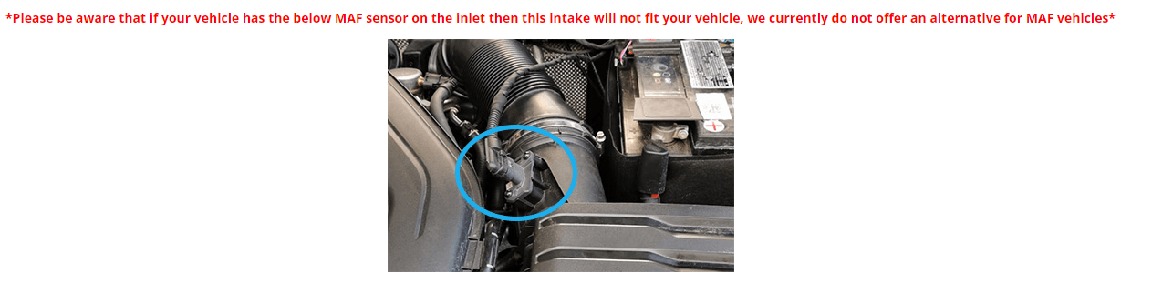

If you had a MAF sensor it would be here: so you don't have one.

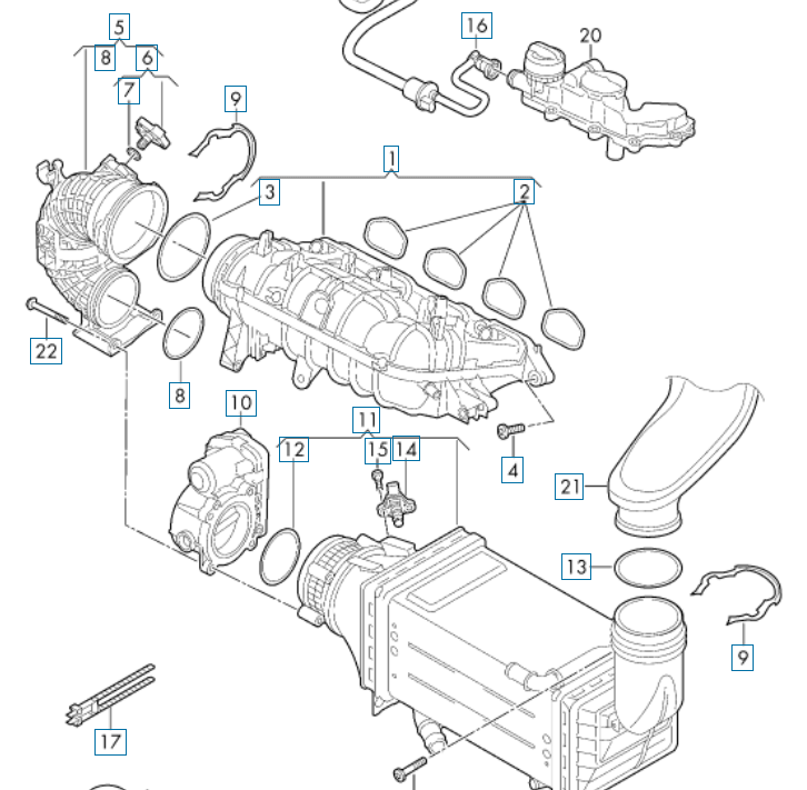

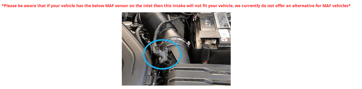

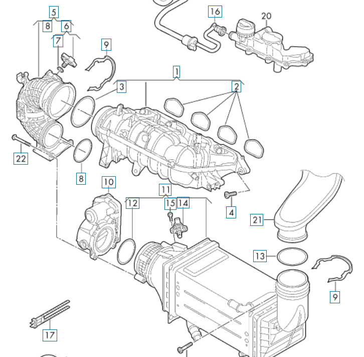

Looks like you have (at least) 2x air pressure sensors 6 (GX9) & 14 (GX26). They are both combined pressure and temperature sensors so it can calculate the mass of the air from its pressure and temp. If these sensors are showing values outside an expected range I would expect it to flag up a warning light/fault code.
