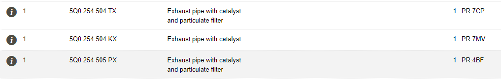

For the 1.5tsi seems like PR codes determine with or without filter - GPF
I think;
DADA engine code is without GPF
DPCA engine code is with GPF
