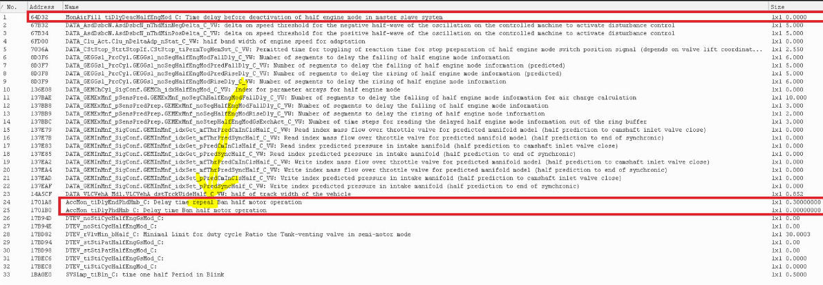

I think i found how to force a delay in ACT activation

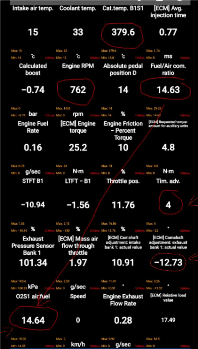

==catalyst heating (first 2-3 min after cold start) - kangaroo
-see spark retard - to generate more temperature
-FR commanded 14.63 but at the lambda probe is 14.87 because of exhaust camshaft overlapping with the intake one(scavenging) in order to have more oxigen to burn and heat the catalyst.

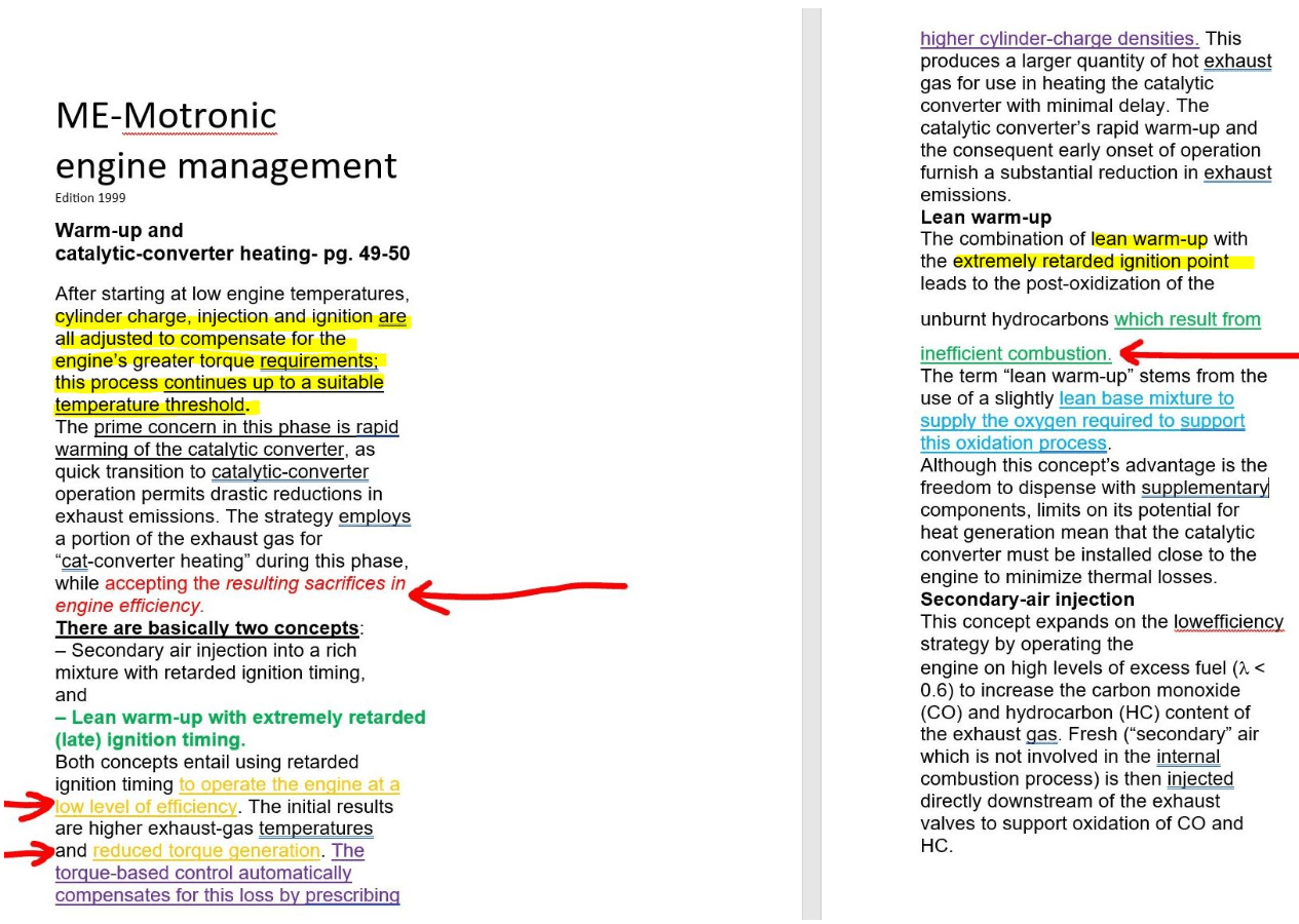

See above picture: "The torque-based control automatically compensates for this loss by prescribing higher cylinder-charge densities."
==And this is the trick that WV was using to try to fix the kangaroo and still not working :)

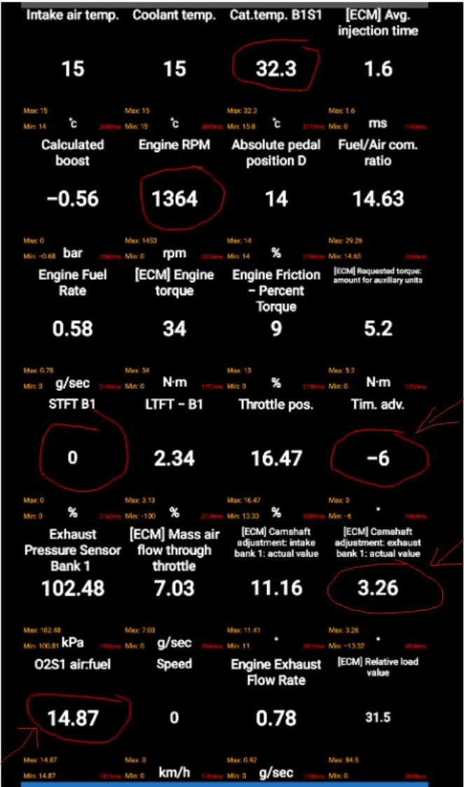

== catalyst has now the normal temperature, back to idle rpm, kangaroo not present.
-because the engine is allowed to run efficiently
-perfect lambda 16.64
-correct spark advance
-inlet/exhaust valves are not overlapping
