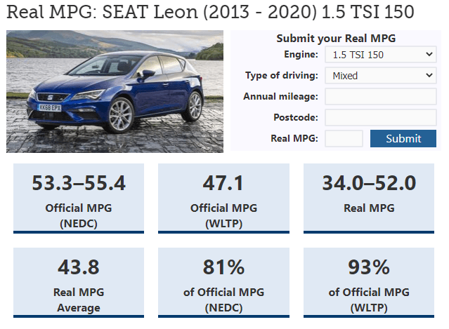

Yes from cold, my thoughts were to do a drive which is optimal for getting a decent mpg - just to see if the car is able to get a reasonable mpg - to be honest that 47mpg for a 3 mile journey is good - and shows that the car is 'capable' of decent mpg.

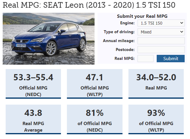

The 150 Leon real world mpg figures are between 34 & 52.
Anecdotally I find these honest john real world figures quite accurate for the various cars I have used.

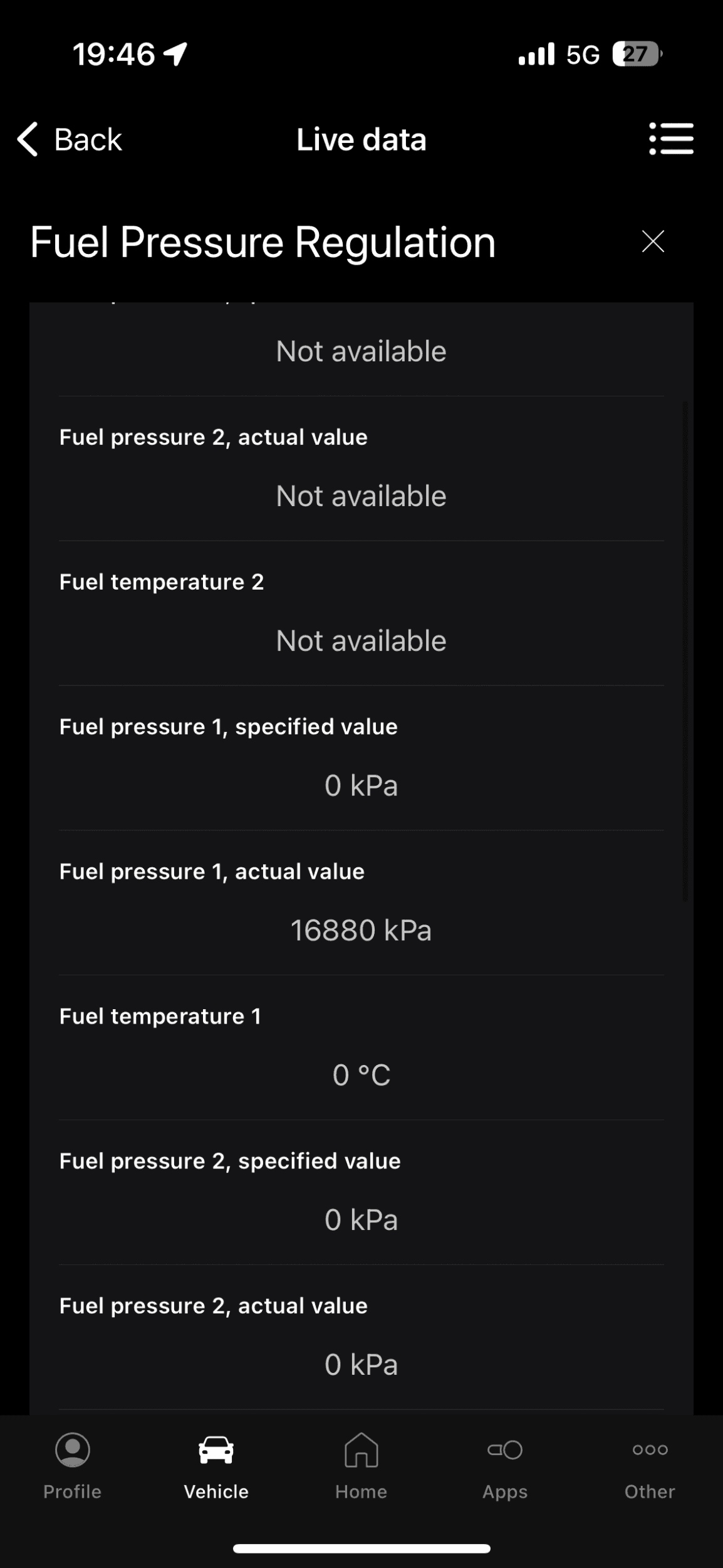

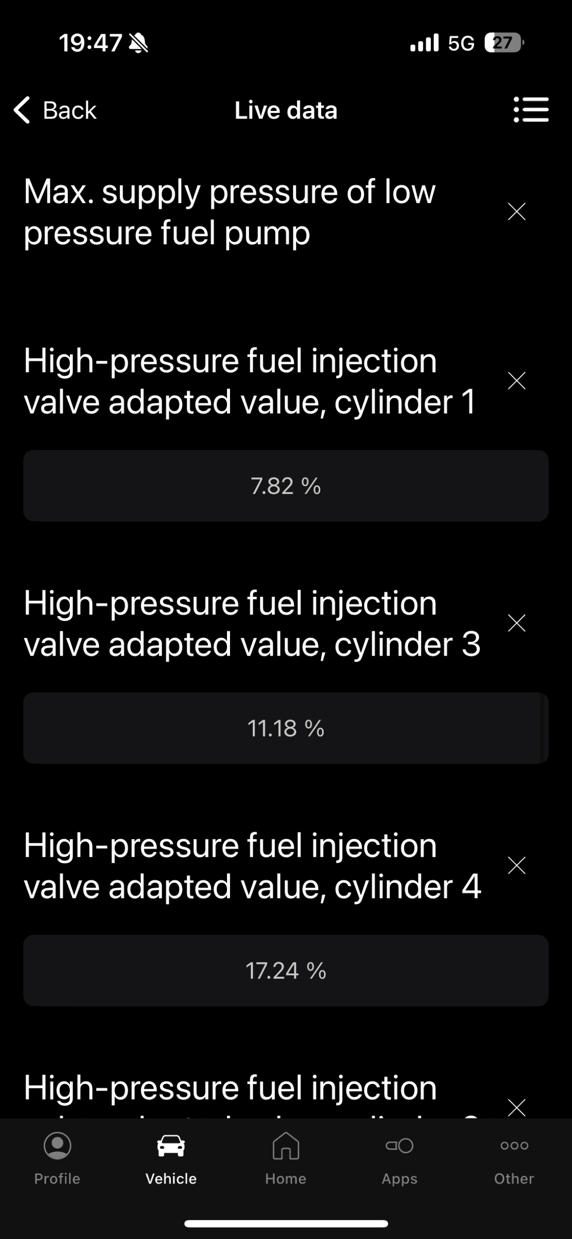

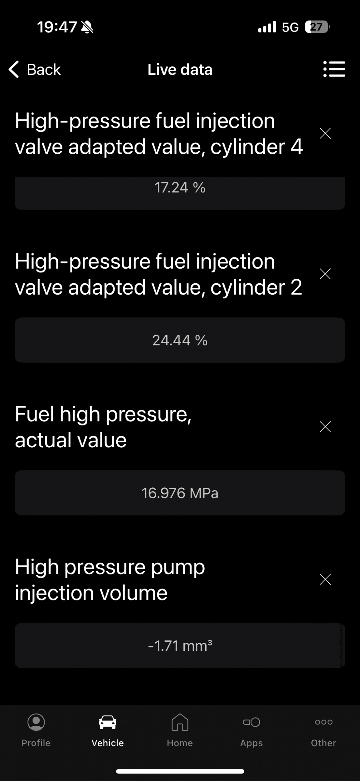

Does any of attached screenshots mean much to you, what a captured this evening when nipping out, car was at idle btw regarding fuel pressure
Coolant seems to reach temp when driving, will try and time. I hate that obd11 doesn’t allow you create charts on iOS app.
Although noticed that when idle the temp seems to exceed 90 and go into 100-110. Is that to ?
Unsure if linked but I’ve noticed an issue with radiator fan and engine temp. Doesn’t seem to kick in even though engine coolant temp reaches 90 and above 100c.
Only seems to kick in if I turn heater up with AC on, but when the coolant temperature is showing as 108c for example. It’s not turning on for some reason…Don’t think that’s normal?
how do I also check if coolants flowing correctly, someone mentioned the top radiator pipe but unsure where’s his located or looks like on my 1.5 TSI engine

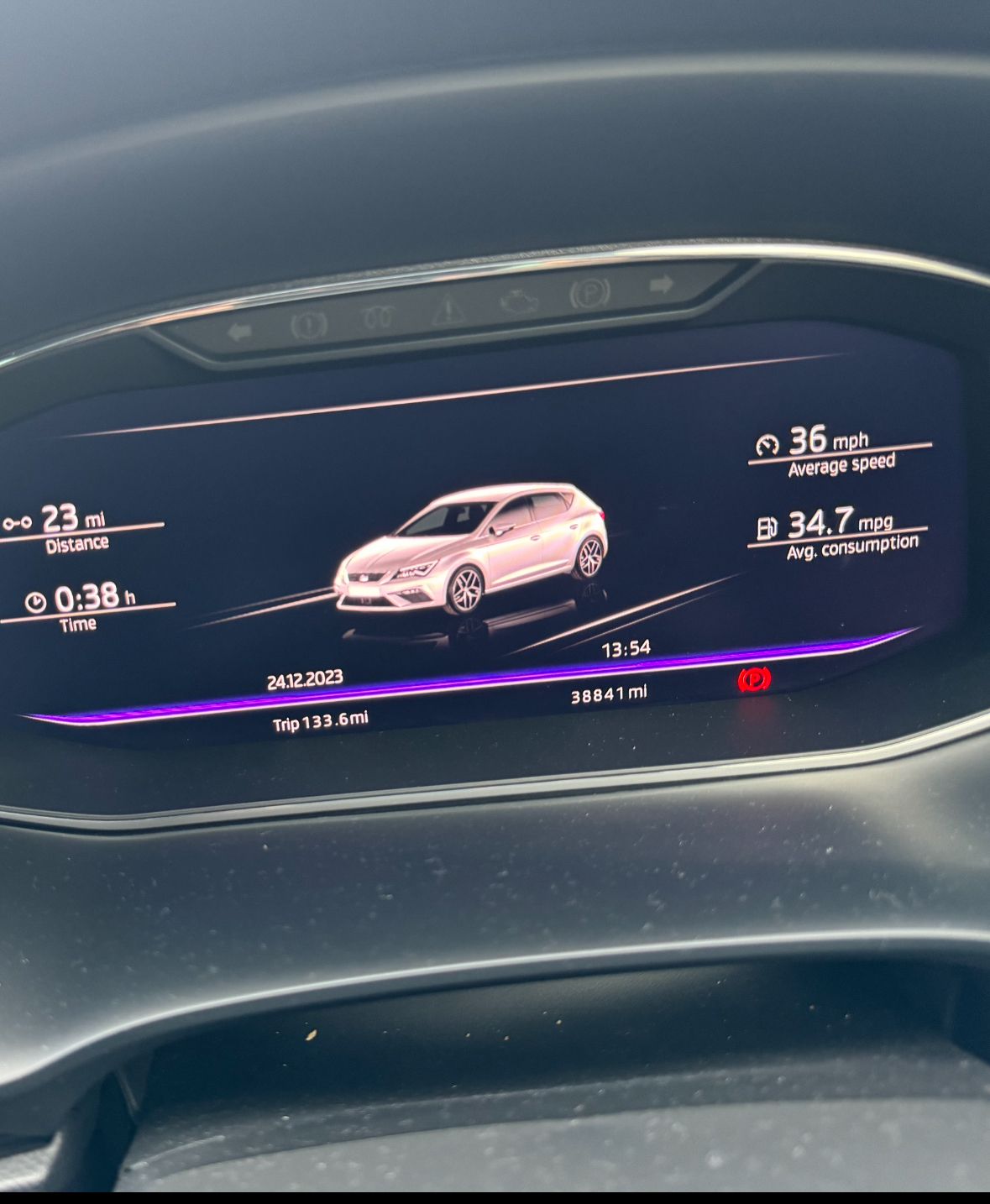

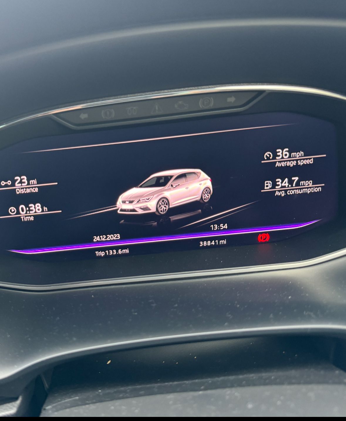

Did a run down the motorway - at speed limit generally there was a few minutes of standstill traffic due to an accident but generally smooth sailing.
And this is the best I got this afternoon from cold on a 23 mile trip. ?
Stopped off at a relatives then when restarting car I manually reset since start data, as it doesn’t anutomatically do
It until a few hours off. And even on trip back didn’t get much better.
Not sure what to as definitely not normal.
Oil temp seems fine see it hits 100c
Coolant temp from obd11 live data, reached 90 and into the 100s so seems to be heating up okay? Unless it’s false readings.
Just don’t get why it’s so poor.

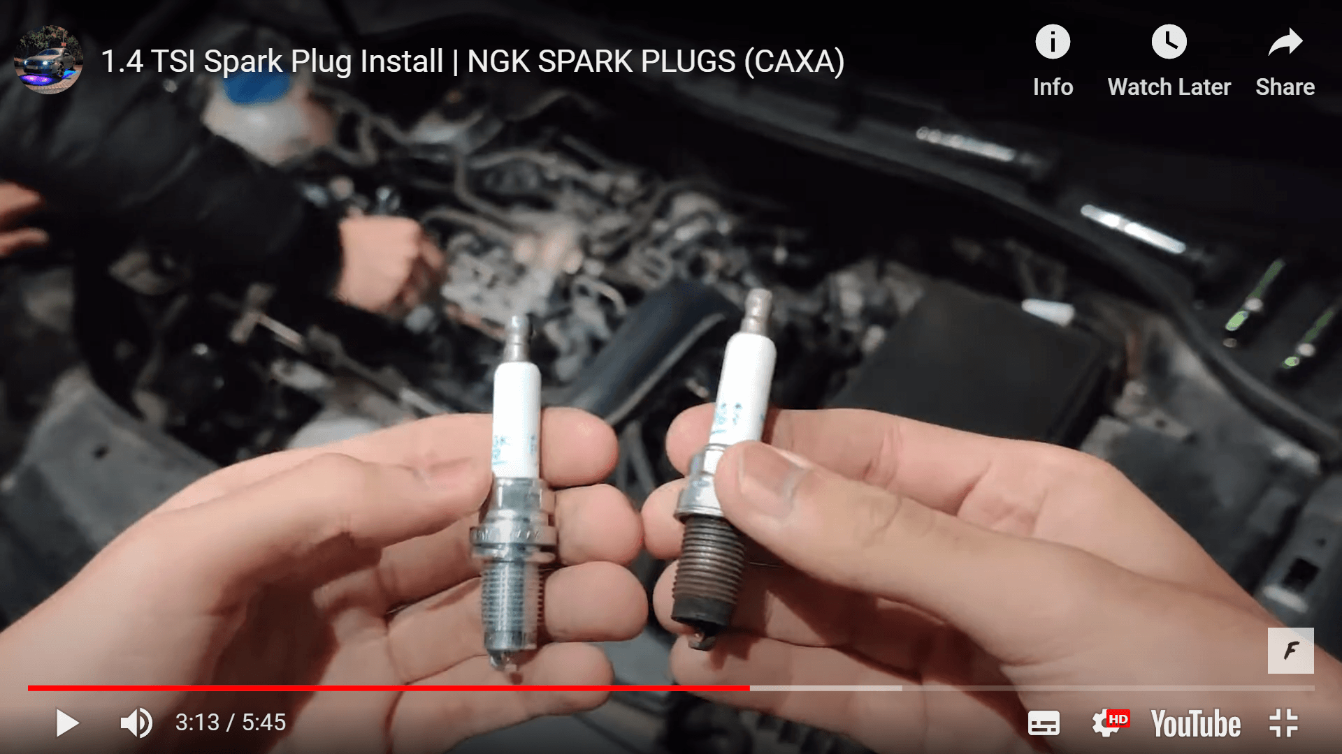

Spark Plug & Air Filter - should have been changed last year with the air filter when I got a major service at Seat.

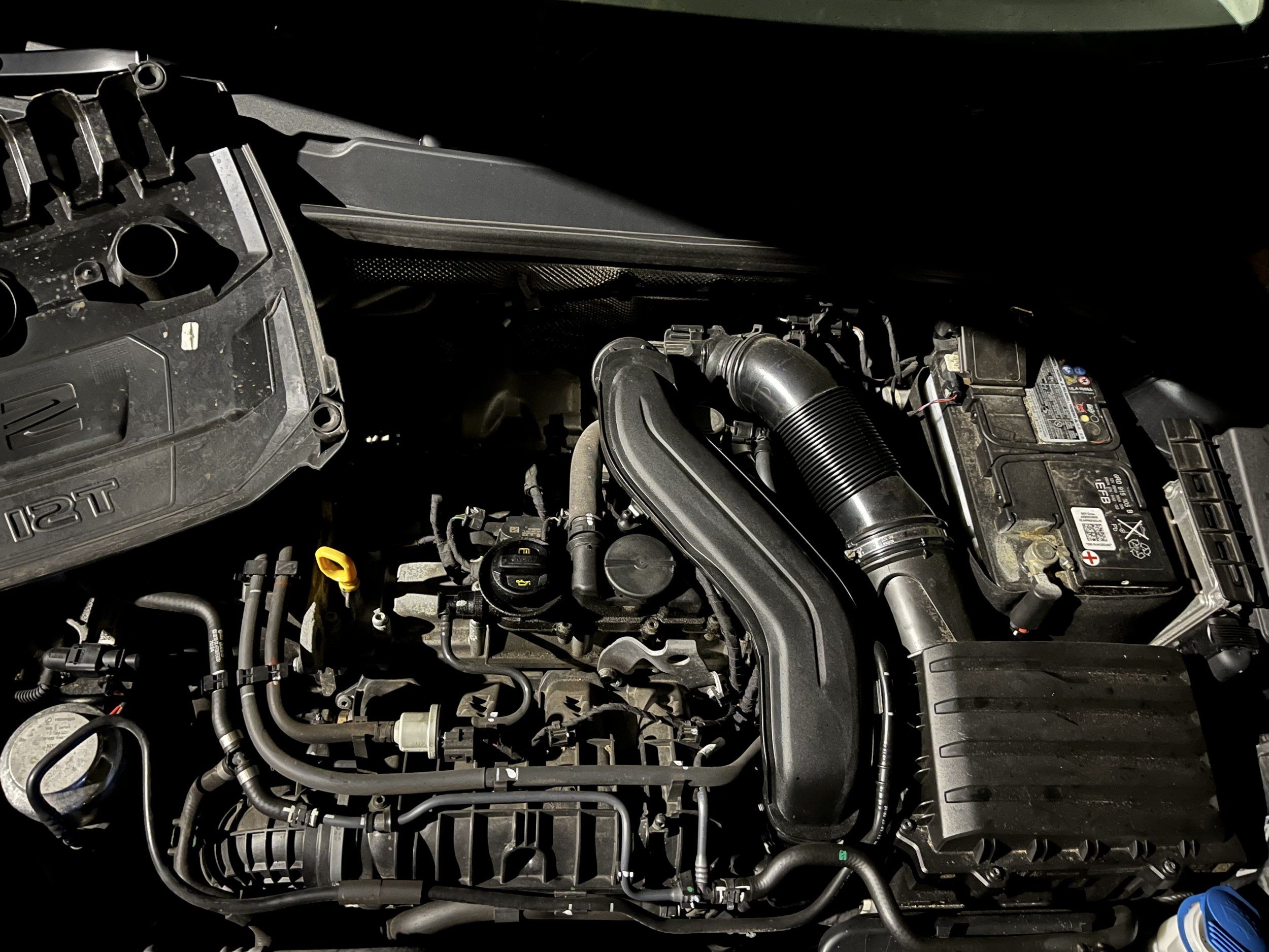

Air filter is an easy/free to check - just unclip the lid and check - but should have been done at the major service I would think.
Could take some of the intake pipes off to check inside for oil/contamination?

Engine Air Filter and Intake
Will check this hopefully later, had lost the screw driver I needed but think ive found it.
So hopefully try and check tonight or sometime this week.
Will see if I can figure out the intake pipes removal and check - I find the workshop manual bit confusing but sure I'll figure it out.
Kangaroo issue

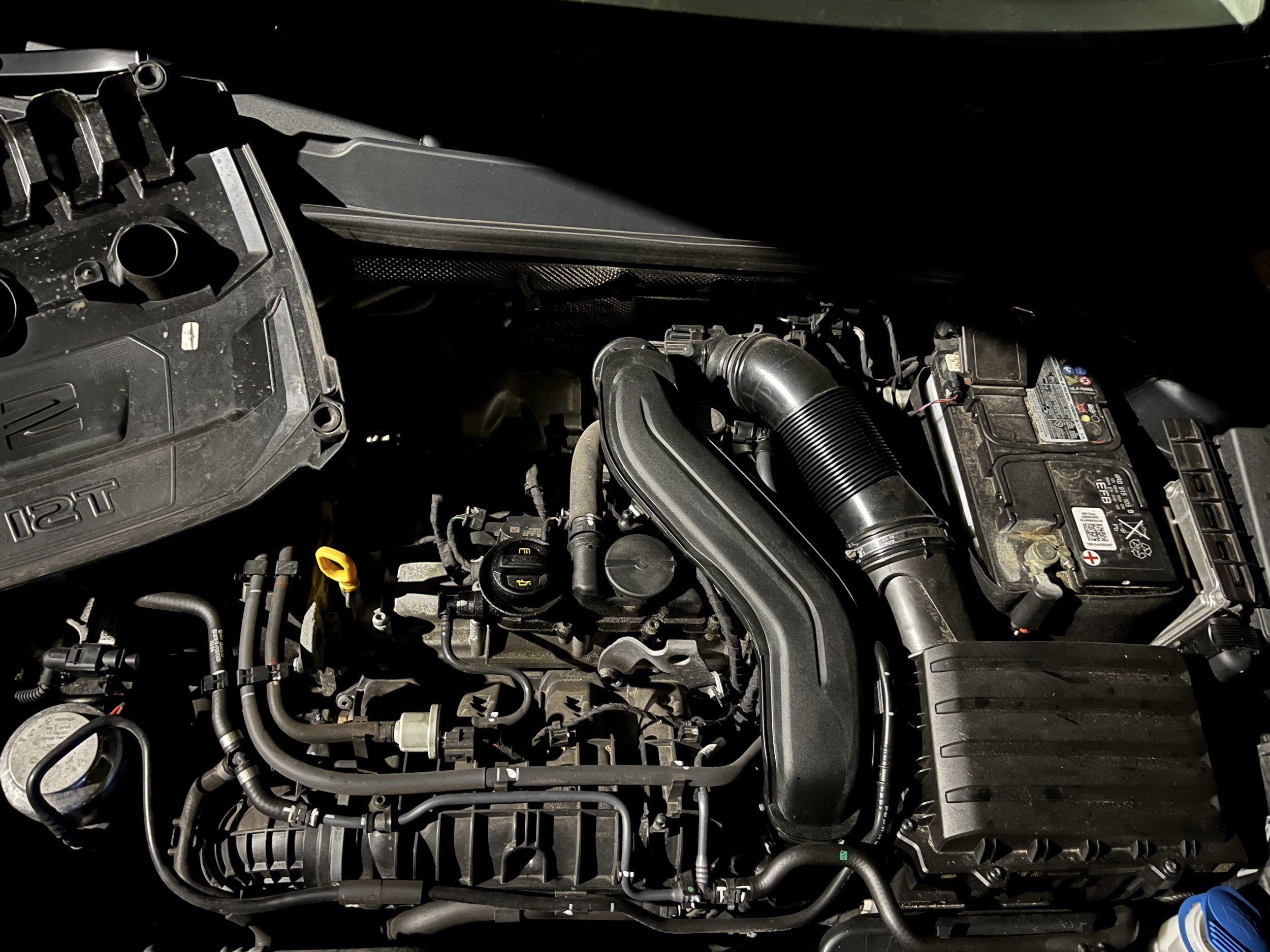

So had a mechanic look at my car who actually had a look rather then just scan for fault codes and call it a day if not.
He noted that to him the piston rings are worn, and oils leaking into the spark plugs and intercooler pipe.
Cars booked at seat about fuel and performance issue, prior to finding this out. So sent photos over of the plugs that mechanic sent me via email in the meantime.
Apparently the oil on the plugs which were changed last year is normal? And the oil in intercooler isn’t anything abnormal.
anyone chime in if that is normal?
Just trying to finally get to the bottom of this ongoing issue fed up, I think if Seat don’t agree or find any issues in their opinion jsut going to have to sell and cut my losses. Definitely something oddd going on with the car

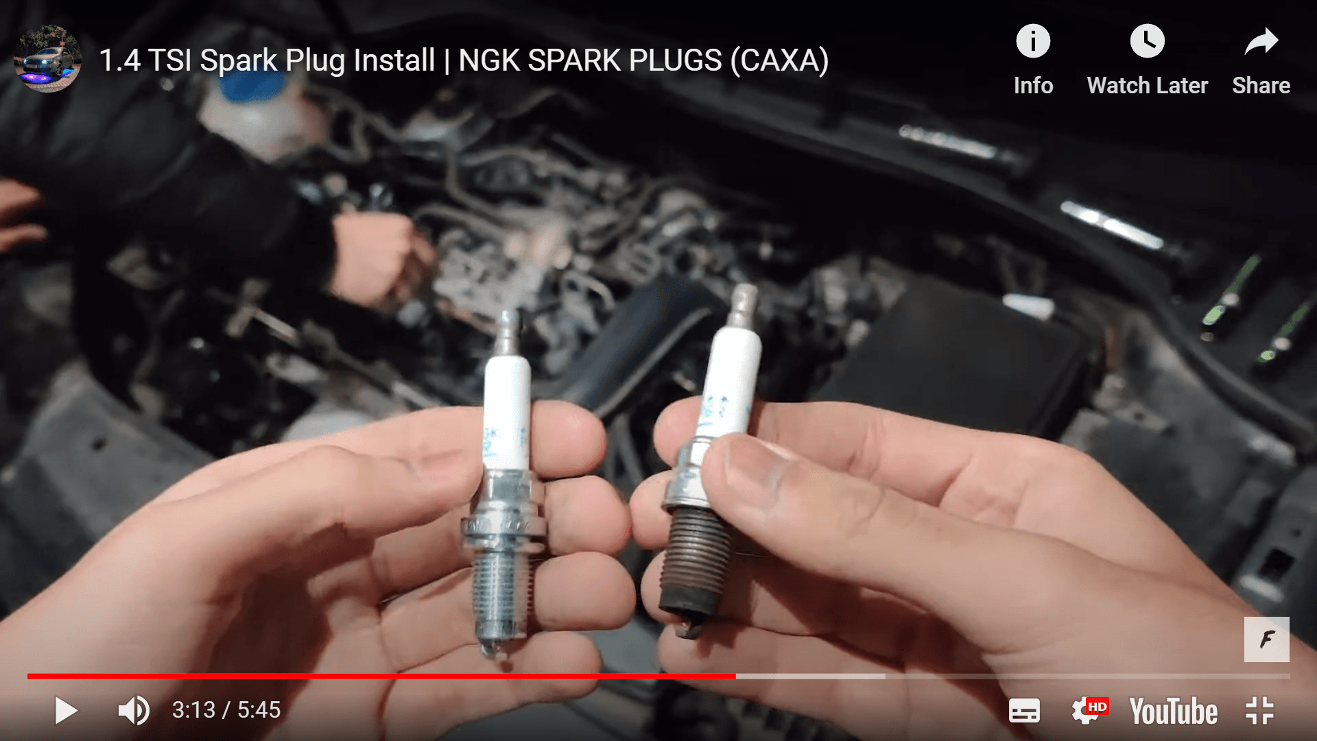

I would agree with your mechanic - those plugs look rather oily.
And the inlet looks oily - though that will never be perfectly clean with a turbo engine - difficult to tell from a photo how bad, but it its pooling - or runs out I would say its bad.
How does he know the rings are worn? did he do a leak down test? or just an assumption from the oil? Does it use any oil? How many miles has it done?
From here -
earlier engine but would think your plugs should look more like these: and not all oily.

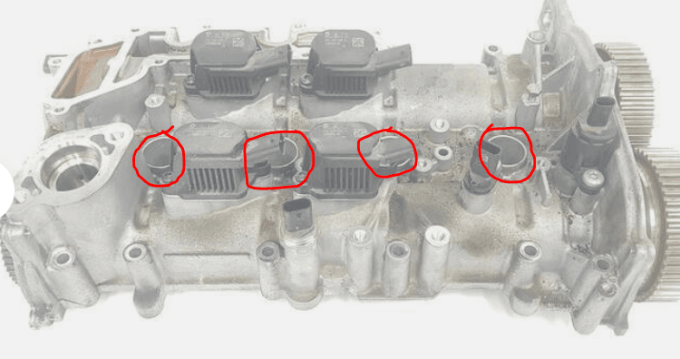

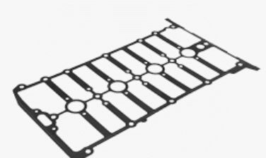

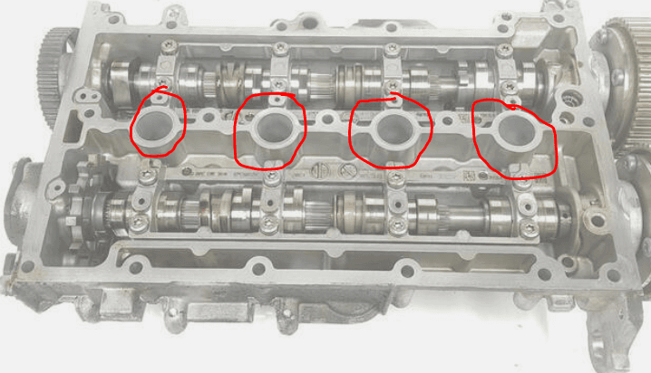

The top/porcelain of the plug should be clean/dry - maybe this contamination is effecting the ignition/spark - which will effect your cylinder burn?
topside of the cylinder-head cover - where your plugs go through:
underside
There is a seal between this cylinder head cover (cam carrier) and the cylinder head, which I think is the only way the plugs could get oily on the top? unless there is a leak on top - where the coil packs go which I think is unlikely?
The tip end of your plugs didn't look so bad - so maybe it's not burning much oil?:

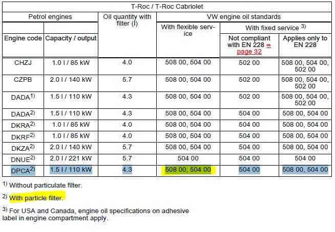

Oil:
you can use 0w20LL4 or 0w30LL3 in DADA or DPCA
(probably your fuel economy will have a little drop but the long term lifetime of the engine will be better)
it is official and approved by VW, see the picture :)
