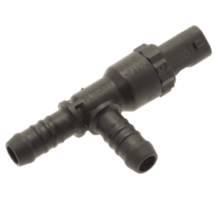

Fuel temperature sensor is near your fuel filter and high pressure pump in the engine bay.
part number 04L919824 superseded to 04L919824C after 03.04.2018
90c seems high for fuel temperature - but I have no experience on what the fuel temp range could be?
Does it start at ambient temp after a cold morning start? and slowly increase?

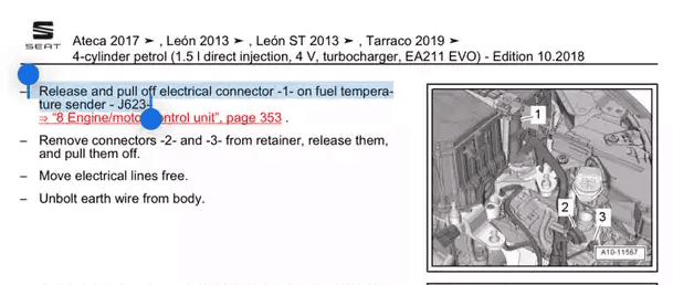

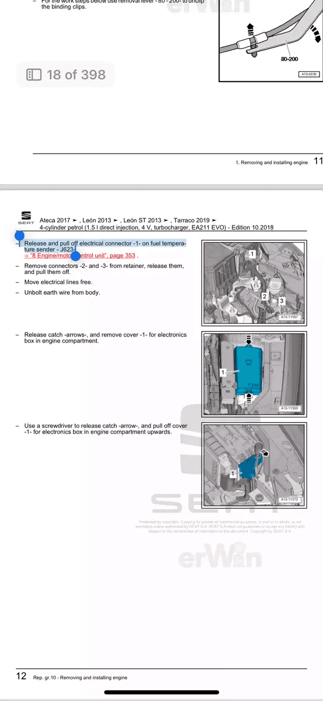

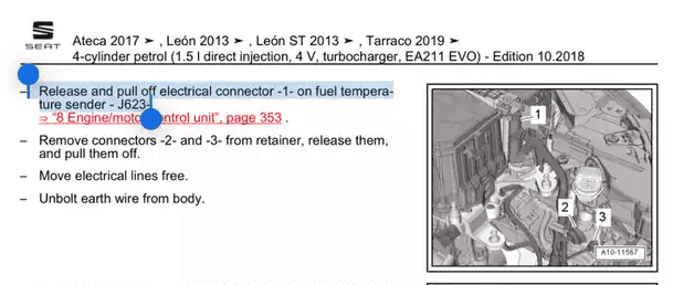

I’m trying to read the mk3 workshop manual, believe “3” is where it’s located? The sensor seems to be located basically under the washer Resovoir?
Am I reading it correctly?
As for if it’s normal, from what I can see from searching the net…which is hard enough as fuel temperature sensor is also bringing up coolant sensor results.
My understanding is no it’s not supposed to get that hot and when it gets that hot it starts to boil and evaporate - which cant be good for the car and fuel economy in general.
If it is indeed actually reaching that temperature and the sensor is accurately reading.
Why it’s getting that hot I guess that’s what I need to figure out.

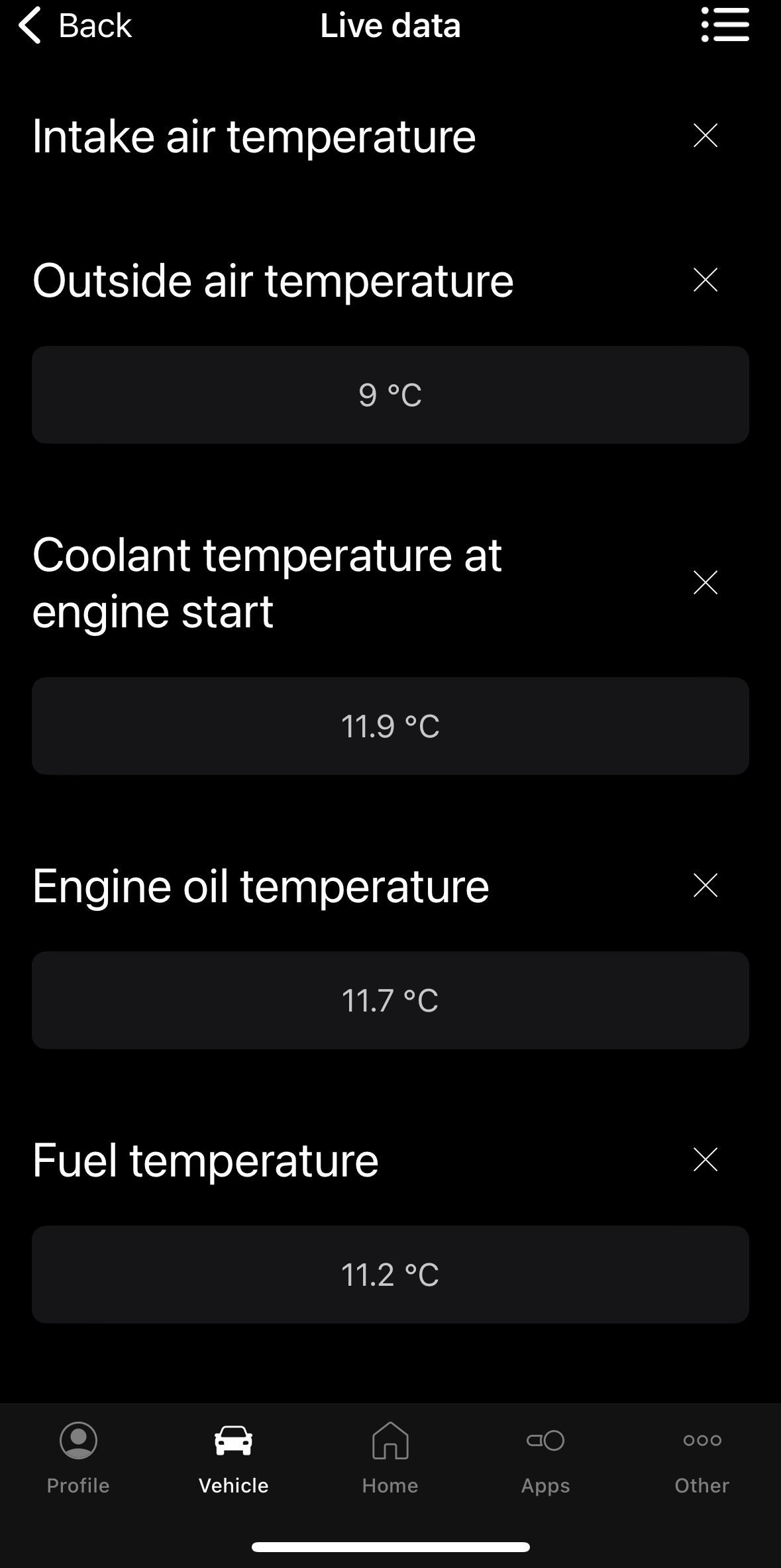

At cold morning start it does seem to be close to ambient.
See quick screenshot I took at start on Thursday.
Can’t remember the values when I reached work sadly, but I’m gonna guess around 65ish on that 15 minute journey.
Usually higher if I drive longer but I chill check tomorrow before and after I reach work
Sorry - scratch that - that is a DIESEL fuel temp sensor!
Hmm - I tried searching in Leon parts catalogue for fuel temp sensor - and that is the only one which comes up - listed against diesel engines.
Can't see anything listed for a petrol!

in that screenshot from the workshop manual do you think number 3 is the sensor?
So one thing I noticed today, was fuel temp seems to rise when idle e.g. in slow moving tra? Would that be the expected behaviour.

Agreed probably the best way to check your fuel temps are sensible if to log a similar engine/car.
Number 3 in the diagram would be most likely I think, but something seems strange - I can't find any mention of a fuel temperature sensor in the parts catalogue. I'm thinking maybe the fuel temp is done by another sensor - maybe the rail pressure sensor - or by the intank fuel pump/module?

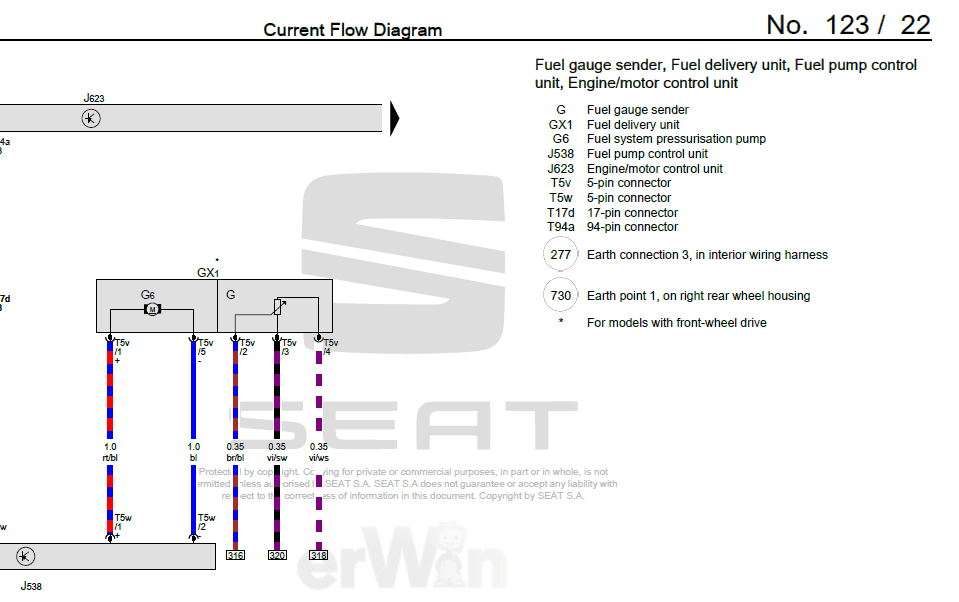

Looking in wiring diagram for your engine
I can't see any fuel temperature sensor, in fact I can't see any fuel temperature sensor for petrol engines, ONLY Diesels.
this is your fuel delivery module wiring - GX1; G6 your fuel pump, and G your fuel level sender - so no fuel temperature.
And G247 is your fuel pressure sender - only three wires, so no temperature.
From your post - "pull off electrical connector -1- on fuel temperature sender - J623"; well J623 is your main ECU connector. Could be a typo.
I think either your diagnostics is incorrectly labeling that value as fuel temperature - or the ECU calculates the approximate fuel temp from other sensors.
Does your coolant temperature/ambient temperature and fuel pressure look 'sensible'?
I would try a motorway test - pick a nice dry day, avoid rush hour and avoid hills, reset your MPG trip for the journey (not long term trip), and cruise control on at 55-60mph for something like 30 miles and see what the MPG is? this should guarantee a good MPG, if still poor then you definitely know something isn't right.

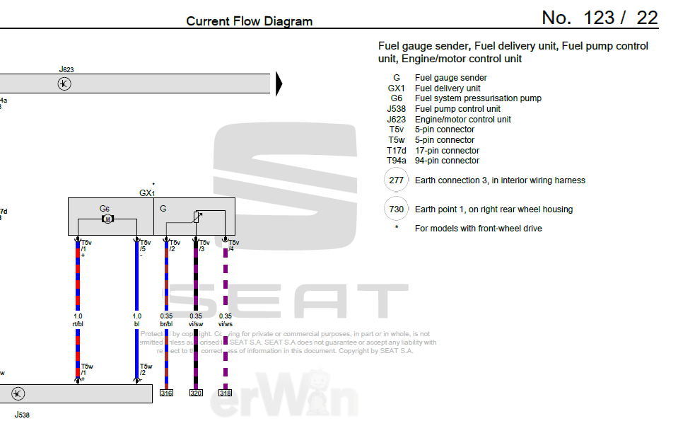

Interesting will take a look.
Coolant temperature looks okay seems to fluctuate been 90-105.
But then I’m unsure about the radiator fan, when I’ve seen coolant values at 105, the fan doesn’t seem to be kicking in.
Just remains about 10.5%, I can get it to kick in by turning the AC on full blast.
So I don’t know that’s normal?
How do I check if coolant is flowing into the radiator properly also?
what would be a normal fuel pressure? I’ve been looking into but unsure what would be classed as good or bad.
I’ll give the motorway test a try pretty sure I’ve done something similar in the past but will give it a wiz maybe Saturday.
Also noticed sometimes the car seems to vibrate on idle, rpm at like 6-700 but car feels like it’s shaking a bit - but I don’t know if that’s me just hunting for an issue that’s not there
The 1.4 has a low pressure fuel system; "during normal operation between 2 and 5 bar. when cold or hot start is made the pressure is briefly raised to 5 to 6 bar depending on the engine temperature.
High pressure of between 140 and 200 bar."
The 1.5 has high pressure between 170 to 350 bar. Can't see anywhere confirming the low pressure system pressure - but would guess similar to the 1.4?
