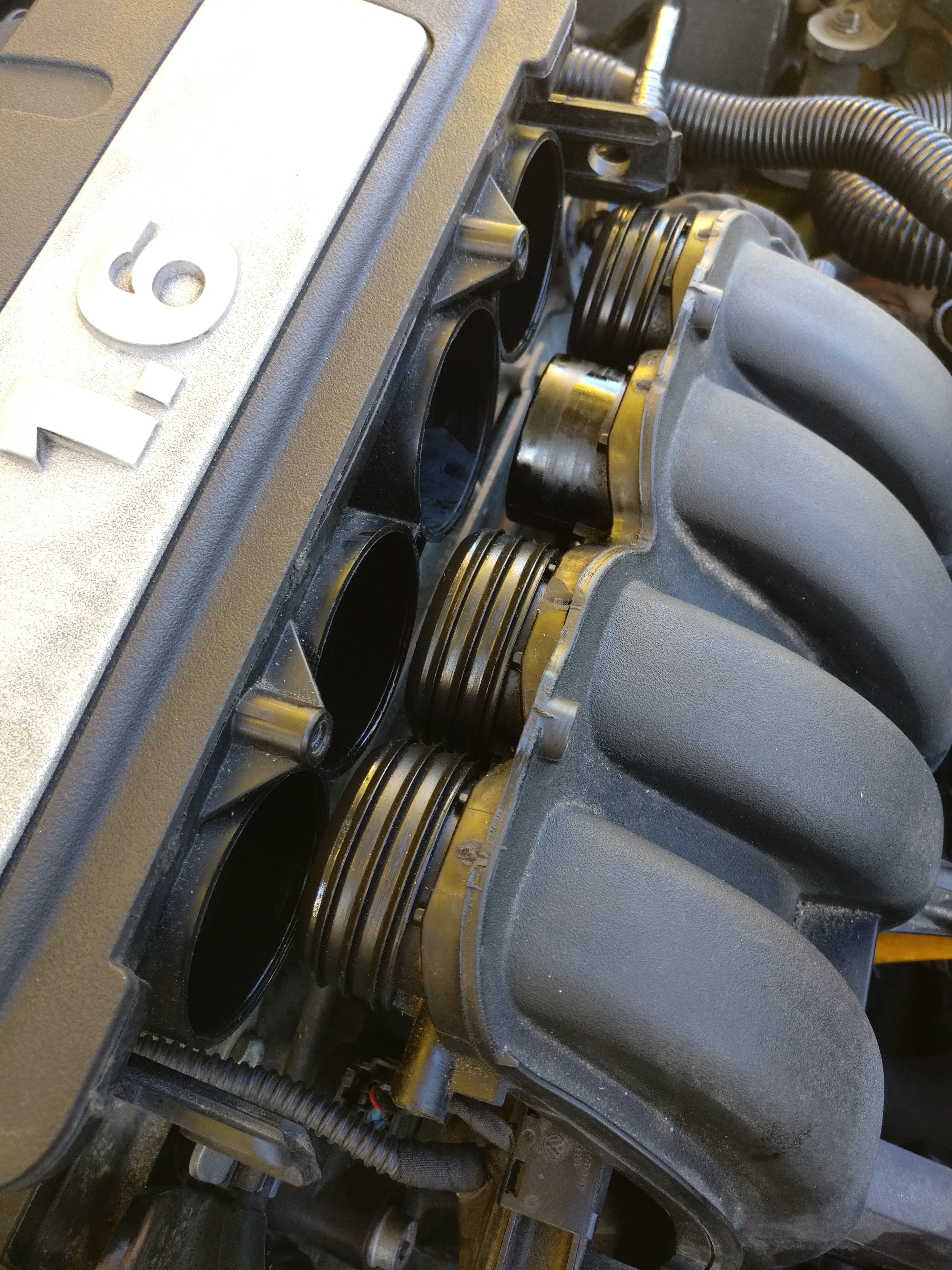

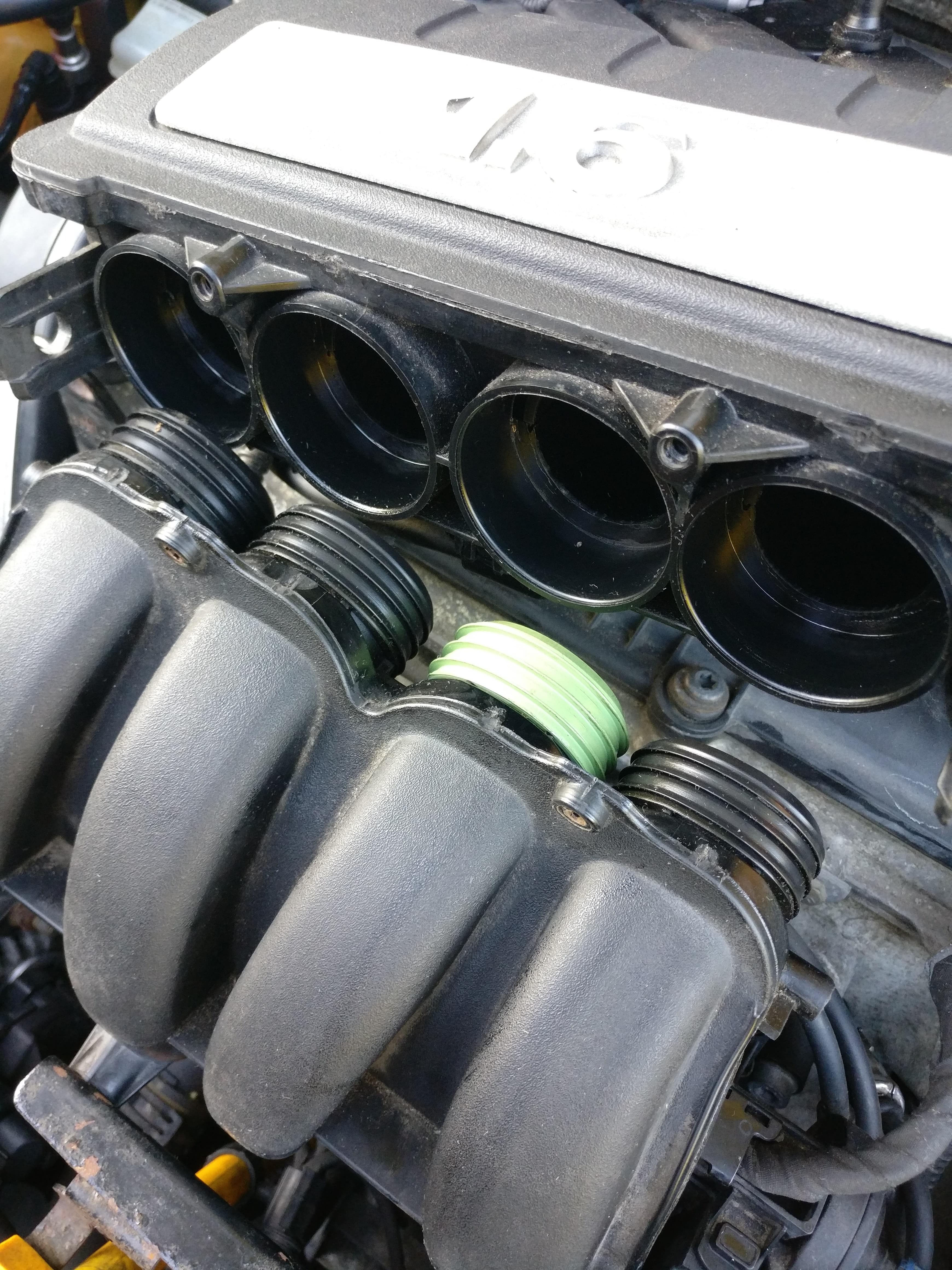

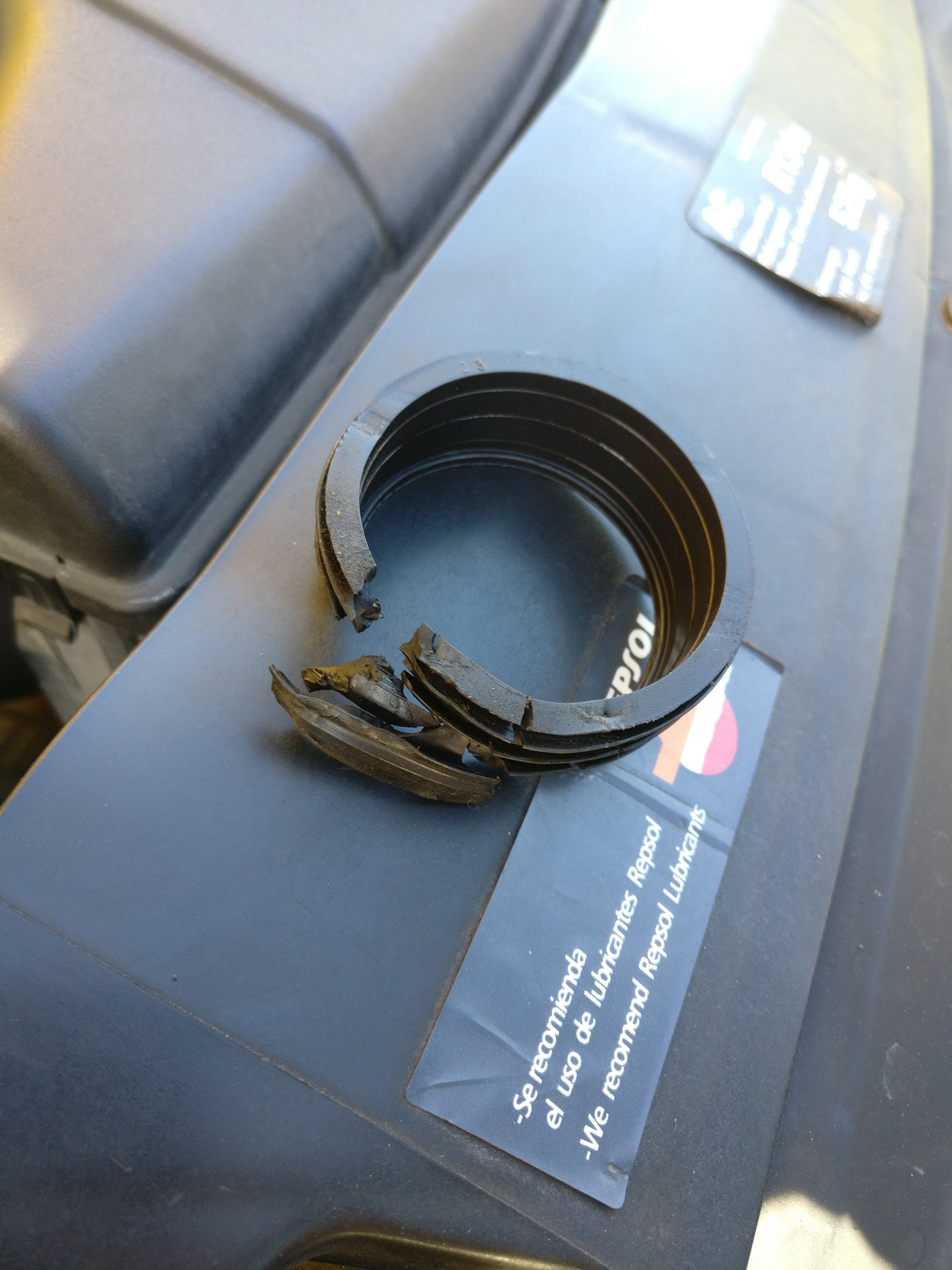

So the problem ended up being a busted intake manifold seal. There's a rubber seal that fits between the two sections of the upper and lower intake. One of those was shredded, possibly from where it was not correctly reassembled last time and got pinched. This was letting in air and causing the rough idle. The part number is 06A 133 227 D (original was B) and costs about £11 each.
Once changed, the car is running better than it has since I bought it. The MAP sensor is now reading about 330mb at idle, well within spec compared to the 470mb before, which was just outside spec but we thought that was ok yesterday (spec was 300-450).
We changed the front lambda sensor (behind the back of the engine on the exhaust manifold), and the ignition coil earlier in our attempts to fix it. Both of these were not strictly necessary for this particular issue but we found the coil needed to be replaced anyway as there was a hairline crack in it and two of the four connections had oxidised, and the lambda was reading an incorrect resistance across two pins compared to the new one I bought so it needed doing too.
We also noticed the bolts holding the throttle body were slightly loose. Tightening them up made a small difference, so check that as well if you are having problems.
Hope this helps anyone in the future.
Added some photos of the old seal and the new replacement.
