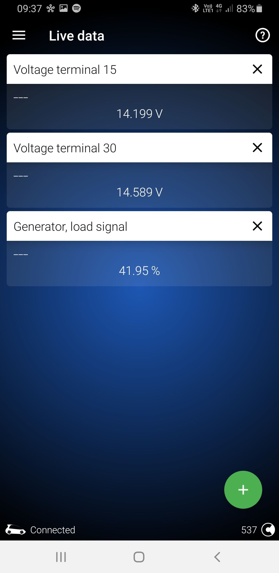

With OBDeleven I monitored the volt with engine running after changing battery:
Module 01 Engine - live data.
Terminal 30 = permanent supply

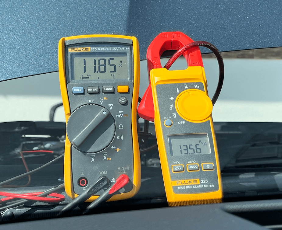

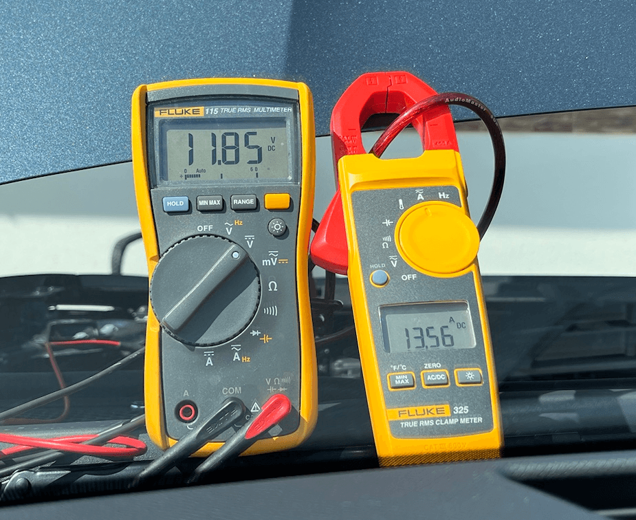

Actually for coding you need more amps than 10. I have MXS 7 and the voltage keeps dropping.
Damn 13.56A !? I didn't expect such a draw on the Formentor. At least with a fully charged battery a 10A supply should sustain it for a few hours to do some work at least.
Otherwise it's going to have to be CTEK Pro25SE which is uncomfortably expensive for a hobbyist. I wouldn't risk it with cheaper non-smart but high amp output chargers out there.

Actually this is pretty good compared to my previos car 20-25A. And yes with Formentor you can code things 1-2 hours with previosly* fully charged battery and connected 10A charger.
