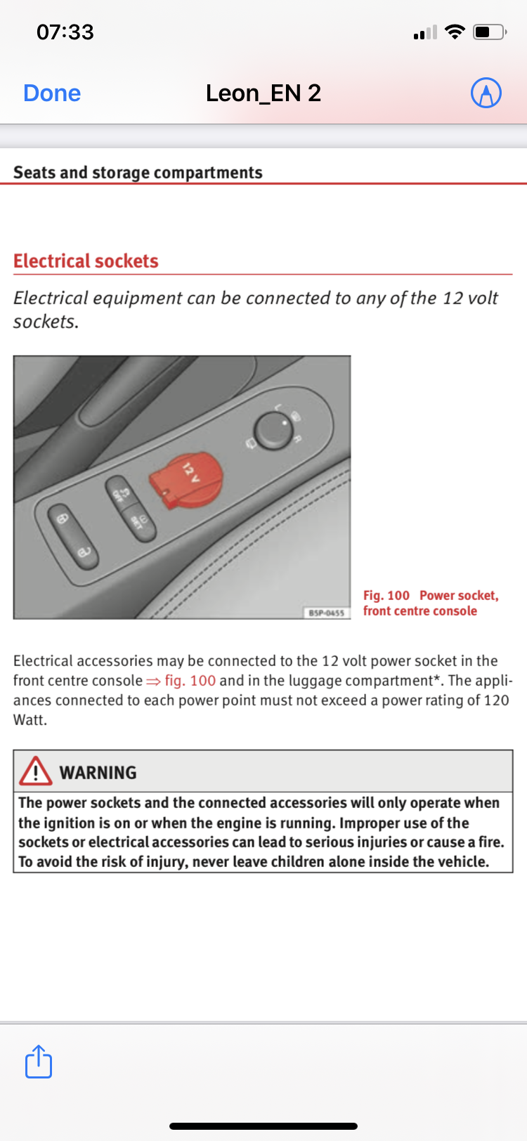

Evening all. I’ve searched but can’t find anything to solve my issue. Had to replace the battery on my 2010 Leon FR yesterday due to it giving up the ghost, since replacing it the 12v lighter socket by the handbrake is now seemingly permanent live. Pretty certain it wasn’t before as upon removing the key my dashcam would power down. Now it’s staying on after removing the key. Can anyone clear this up for me please? Can’t see how putting a new battery on would do this. Thanks in advance, Dave
The manual states that it should only work with the ignition on so I’m baffled

Thanks for the reply. I left my camera unplugged over night just to see if there was a difference, when I plugged it back in without having the key in the ignition there was no power. Put the key in, powered up. Took the key out, powered down. Completely puzzled. Am I going mad? Haha. I’ll try again when I go shopping in a bit.
Yes it is a bit of a puzzle but I think there is a slight delay before it drops out, but my Cam does stay on a few seconds after switching off the ign so you possibly did not leave long enough
