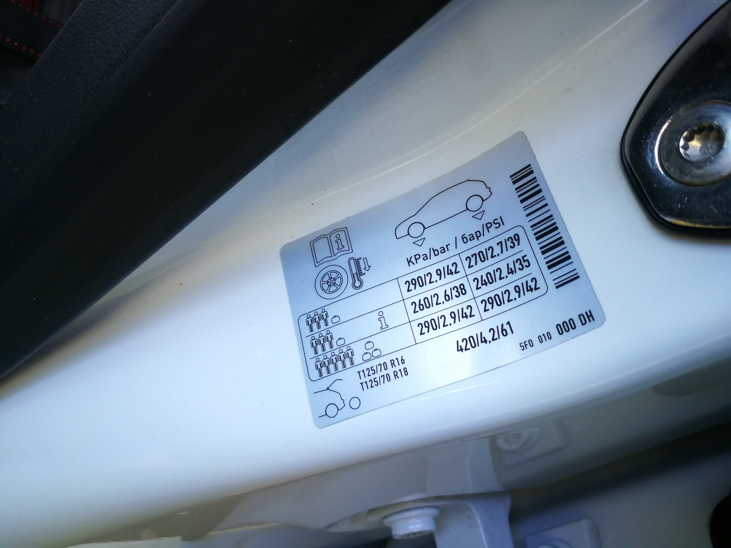

Hello all,
I am happy user of Leon MY2019 - 2.0TSI with DSG. Also i have 18" tires 225/40/R18
In my opinion preasure in my tires showed on sticker is too high. I had before Leon MY14 (17") and it had three sets of preasure - Sport, Comfort, Full load. All of them was more or less stiff.
Problem is that tires (michelin primacy 4) are loudly much more than my old 17" tires. Especially on back.
I found in other topic that people put (for 1.8TSI DSG) preasure F: 32PSI/R: 29PSI for comfort (3 ppl onboard).
Can you recommend me some normal settings? I have strong felling that such high preasure is effect of WLTP and making everything ECO.

I agree with your last comment. I would try running 35 psi all round, that works for me.
I'm not sure that Primacys are the best choice for a 2.0 though, they're biased towards economy and wear rather than grip. If I was you, I'd be looking for something better.

Thanks. To be honest i change it from Bridgestone Potenza which was horrible. loudly like hell. I had Bridgestone in my previous car and it was same problem. Michelin is way more quiet but I'm open for suggestions. I need something quiet and good quality i know that 2.0 TSI is powerful but I'm not using my baby cupra for racing :) Mostly i'm driving inside city and from time to time on highway.
Currently i put 35 PSI on front and 31 on back (hatchback).

I try to set the pressures to those that the tire manufacturer recommends for the specific size on your car. My sticker in the fuel cap says 2.1 bar front, 2.0 bar rear. I roll on Continental PremiumContact 6's, for which Continental recommends 2.5 bar front and 2.3 bar rear, in 225/40 R18, on my car. The pressure in the fuel flap or door is the recommendation for the tires the car was produced with (in my case Bridgestone Potenza's, which have a way stiffer sidewall than Conti's).

Air is 70% nitrogen, so pure Nitrogen will have little efffect in reality. Those pressures look a bit high, my Cupra Ateca on 35 profile 20" tyres has the same recommended settings (42/39) for unladen.

OK that's my bad I presumed it's a cupra maybe not 🙈 in that case the loudness coming from the rear would suggest uneven tyre wear /high and low spots on inner shoulders it's extremely common with primacy tyres... If not then pressure I would put 34psi in those and that would be an optimal all round pressure in my opinion... But I will repeat I don't rate those tyres highly at all and would recommend changing.
