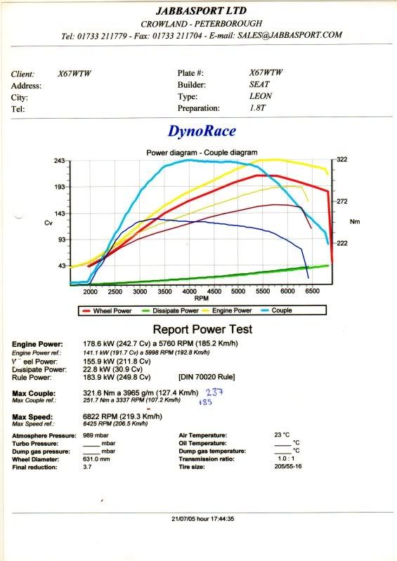

so your 242bhp figure came from getting a custom map with the main modification being a less restrictive downpipe and de/cat or less restrictive 1. the rest of your upgrades probably making a total difference of 10bhp for example as i dont see many 1.8t leon 180 versions getting over 235bhp on a stage 2 so it must be down to your custom map. so your now running at 320bhp ;) may i ask what upgrades your running to get that figure? did you upgrade the rods? i only ask so many questions about you ride as it gives me lots of hope for the potential of these lovely engines.

I'll try and find my 242 print out later
