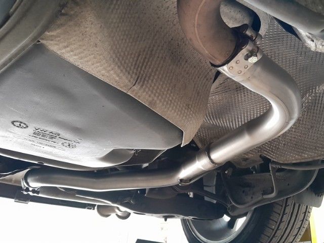

Hi there everyone, just joined but looked at site since 2018,I have a 2019 FR Sport 190 DSG
In reply to hniz re exhaust mods I have removed backbox and next box so still have GPF and resonator fitted,car has deeper sound but still not loud but my god does it go a lot better without all those restrictions, I have Revo stage 1 and Revo airbox system with about 240+ BHP on 95 octane and it is amazing, still gets 50+mpg on motorway, hope this helps
Here are pictures of mods
