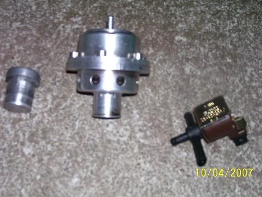

went out there and removed the after market valve, reconnected it the way you described, its ran **** before, now it runs even worse..
chances are that the standard dv is whats muckin the boost up?? will try replacing the standard with the aftermarket tomorrow and see if there is any difference.
Is the standard one ment to make fluttery sounds?

ah top job peter. will do that with it now. went out there and switched the dv`s round, but dont know what to do with the connection coming off the charge pipe??
Have the standard dv back on now, the dv itself is working fine as is the other, everything plumbed back to way it should be but now the power has dropped even more, stuttering and haggling on and off constantly, you cant give it any serious throttle or it just burbbles along at the same speed, like its choking its self?? I have replaced the N75, plugs, cant get the dam Vag-com to talk to the car to do any logs neither... Any ideas? Coil pack? this is really starting to crack me up something serious , F***in cars!!!

that is the new N75 J valve I bought for the car but removed it again as it has made no difference what-so-ever
