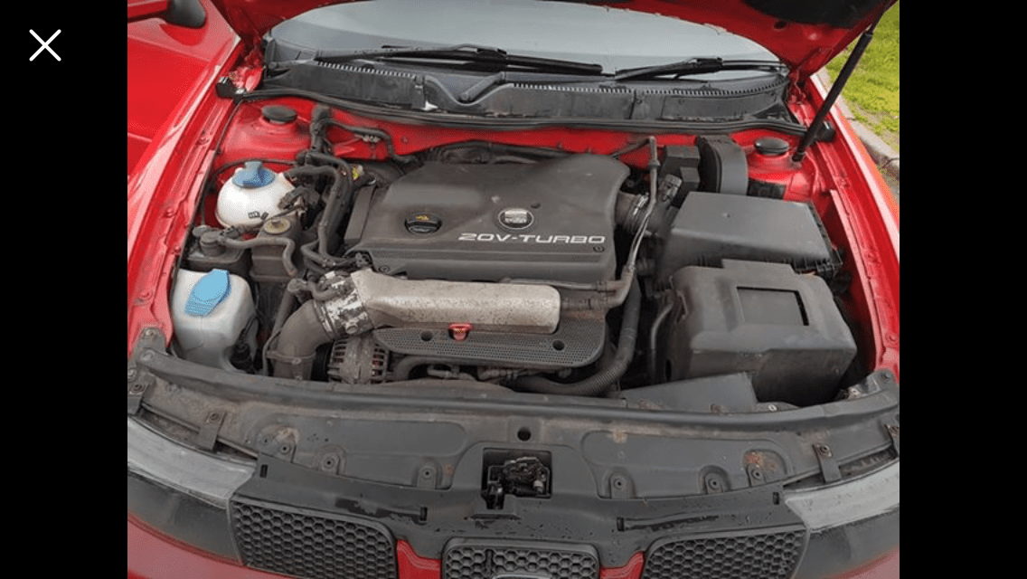

Fault code p2138 Throttle/pedal position sensor/switch D/E voltage correlation (confirmed DTC).
After goggling fault code it relays to opening and closing of throttle ,after going bk to look at ad pics the outside of the throttle body is stinking ,let’s hope a good clean will resolve this if not onto pedal sensor !!.
