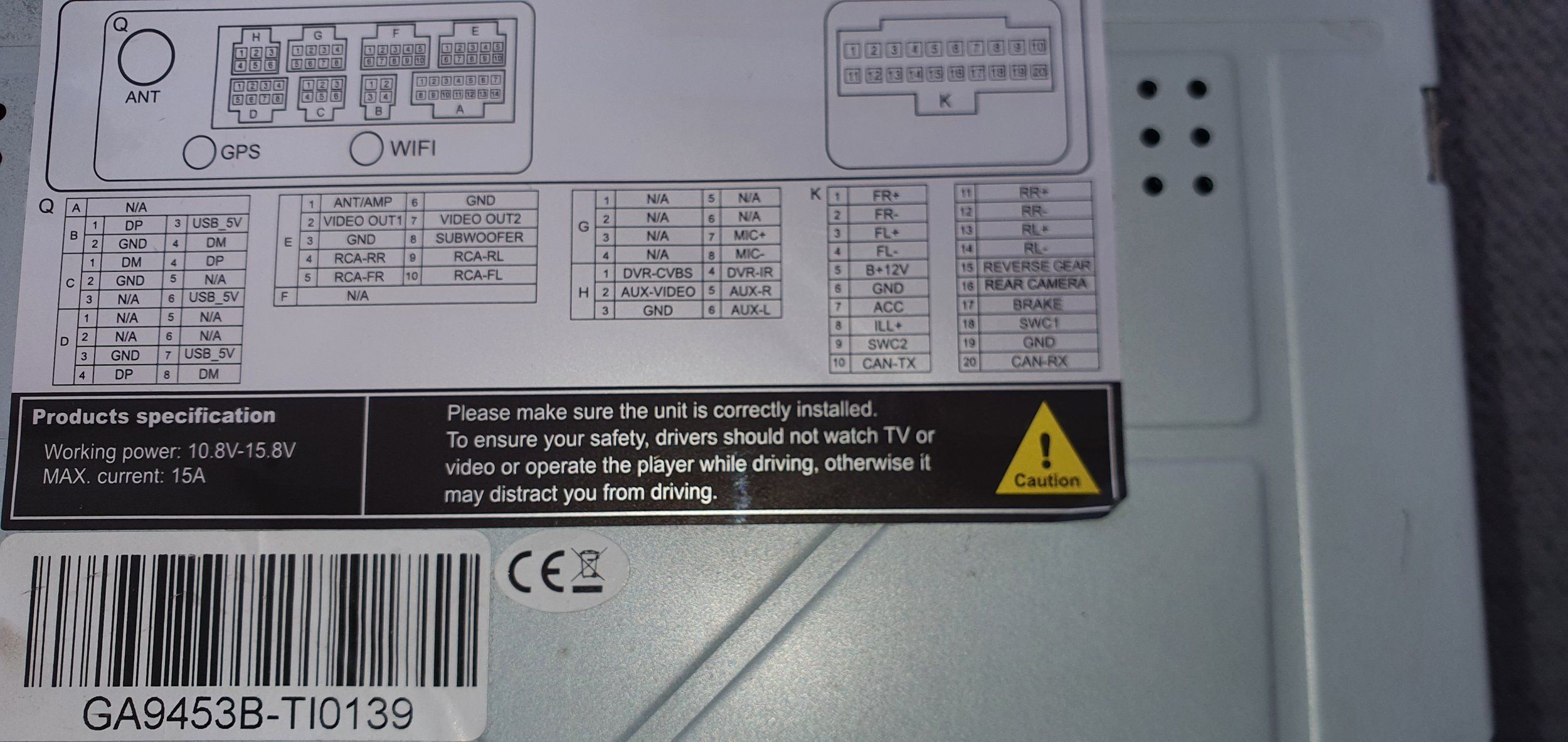

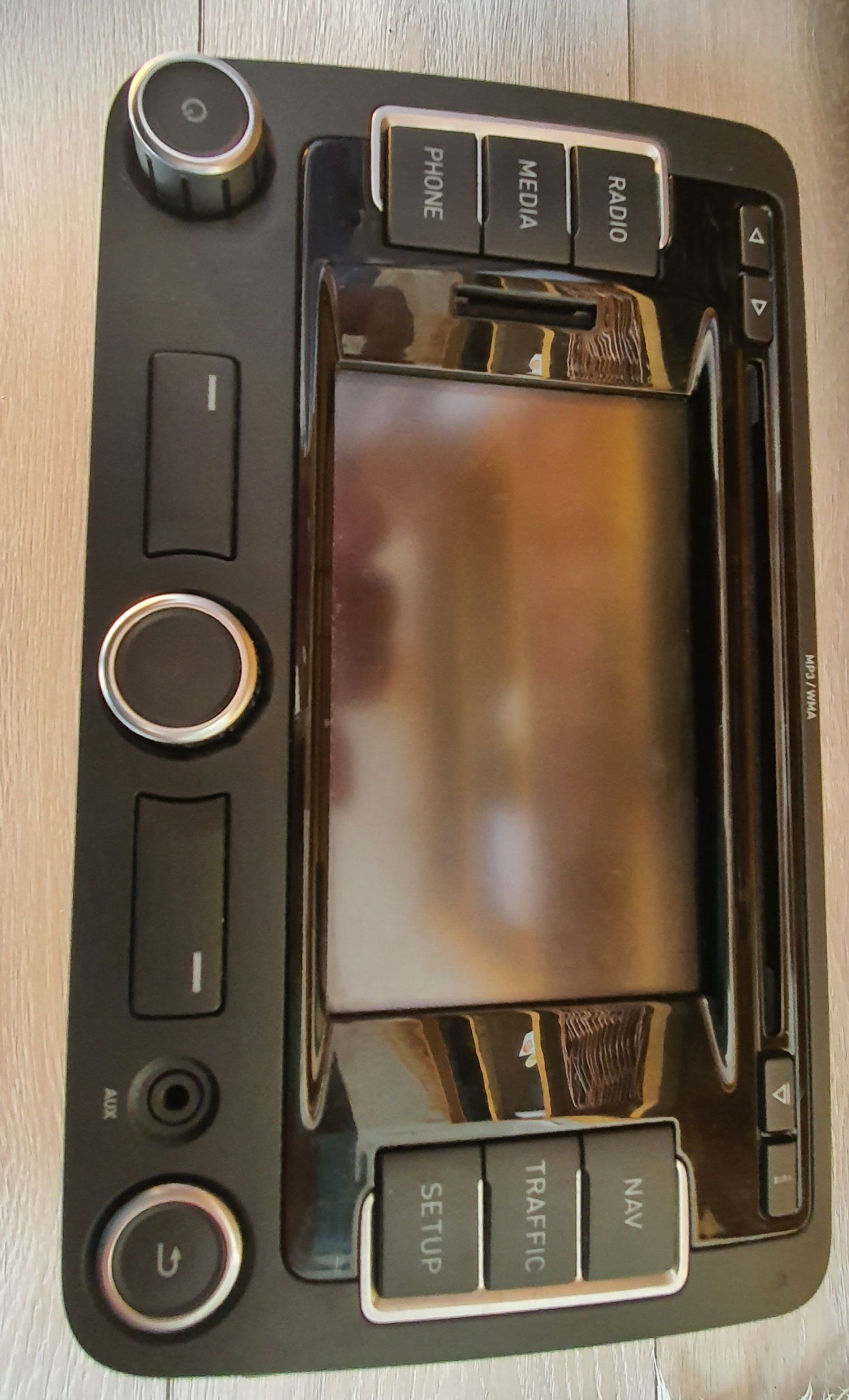

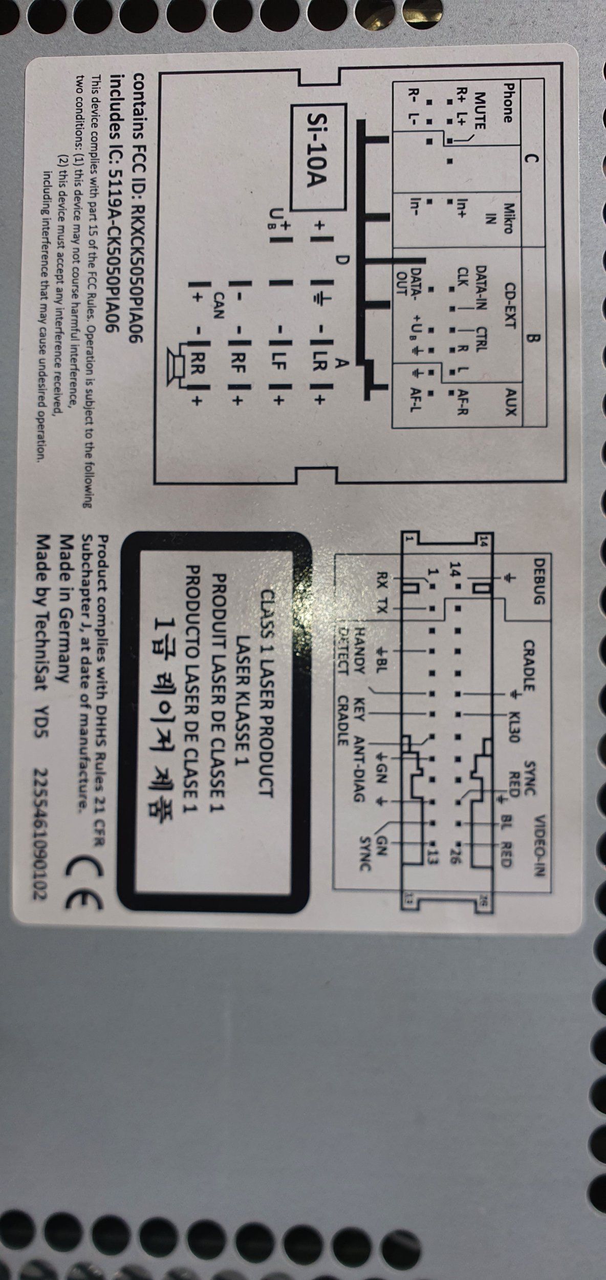

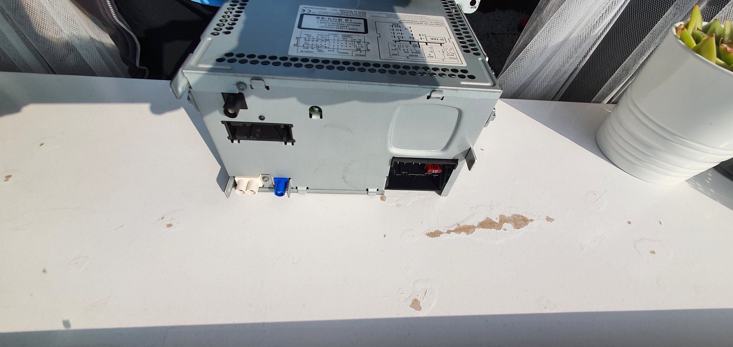

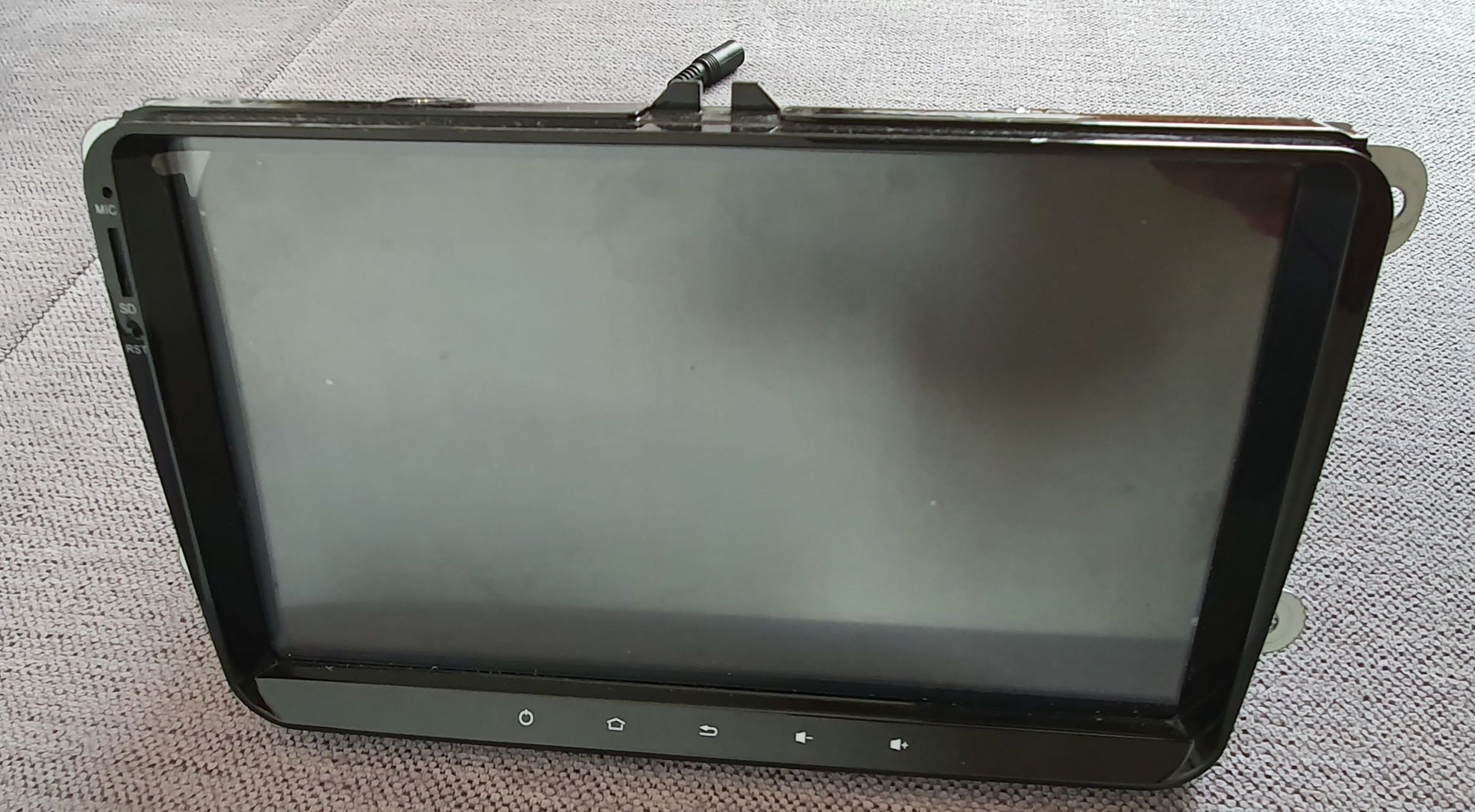

I am in a process of swapping my stock sat nav unit (pictures below)
to aftermarket Eonon android unit (pictures below).

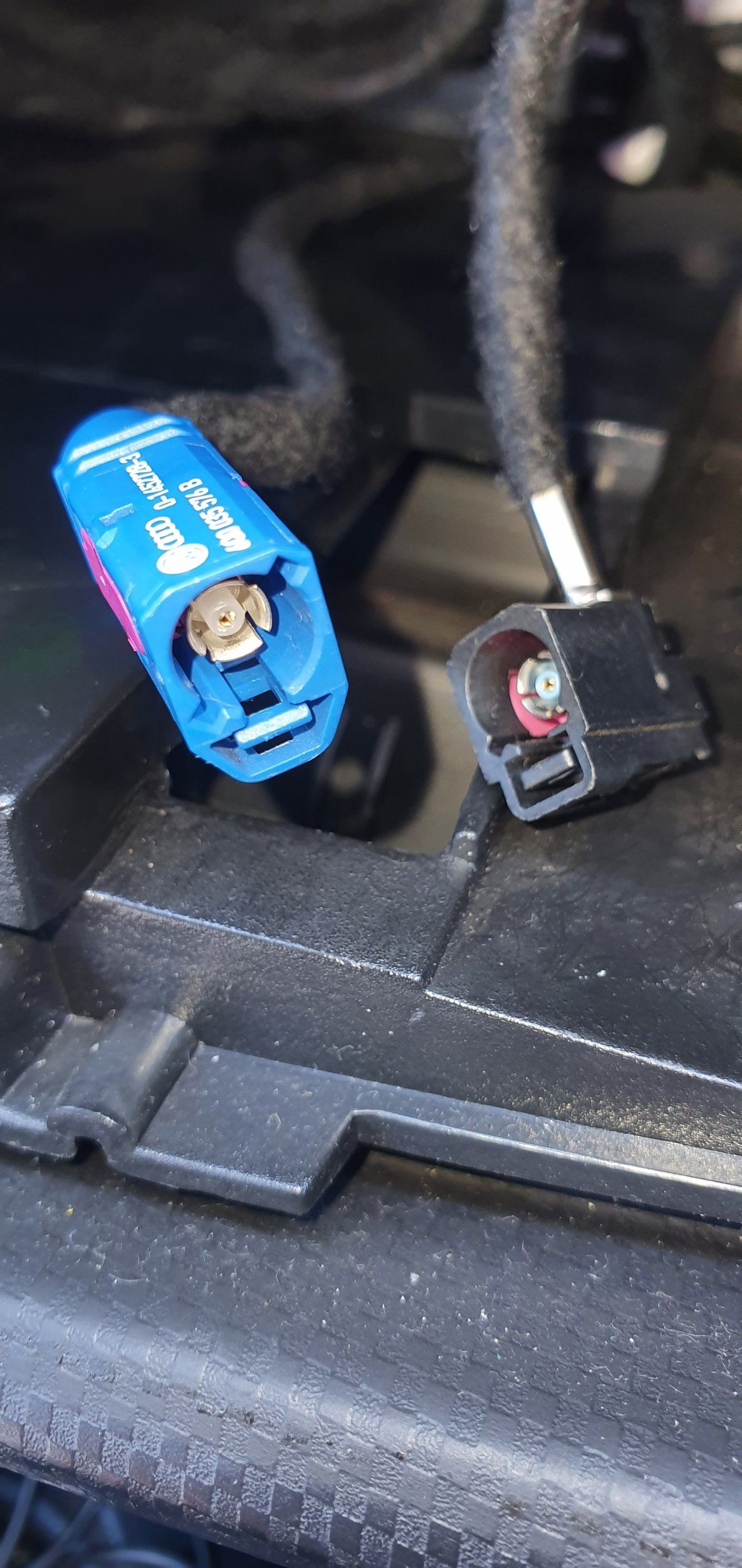

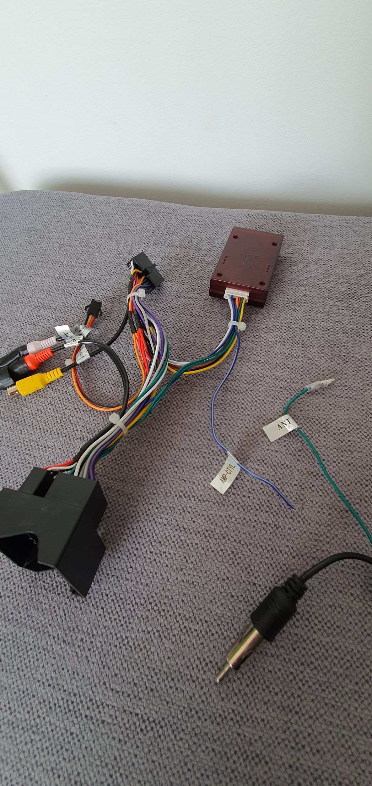

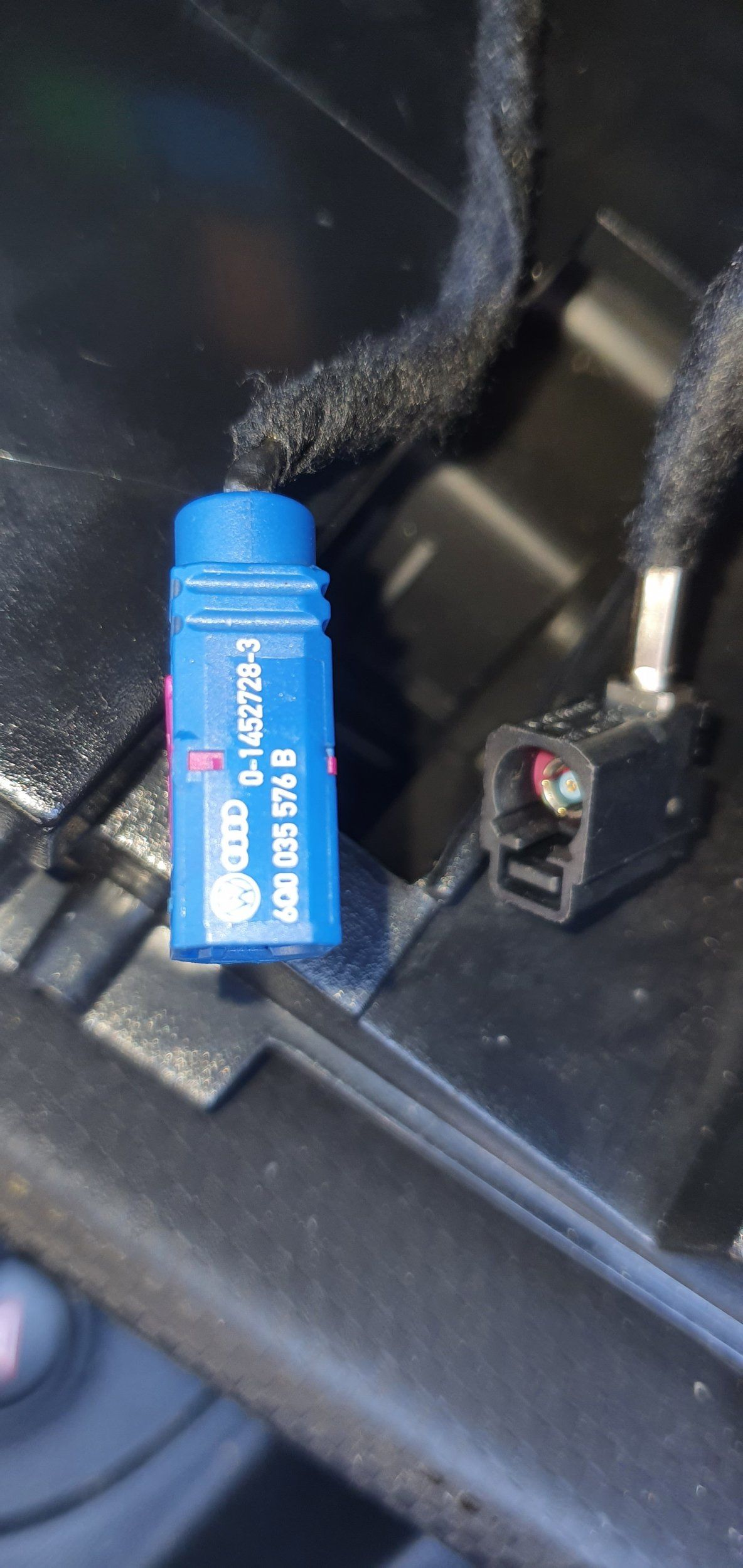

After connecting the wiring harness all works fine but there is no sound from the speakers. My main concern is the blue wire(picture below) labelled AMP-CTYL and green wire(picture below) labelled ANT. I am not sure where to connect them to. Also after disconnecting stock head unit there is two cables, one with blue and one with black plug (pictures below). I don't know where to connect those aswell. There is no sockets in new unit to plug them in.
Below all the pictures to show what I am on about.
I hope someone knows how to resolve that issue or have any knowledge/ideas?
Any help appreciated.

Hi lutek1000.
I may be wrong but on most aftermarket head units I have come across the single blue wire is usually used to signal an aftermarket amplifier to turn on, for a subwoofer for example.
The blue and black connectors look like antenna connectors to me, without those connected I would guess the radio will not work. One could also run a factory amplifier (if your car has one) and that could explain the lack of sound?
If there is nowhere to connect them it may be possible the supplied loom is not correct for your car.
