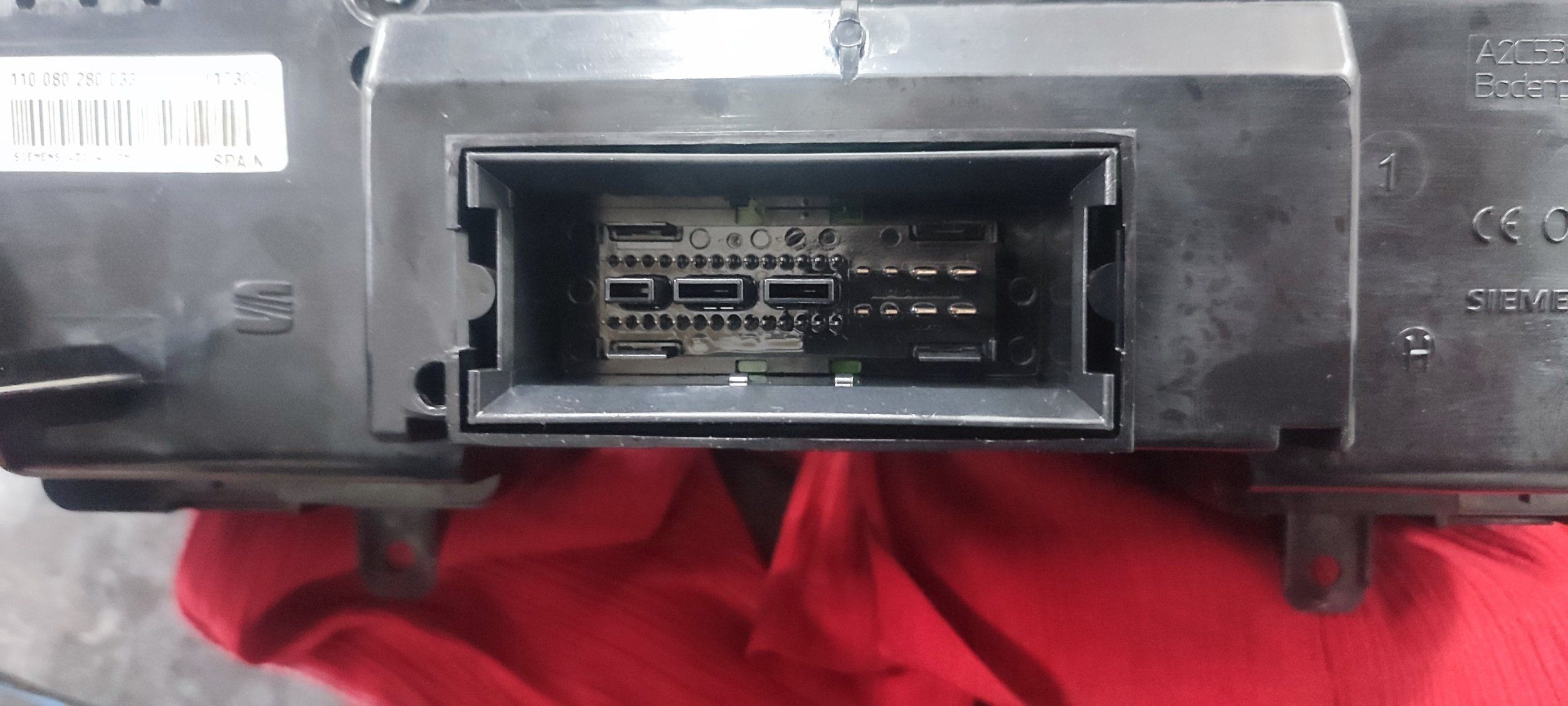

Hello everyone, I'm a new member, and I hope I can find a solution to my problem. Everything was fine until today, but suddenly the power supply to the dashboard went out, the car started for a short time and then turned off, the media works as well as other functions, but nothing lights up on the dashboard. I tried with ODIS S diagnostics but it won't connect to the dashboard. I didn't take pictures of the errors. I checked the F6 fuse which is for the dashboard but it's ok, the ground around the battery is good, there's no oxidation, can you give me some guidance on what else I should check. Thanks.
I removed the board, does anyone have the pinout of the wires?
