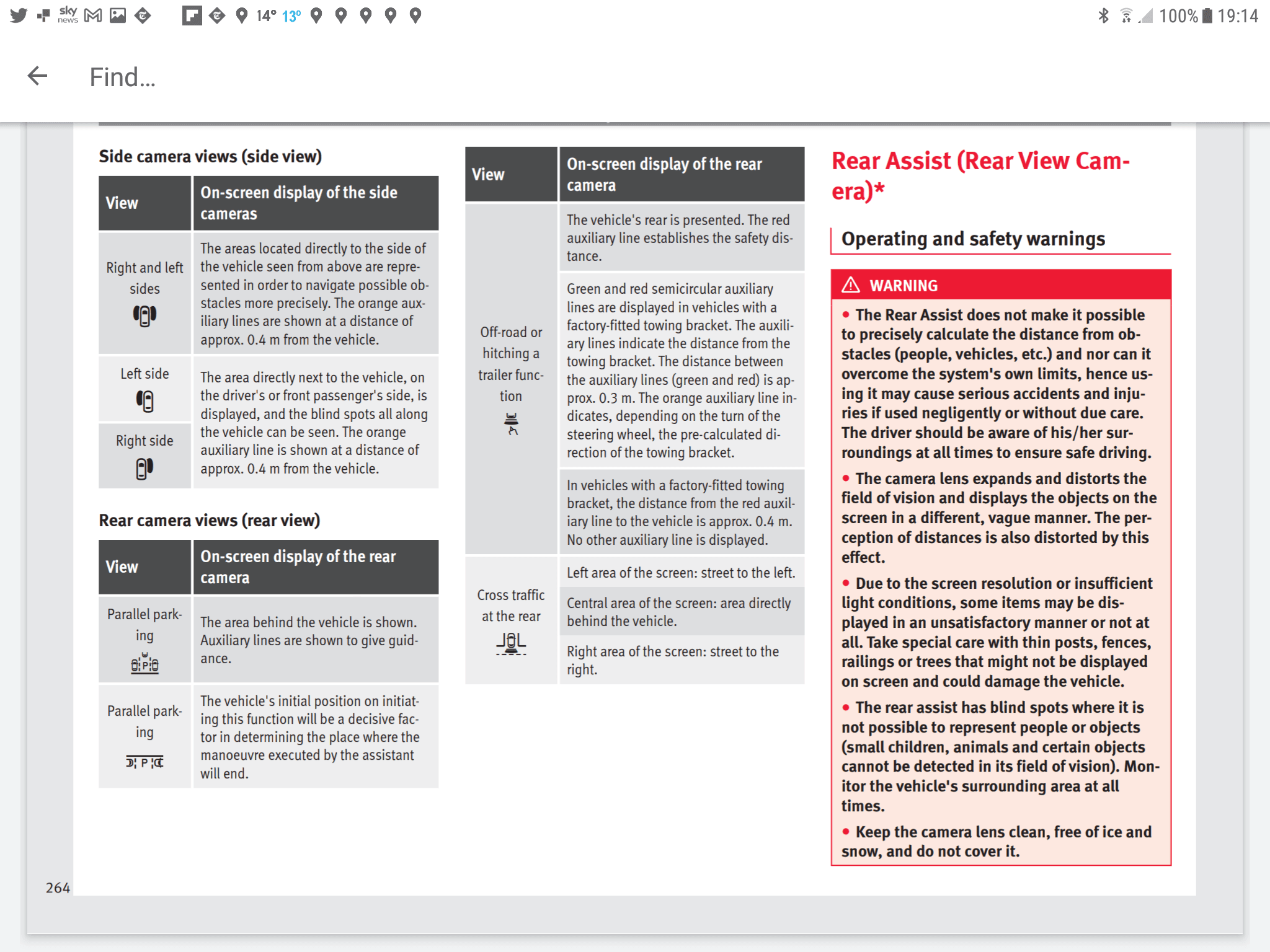

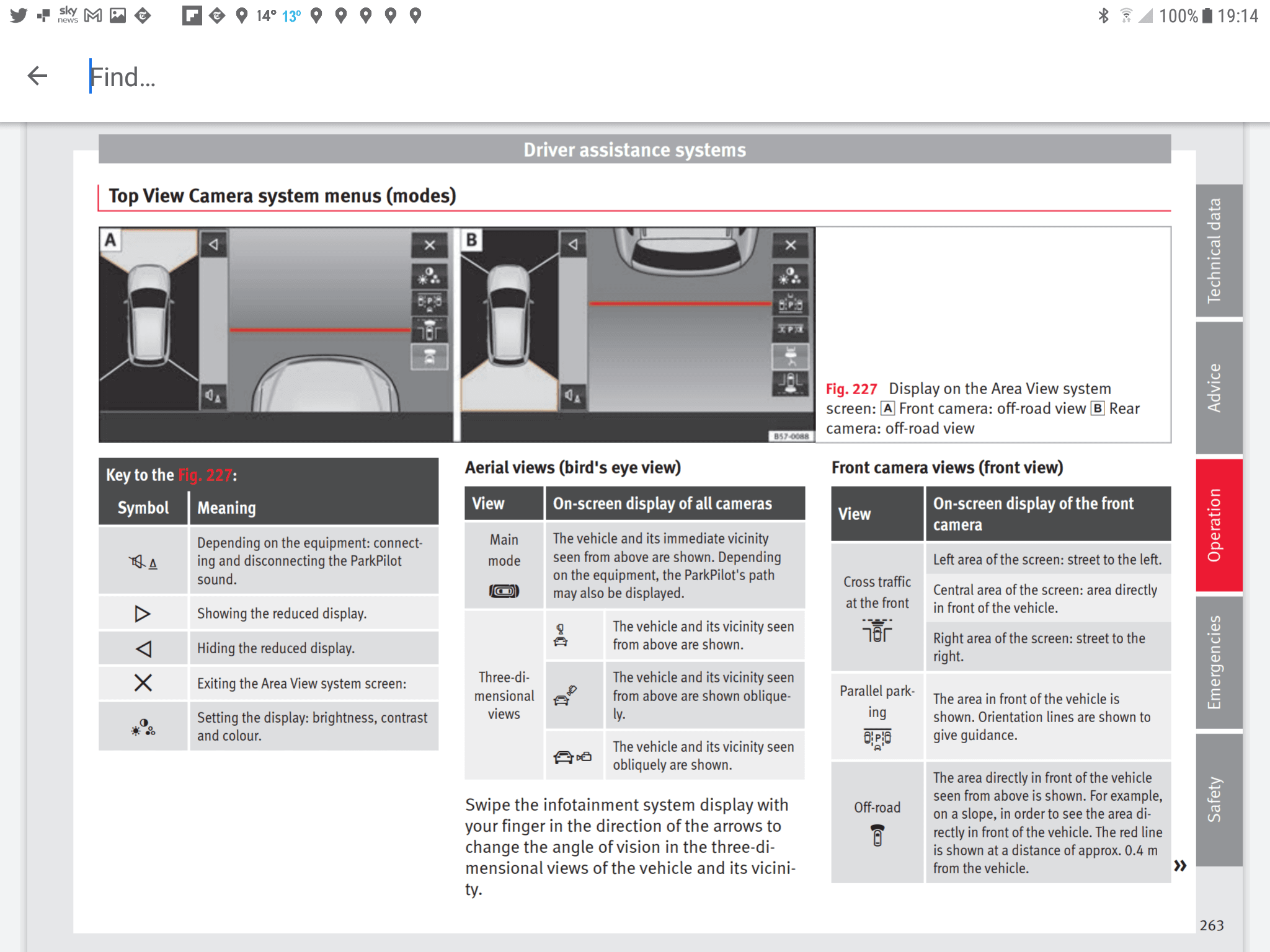

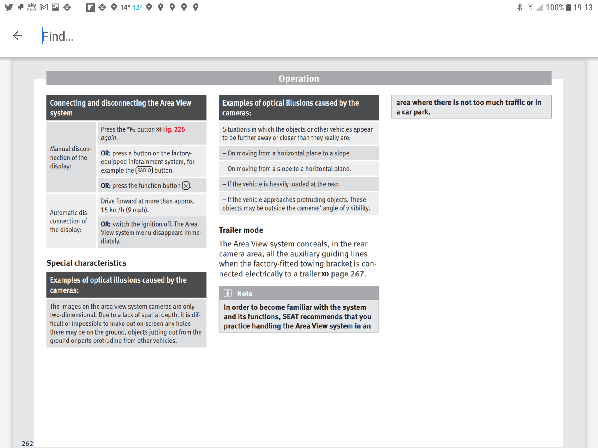

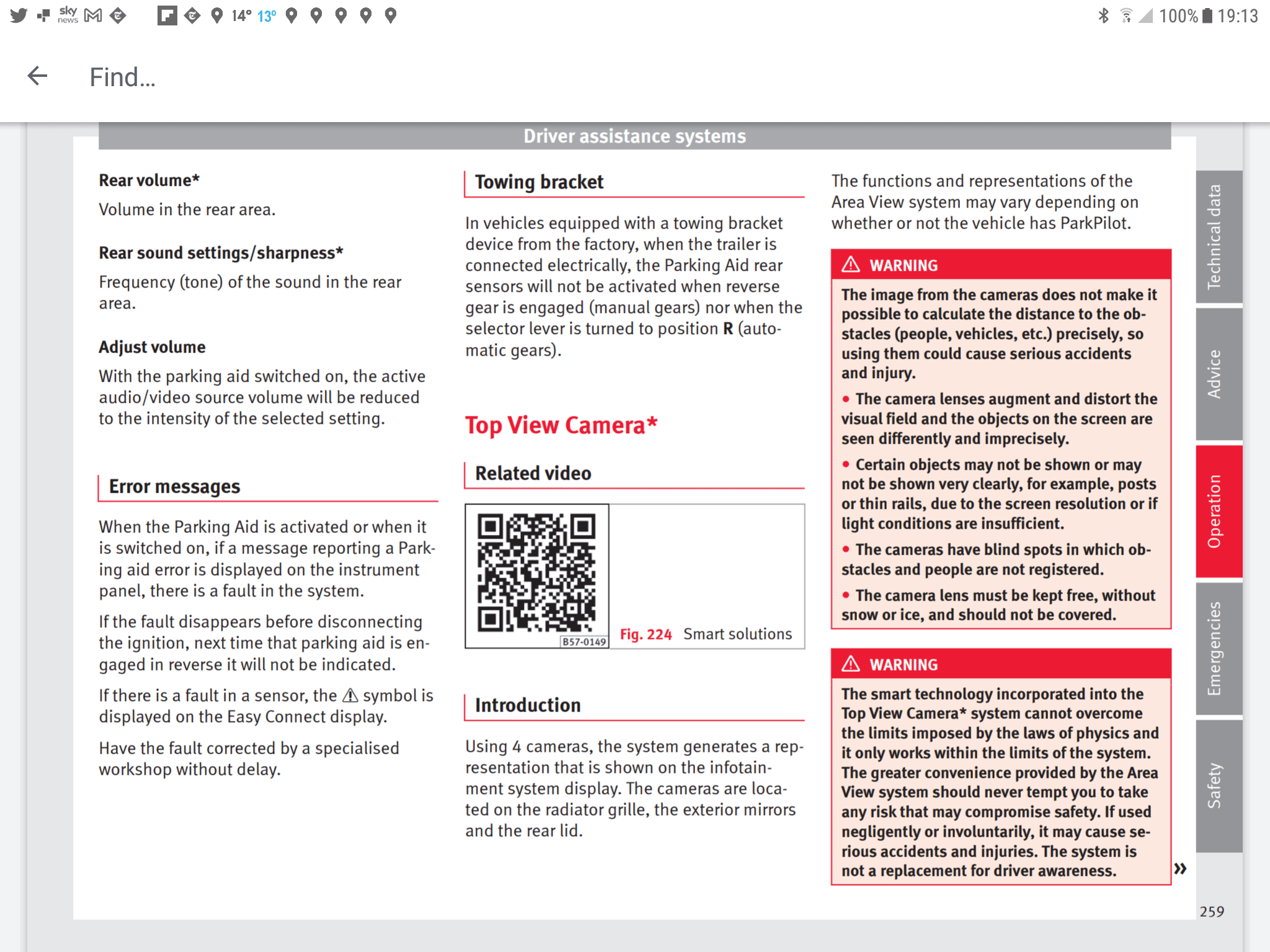

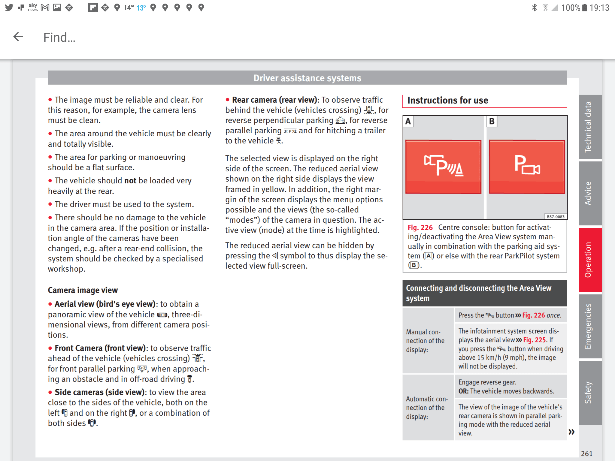

Well these pages should be good for you if you have my19 with top view as Seat call it. On my tablet away... Let you reassemble the pages in the correct order. That's how you fumble the Top View cameras prior to the facelift. Pages from the Ateca manual.

Thanks for the pic's Tell, I have these in my manual only issue is when you expand the view you only see the nsf wheel & 1/2 of the front passenger door, maybe helpful if you drive in forwards (who does that) no good when reversing
