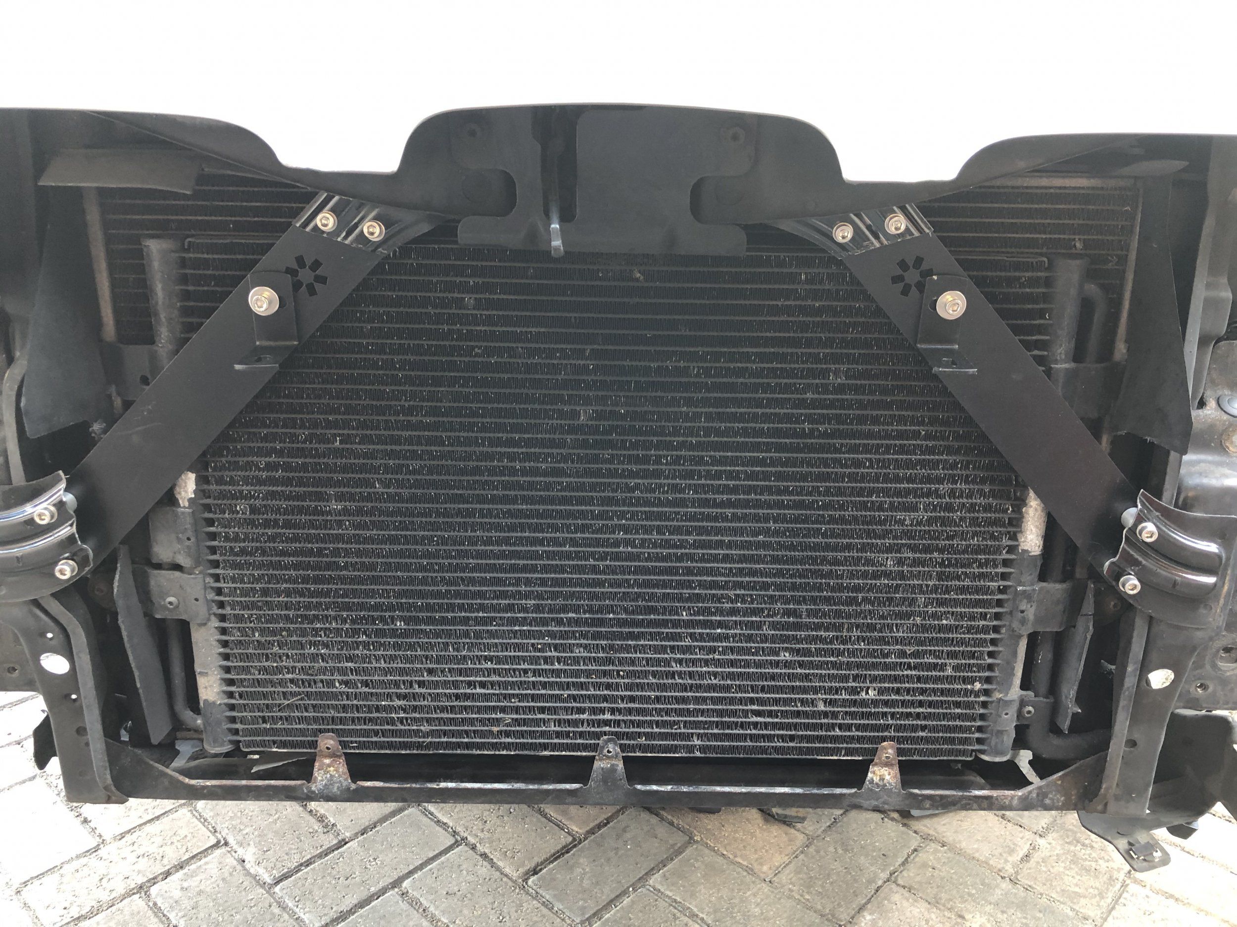

Condenser replacement – can it be removed from the front? I’m assuming yes based on an old photo I have from when I fitted an Airtec.
Question – should I go all out and replace the radiator whilst I have the opportunity?? Again, does this remove from the front (after the condenser) or does the whole front slam panel need to be removed from the car?

With that said it might be possible with the Airtec braces removed but can't say I've ever tried as I'm generally just ripping them apart so I'd always drop the entire front end.

Slam panel off to remove rad pack unfortunately mate.

I mean, if the front bumper and intercooler is off, how much of a headache is it to remove the slam panel? Car isn’t a daily, so I can afford to take my time.
Thai-wronghorse
Dec 3, 2015
2,199
1,038
Kent
In all honesty it's very simple to remove.
Bumper off
Drain coolant from the lower radiator valve
Disconnect bonnet release cable
Crash bar off
Headlights out
Few bolts to chassis legs
4x bolts onto wing supports.
2x coolant hoses and a few plugs disconnect.
Unscrew auxiliary water pump from fan cowling.
Slam panel can now be pulled forward and can decide how you'd like to evacuate the AC system
