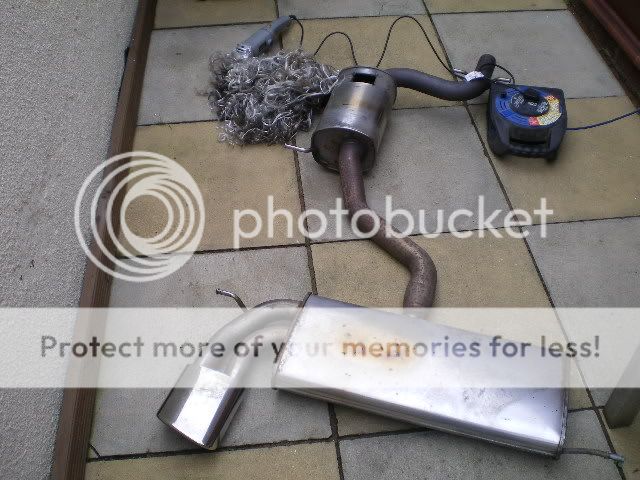

jon-tfsi
Mar 29, 2008
277
A Cupra exhaust with the same narrowing just before the back box
Two std downpipes. One with the restrictive pre-cat, another with the cat removed .. . . .
