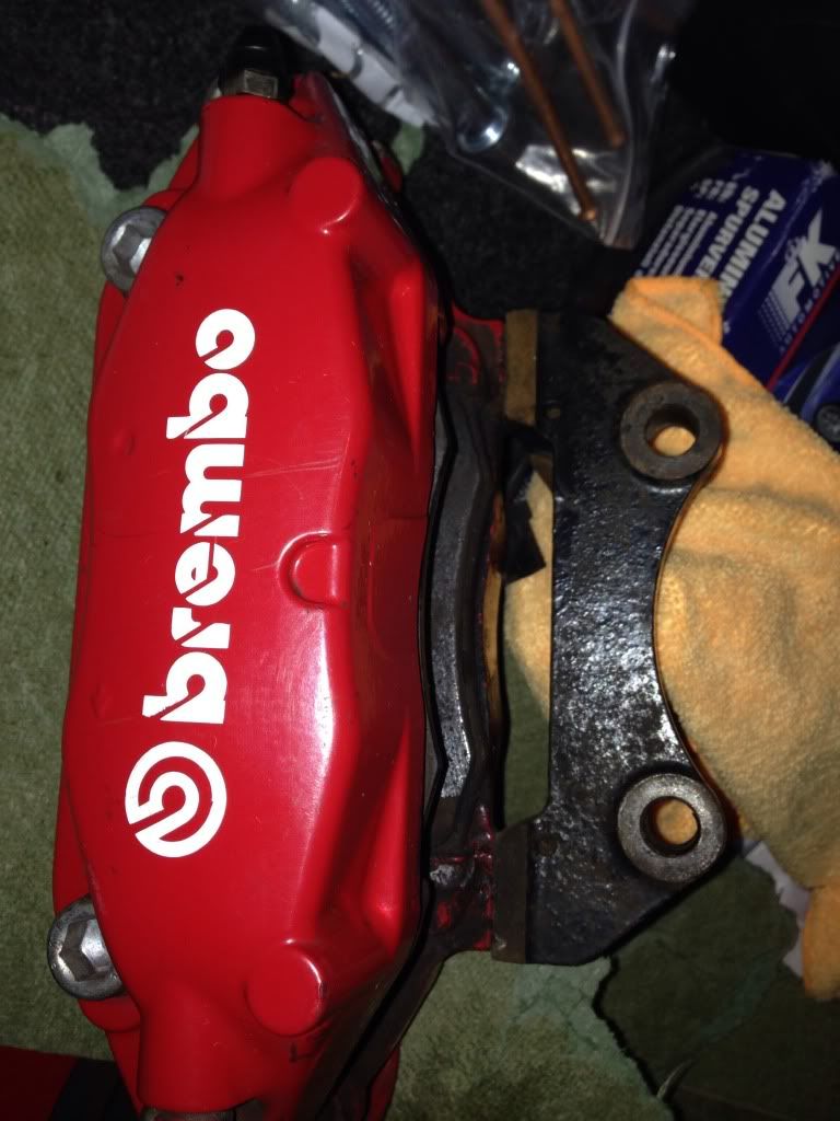

But here's the rub, the carriers look to be originals.
So my question to any of you that know these brakes is, do you guys think these carriers look original or have they been modified? Can these calipers be used with 312mm discs on std LCR Brembo carriers?
I need to know as I have received the calipers with 312 discs and OE pads but I intend to replace these and need to know what to get. The 312's have been painted where the pad isn't being swept and you can see the disc face closest to the hub has a section that is not getting pad contact.

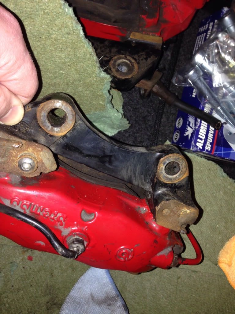

Just wanting to know if the carriers look original to folks
they are standard carriers but may have been machined down on the mounting face to bring the caliper closer to the hub to run the smaller disc
If they had been machined down, they would sweep the full face of the 312. Since he says they don't, I'd say its safe to assume they haven't been machined

The pads are definitely leaving a decent portion of unswept pad on the 312's, very obvious as they have been painted red up to the unswept edge. Curiously if you offer up the discs to the caliper, the pad does however look to clamp with the full pad face to the outside edge of the disc. I think the crux of the matter is that the 323mm disc is only going to protrude 0.55cm more each side of the hub than the 323 but the discs shape is different and the correct one for the caliper.
Between you top people and some help from guys on Brisky I am now 99.5% convinced these are standard carriers.
Researching lots of images it looks like at somepoint the carriers were revised and some have a more rounded design than mine have but it's safe to get some 323mm discs ordered up. Looking at EBC Ultimax lightly slotted performance discs and a toss up between DS2500's Yellowstuff and M1144 pads to go together with them.

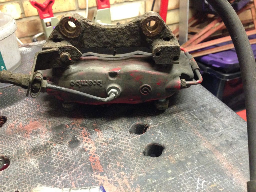

Here'sa slightyl grubby pic sent from someone very helpful of their carriers
