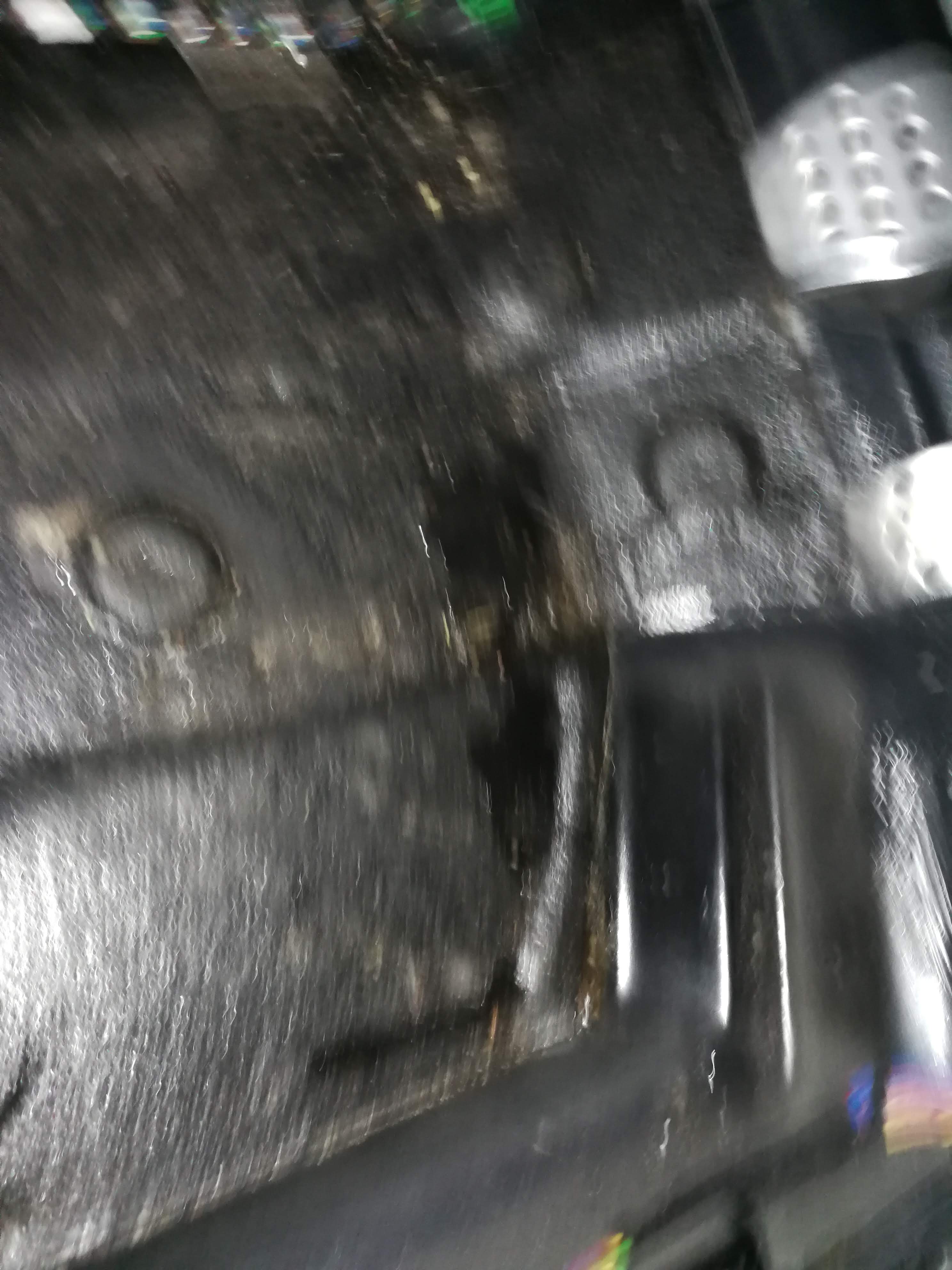

So i'm not sure if this helps (I only remembered to take pic's after I started mopping up)
Could be the windscreen seal? Has it been replaced recently?
Have you tried laying kitchen towel against the firewall up behind then pedals as high as you can go and then use a jet wash or hose over the roof windscreen and scuttle. The water should show its path on the kitchen towel so you can see the general area.
Have you also checked under the plastic scuttle panel on the drivers side where the loom goes through a plastic panel? That may be leaking.
Windscreen original fitment, no will try kitchen towel when it warms up a bit. I have literally 5 layers of super sticky butyl rubber around that box , next i'm gonna silicon the fcuk out of it.
