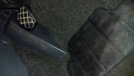

I've a leak in my Ibiza when it rains heavy I've a damp patch Right in the middle below the pedal of the front driver side footwell Dry everywhere else tho but wet in the middle just can't see any drips as looks like its coming in from behind the carpet it's bound to be coming from Under the scutter pannel somewhere are bulkhead any ideas

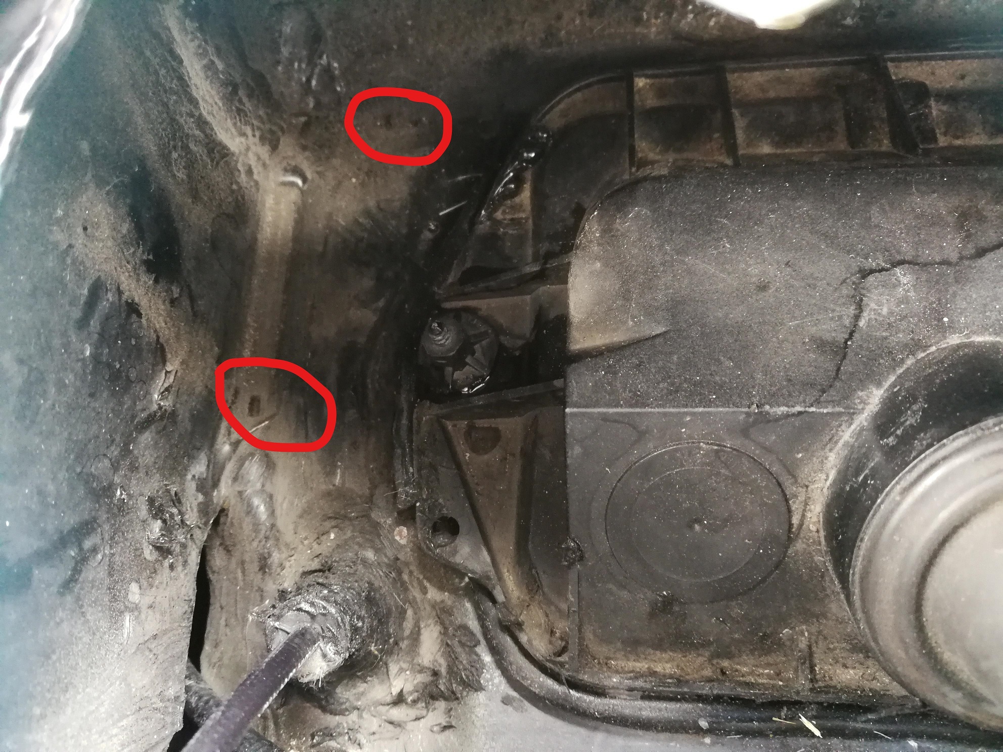

So I found the the following holes on the left (drivers side), they dont look like much in the photo but with all the gunk removed you could get a pipe cleaner through them.

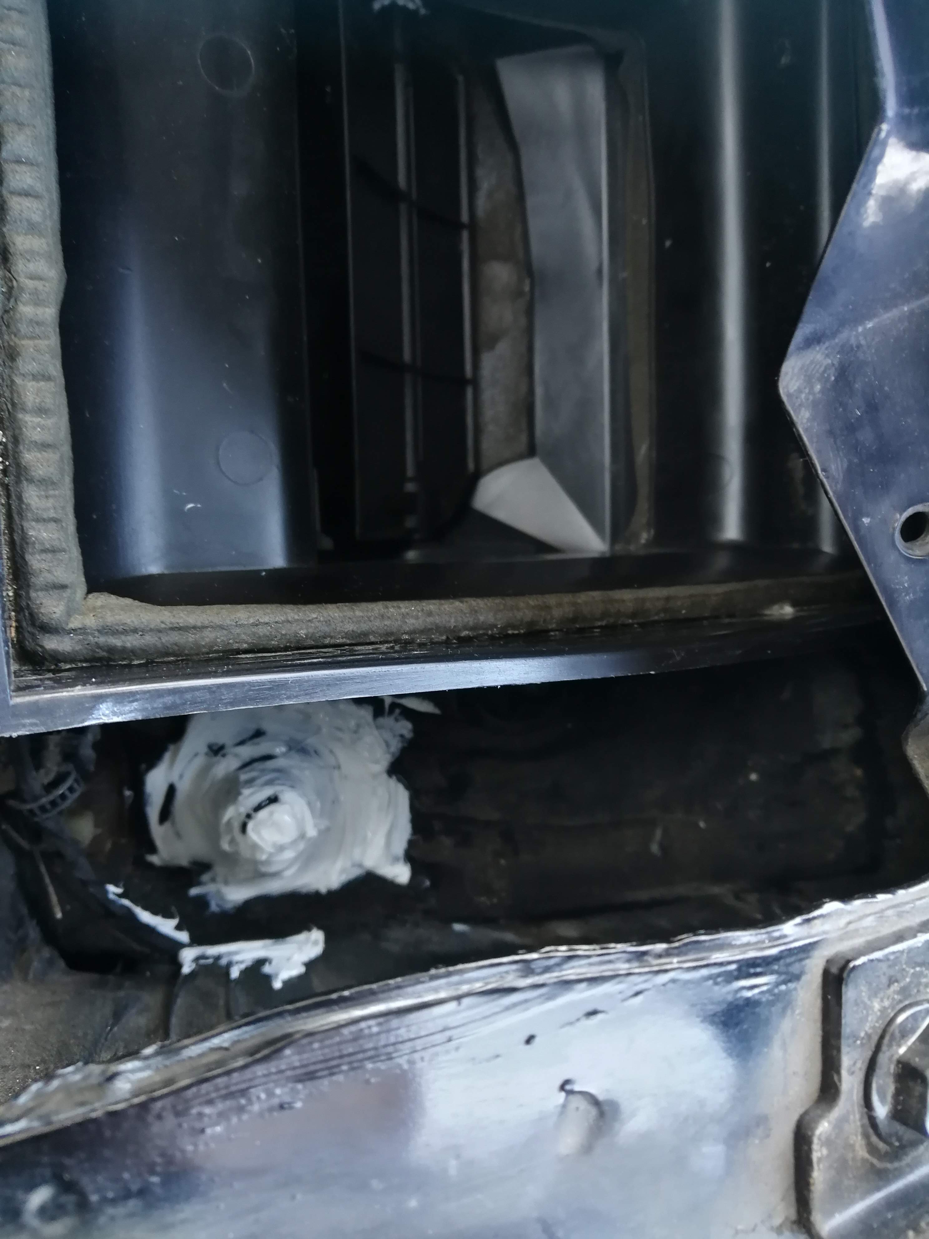

Then found this on the right side , it was rotten and falling apart

Yes and directly above the area in your first photo and right under the hinge is another dodgy area. Dig out any old sealant and redo.
The high up leak distributes water through various seams and exits some way to either side.

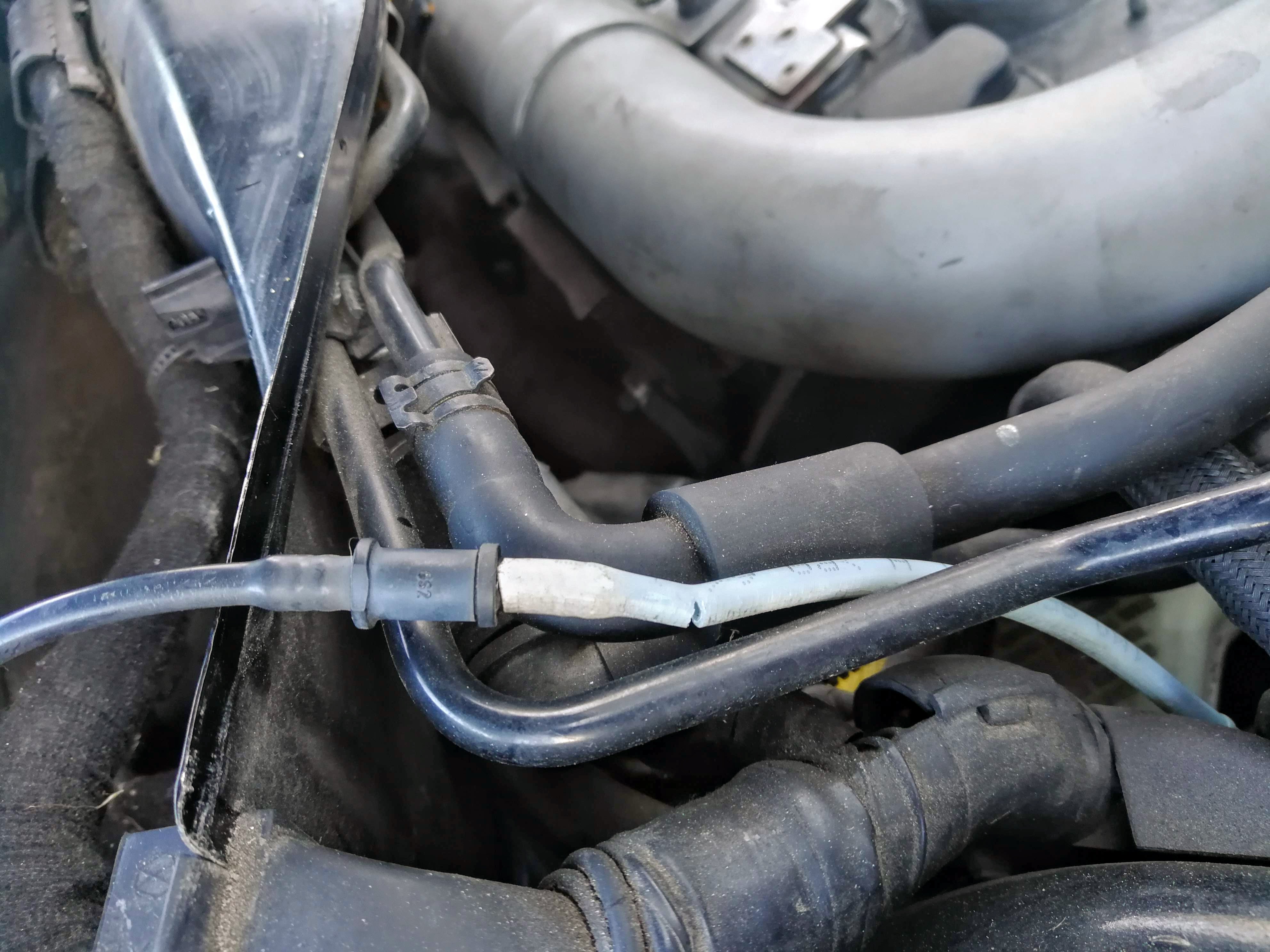

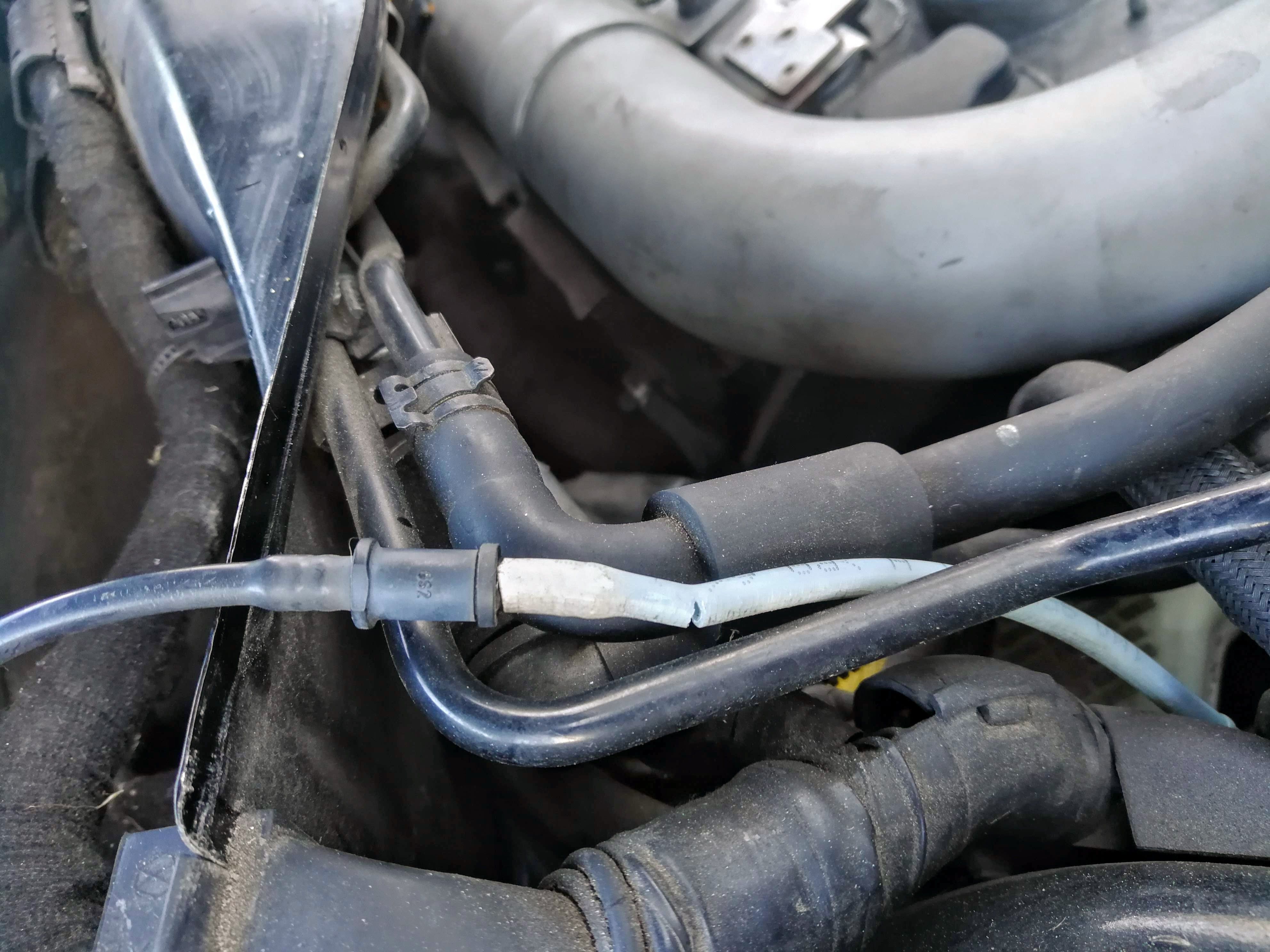

I know the rear washer hose is a common issues but a wonder if the leak would still come even if you stopped using the rear wiper? I've a leak in mine but with rain it still leaked in same place middle drivers footwell Dry every else just damp patch in middle then rest boot had water coming in somewhere from the rear drivers side gonna try an seal the leak if I can find it. Wbu have u had the same

When I use my rear washer it causes a leak under the drivers footwell As There's a few breaks in the plastic pipe but I'm getting it 're piped But I've noticed when it rains heavy it forms a damp patch right in the middle of the footwell

That picture is due to the rain tho I can't see any leaks just appears as damp patch so it's probably under the scuttle pannel somewhere leaking in under the carpet
