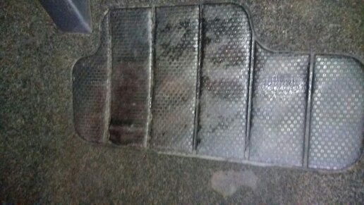

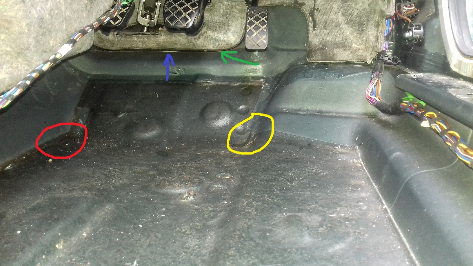

The first photo shows where the water is appearing on mine. There is water on the ledge indicated by the green arrow, I haven't been able to figure out where it's coming from to get to here, but hoping it's from under the scuttle panel, either cable box or the bonnet cable grommet (second picture).
The water also seems to emerge at the red circle. I can't see it flow to this point, so it must be flowing under the reinforcing panel, perhaps from the ledge above it (green arrow).
The water at the yellow circle is from when I was cleaning out under the scuttle panel today, around the bonnet cable grommet, and along the channel on the bulkhead, down towards the exit over the wheel arch. I can see it coming down a white plastic "chute" up behind the instrument panel. I am going to try silicone around the grommet today, both at the base, and also up where the cable enters the grommet; I did around the cable box beside it last week.
I don't think there are any other holes or cracks in this area that might let water into the cabin, unless it is leaking along the seam below the grommet and cable box. I'd say that's less likely, but I've seen other posts indicating that the bulkhead seam needed to be done, and I'm presuming they meant this seam.
The blue arrow just points to the rubber bung on the ledge. I'm curious as to why this is here. There seems to be a channel down in it.

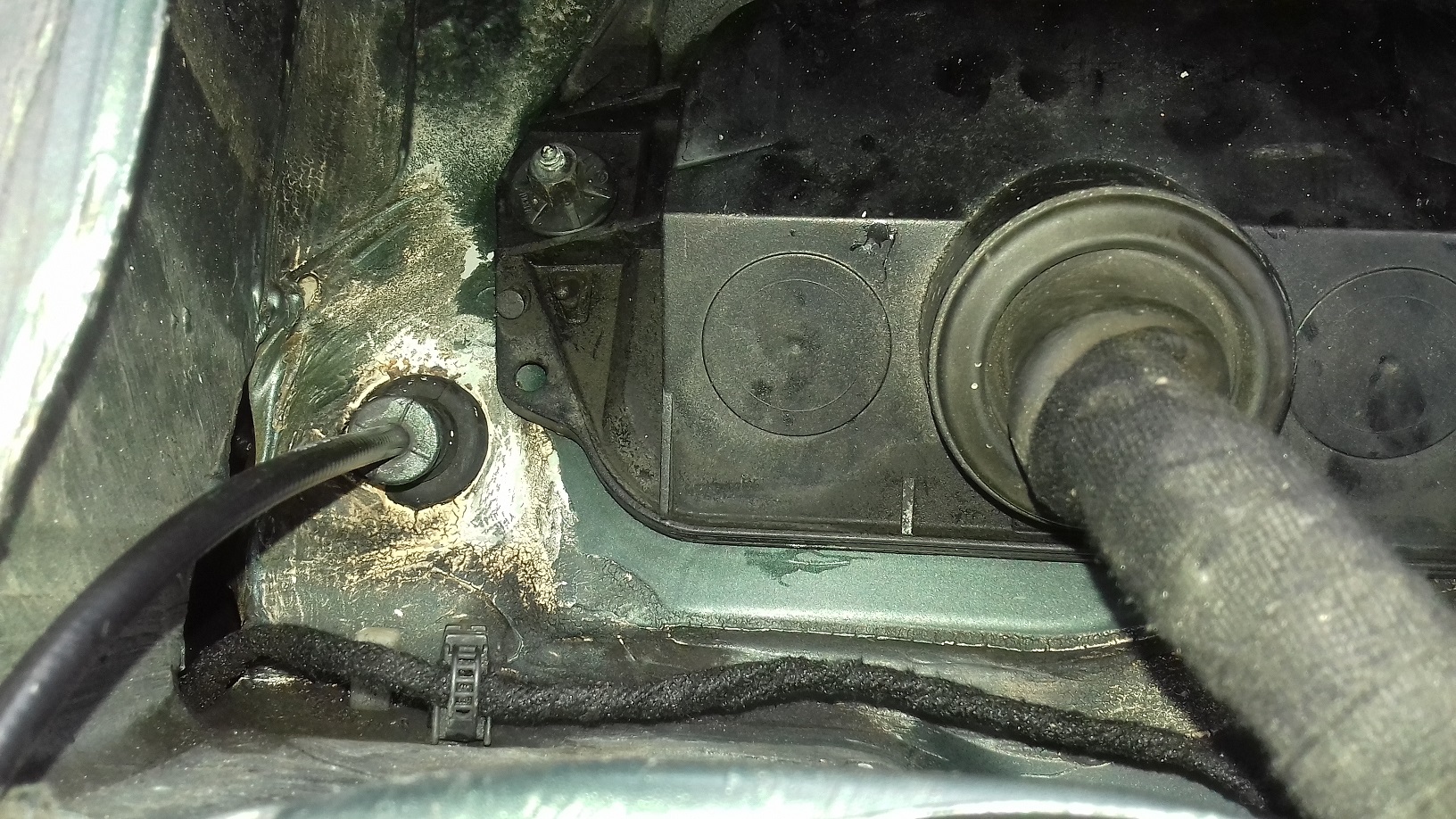

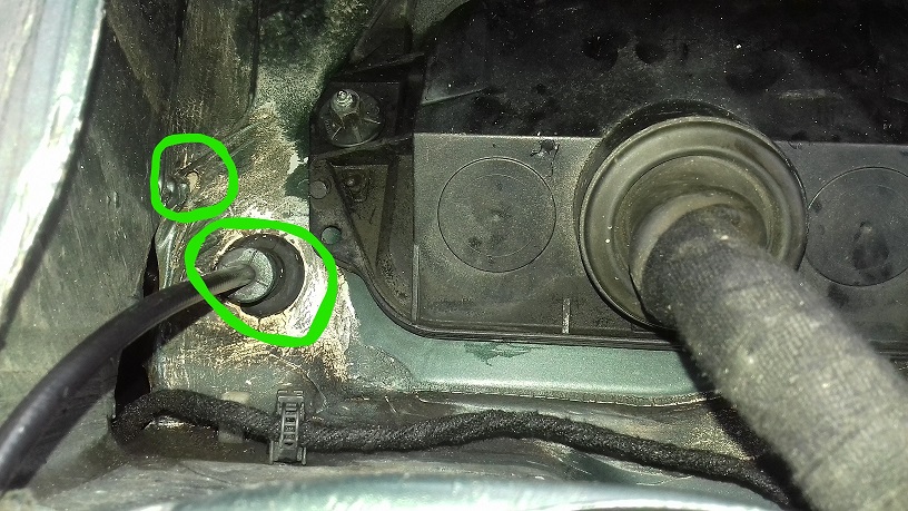

The 2 circled green areas are under the scuttle panel, drivers side. In case you don't know what the scuttle panel is (I didn't until a few days ago investigating my leaks), it's the plastic panel at the bottom of the windscreen, it has some cut-outs where the wipers sweep rainwater into the scuttle channel.
The wipers need to come off though, and the long rubber seal that separates the scuttle channel from the engine bay. Plus you will need to take off the pollen cover, but take note how it is all assembled before/if doing so. I also took out the wiper motor and frame to make it easier to clean the area (with an old toothbrush) and get rid of as much dirt as possible before applying the silicone.
The lower green circled thing is the bonnet cable grommet, and the upper green circled thing is a possible hole that might be letting water into the drivers footwell.
I've silicone'ed up the grommet (at the base where it enters the car) and also at the top where the cable enters the grommet. I didn't silicone the upper one though, it didn't look like a hole, but I'll have a better look in the morning, and seal it up anyway.
I also cleaned and silicone'ed up the rectangular plastic box to the right of the picture. It's referred to as the bulkhead cable box, or electrical box, and maybe some other names in various thread on this leak issue.

Thanks hopefully that's the problem fixed with it being sealed but you'll need to let me know after a good pure down of rain then if it's dry you know it's worked then I can attempt mine also Thanks for the info mate keep me informed thank you
W
Wheret is that tho on the car them green circled areas that need sealed???

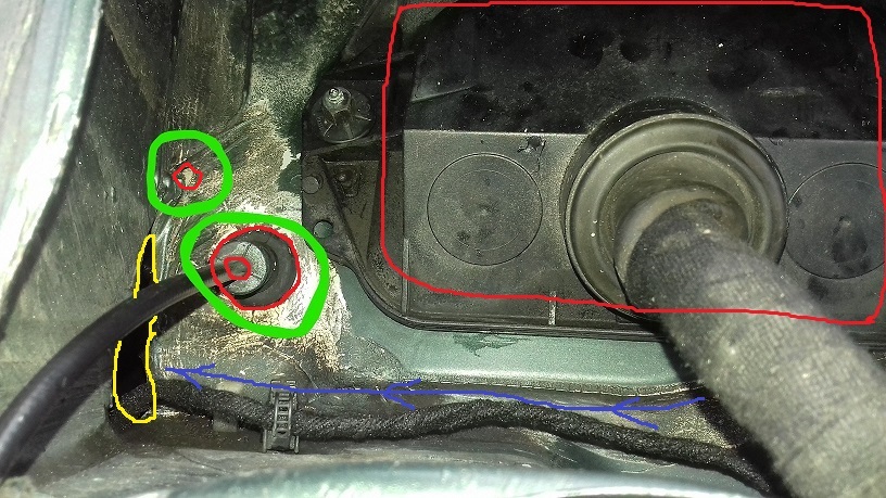

The red lines show roughly where I've silicone'ed, or intend to do. Note that around the base of the grommet, I put copious amounts around the interface between the rubber grommet and the body work. You can get a better idea of that from the pictures in the following thread, around the middle of the page. In fact, have a look though all 7 pages of that thread, you might get some ideas:
https://forums.seatcupra.net/index.php?threads/water-leak-above-pedals.185596/page-4
Also, just to be clear, I removed the rectangular electrical box, cleaned the seal and surfaces underneath it, before applying some silicone to the lip, and then pressing the rectangular box down onto it, and fastening it down with the 2 nuts. It helps to unplug the connectors too (4 on mine).
I also marked (yellow) the place where the water is supposed to exit the scuttle channel, make sure there is no dirt at this hole, mine had a fair plug of black silty/organic material which probably let the water sit in that area, and infiltrate the seals on the grommet and box.
The lowest part of the picture also has a blue line, which shows the direction the water should go along the lowest part of the scuttle channel to get to the exit at the left. I gave that channel a good clean. I think some people have ended up siliconeing this part too, you may see it referred to as the bulkhead seam (I think). I'm hoping it doesn't come to that for me.
The lowest part of the picture also has a blue line, which shows the direction the water should go along the lowest part of the scuttle channel to get to the exit at the left. I gave that channel a good clean. I think some people have ended up siliconeing this part too, you may see it referred to as the bulkhead seam (I think). I'm hoping it doesn't come to that for me.[/QUO
Thanks for all that info mate fingers crossed it all works out an it stops the leak hopefully it's nothing else
