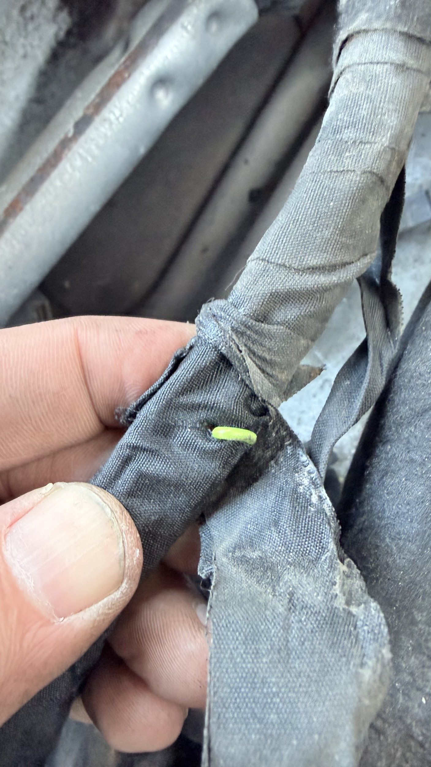

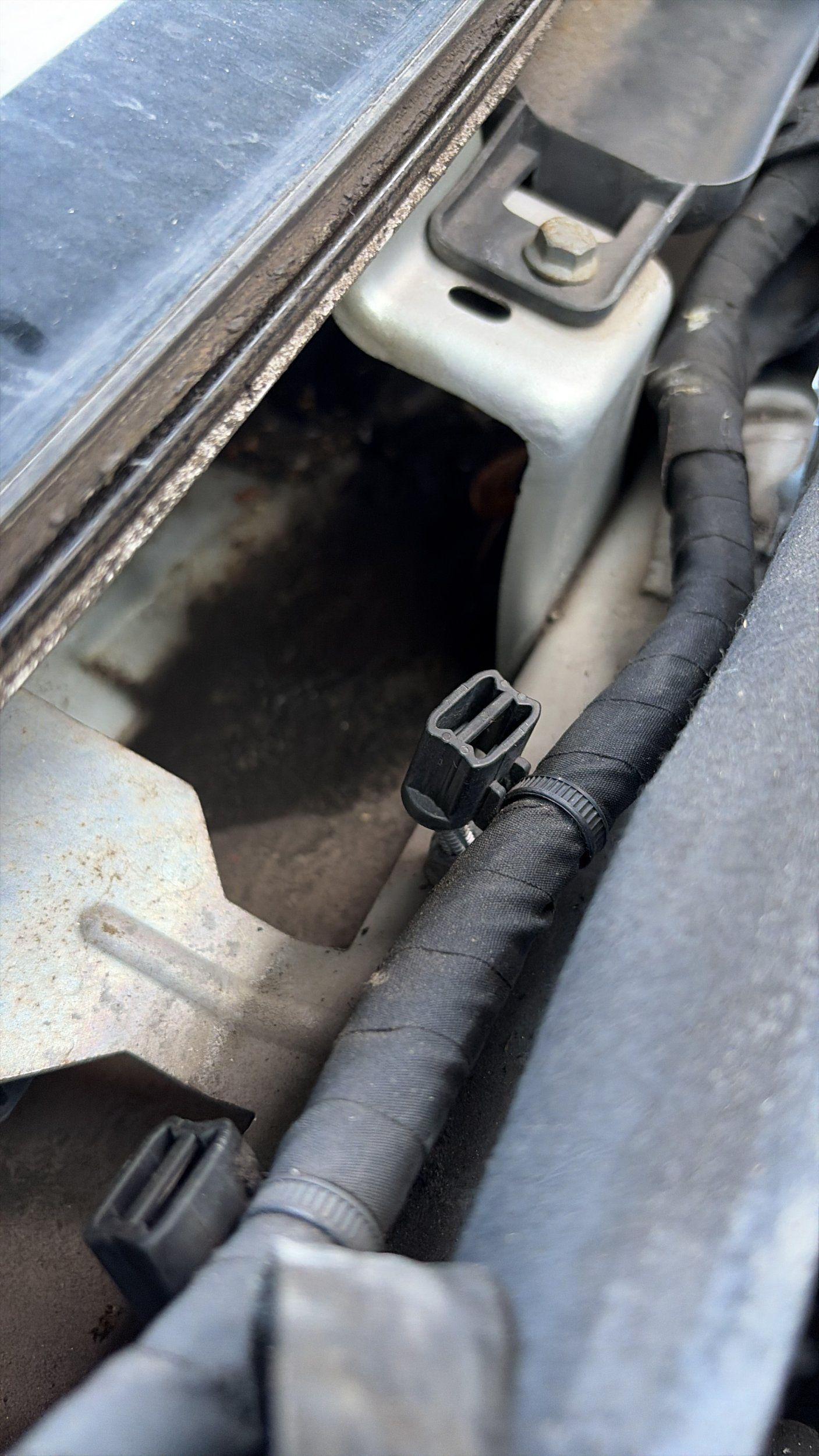

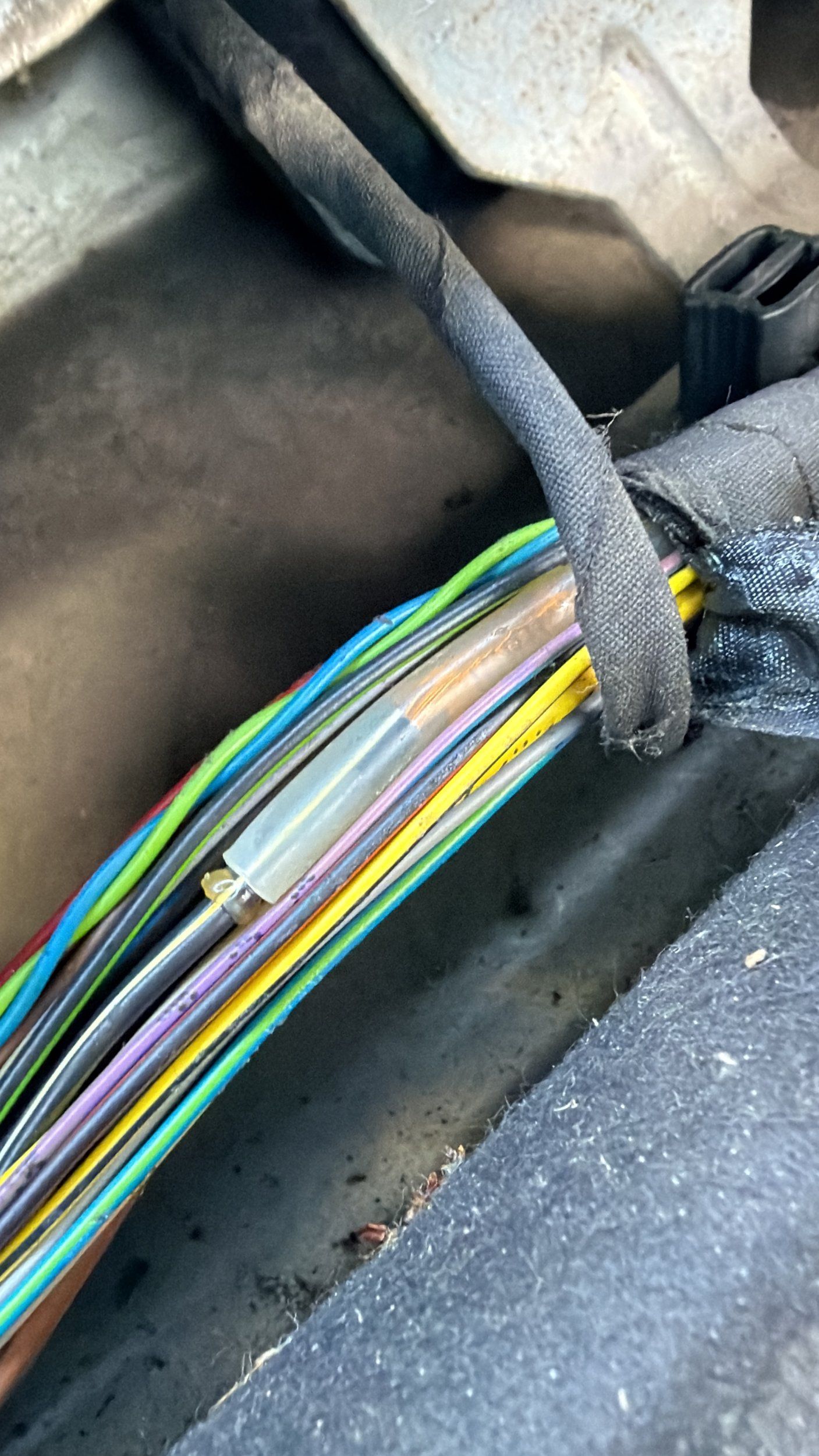

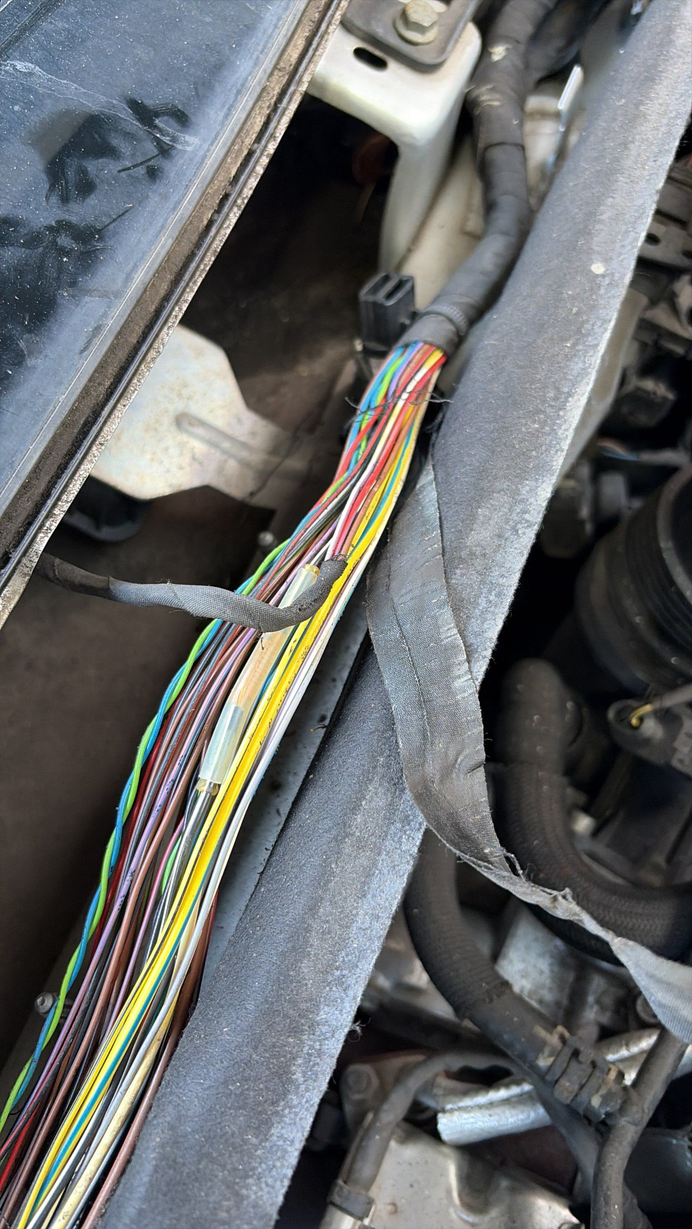

So I pulled the wiring loom from the wiper motor to the engine bay. It comes out of the crawl into the engine bay, near the battery. I didn't inspect the wiring loom inside the engine bay as I figured it's very unlikely to be damaged from that point onwards and would not be getting wet when it rains inside the bay (I could be wrong)
I did notice that part of the loom, passenger side was soaking wet - but it looked fine - there were two joins, that also:
A) Looked fine
B) Looked like might have been factory?
I did not look at the smaller bits of wiring loom that went from the crawl bit, under the windshield to bulkhead.
I've attached some images:
You'll see in one of the photos, where the tray is wet - but I couldn't see anything obvious there.

I'd open the loom in the bulkhead up as much as possible. It's usually the LIN signal wires that end up with water in and causing a drop on communication.
I removed all of the loom tape from wiper motor, till the loom exited the bulkhead into the engine bay. The LIN wire is the green/white wire from wiper motor plug?
As I mentioned, I couldn't see any issues. Would I have better luck testing with a multimeter? I dont have one, but can grab from Halfords.
What should I be looking for? I was expecting to see a wire that was bare / broken - maybe I need to look for other "signs" of damage?
Appreciate if this is all obvious to most; but first time I am trying to fix an electrical issue on a car.
Maybe I could run a new LIN wire from engine fuse box to the motor plug as a test as well to rule out the LIN being at fault? (Probably a dumb idea, just spit-balling :) )
Thanks for the help. James.
The wire doesn't tend to be broken, it's usually that the insulation has opened up and allowed water inside the wire. It corrodes the copper and creates a high resistance situation.
