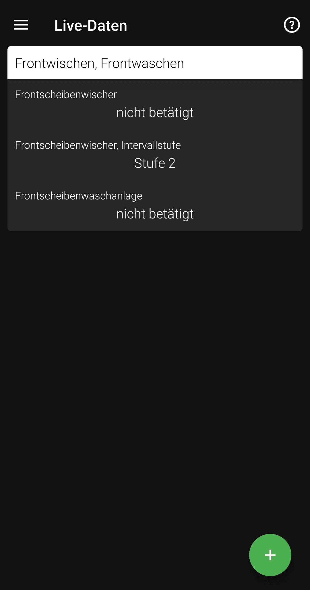

The OB11 tool doesn't give live data for the stalk position.
Wrong.
If you have Control unit 16, you need the live Data from unit 16
