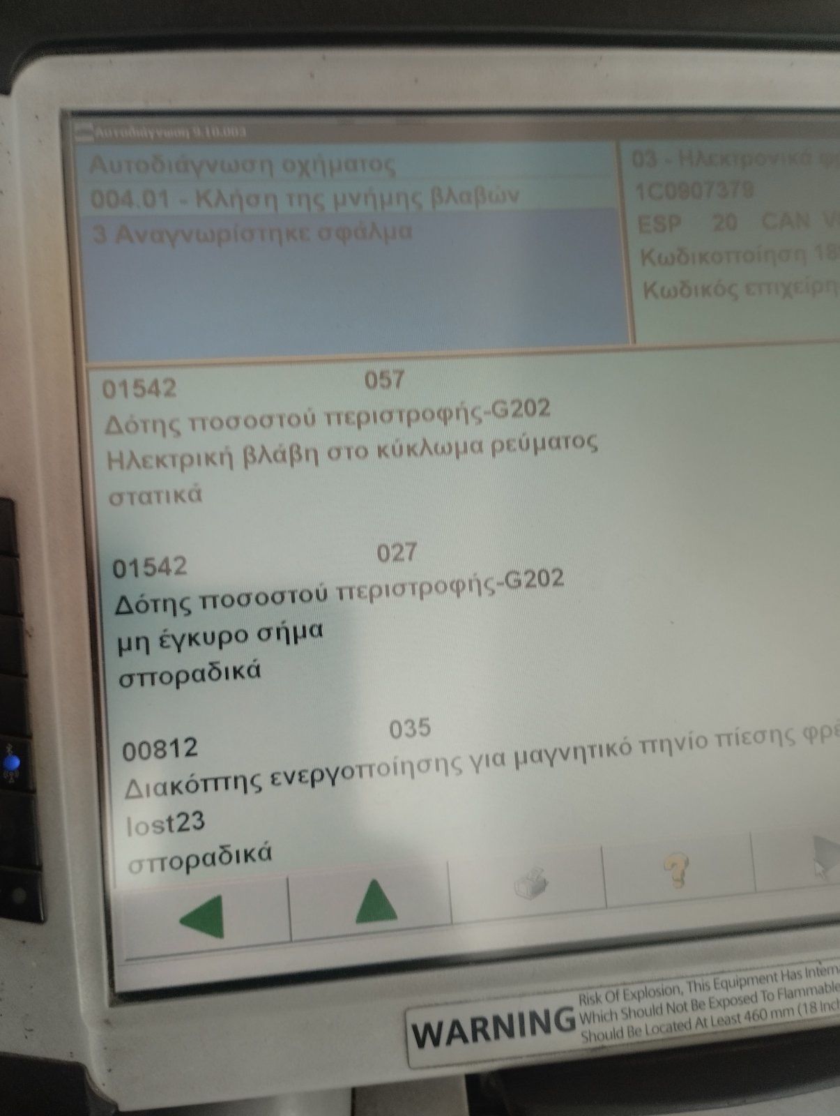

Hey guys!! I know it's been a while and you probably don't remember that issue but just in case, how can I fix this problem on a Seat Ibiza Cupra 6k2? Where is the Yaw Rate Sensor located?
I'm facing the below fault code: 01542 - yaw rate sensor (g202)
any answer would be amazingly helpful
in the picture below you see 3 faults. only the first one remains..
