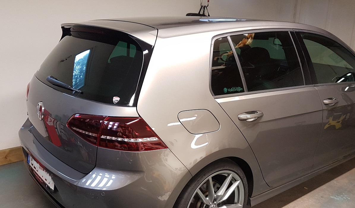

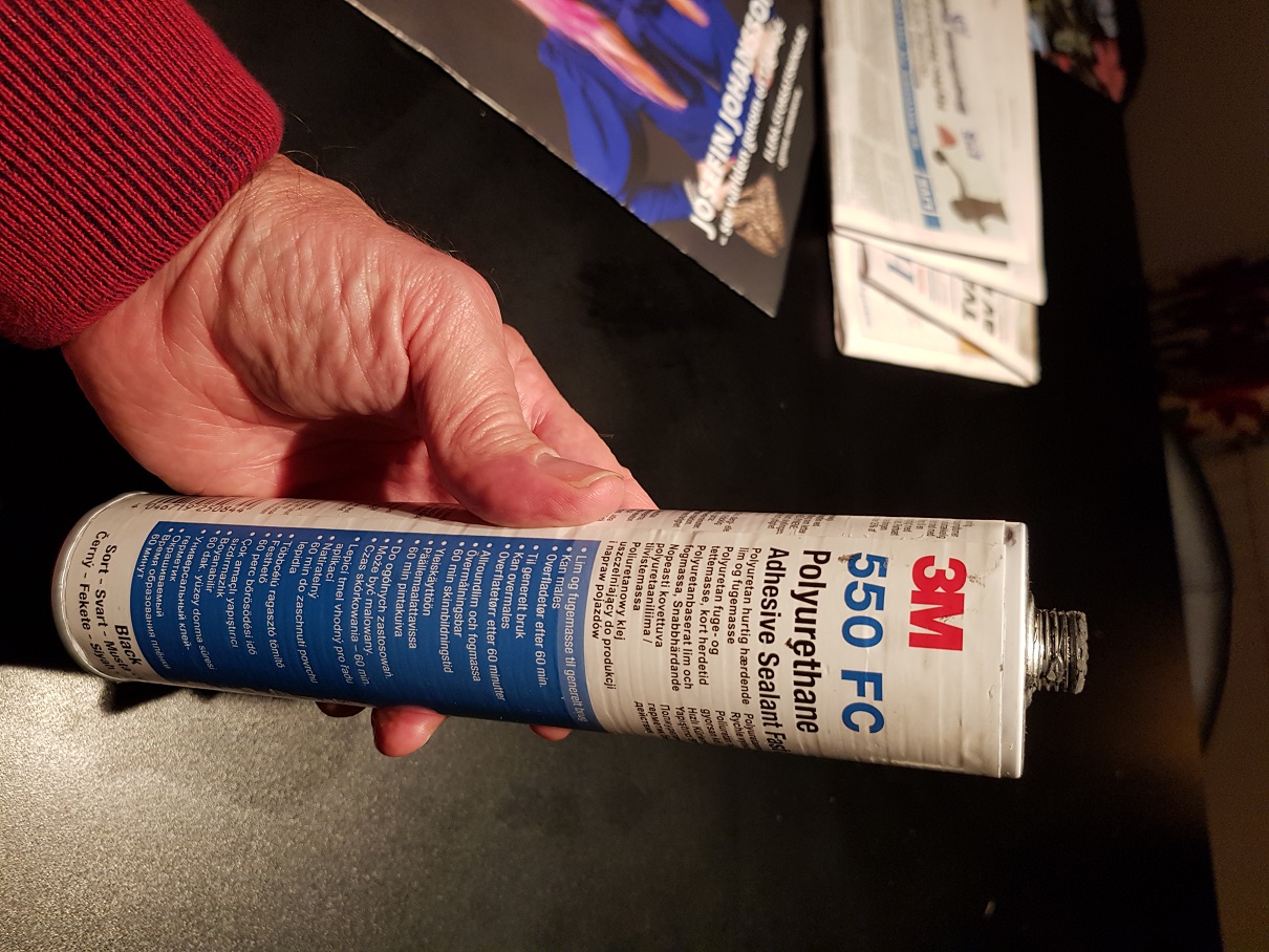

I used 3m 550 FC to replace my loosen blades on former Golf R. Rather cheap,
about 7-10£. Great strength.
