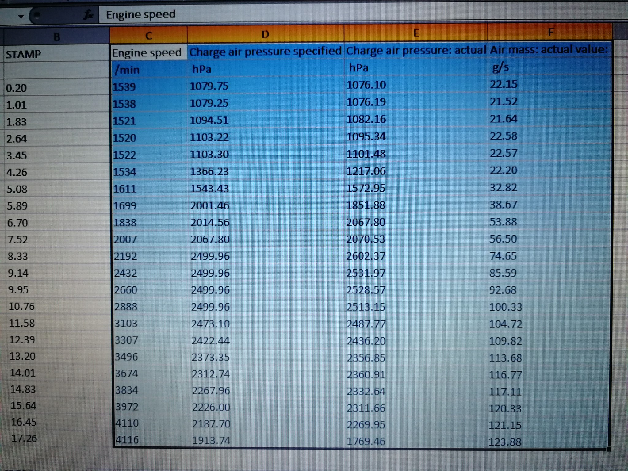

So today I removed it just to see if I could notice any difference. At WOT the MAF registered around 120gr of air, tomorrow I will put it again and compare, but what I noticed was when I floored it I felt a loss of boost when reaching 3000rpm the same feel I get when the dpf is regenerating. Could it be the ecu adapting to the new values ? It was strange.
When I changed the air filter couple days ago, I felt a slightly difference, more responsive throttle and a linear boost until 4000/4500rpm like normal but today I removed the white layer and this happened...
Checked with vcds and no codes

So today I did some logging with vcds and did a 3rd pull wot, didn't feel the power loss I felt before, the car pulled through the entire range but after fiddling with excel I managed to atleast sort the values, couldn't make a graph.
It looks like the car is over boosting hence why sometimes I feel a slightly power loss.
What could it be?
