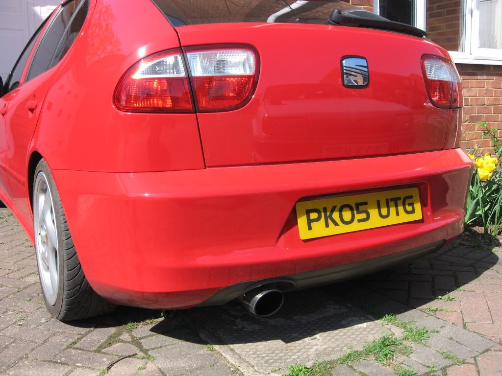

cupra r bumper fitted up soon to have the bottem middle part carbon wrapped

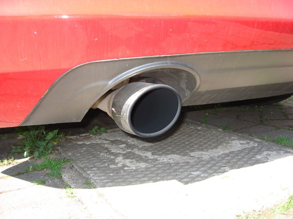

custom exhaust has been made and fitted with ani golf tail pipe to be a little different but still oem look
have to say this has made the car drive so much better its my best mod so far and to top it off inside the car you can hear no extra noise at all but from outside it has nice little raspy note too it under load

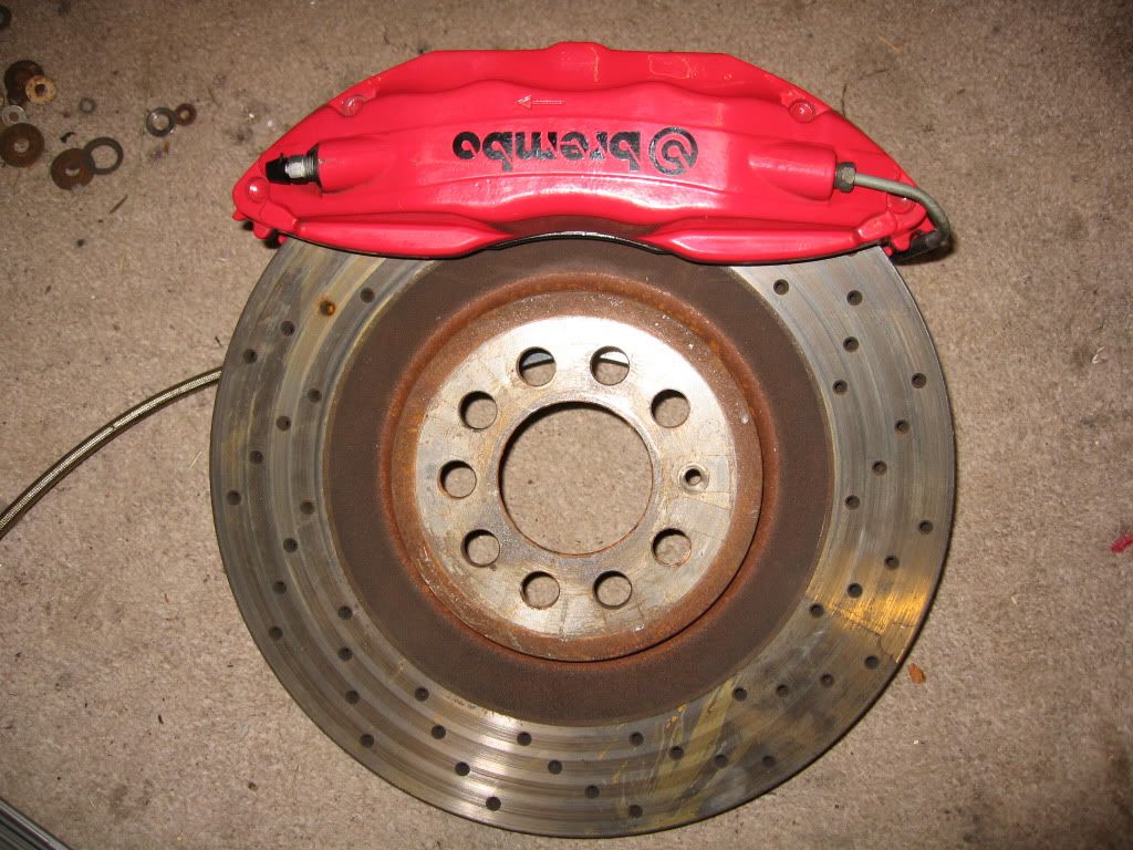

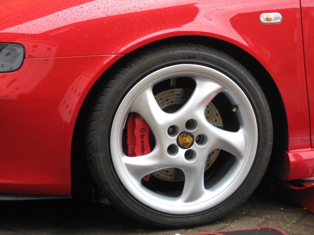

now after abit of net searching i came across this small set up.
now when i say small that should really be stupidly big:D
these bad boys are porka 993 turbo front calipers with 323mm discs and braided hoses
now the second pic shows them fitted up they arent currently bolted as due to the size i need to run a slight spacer

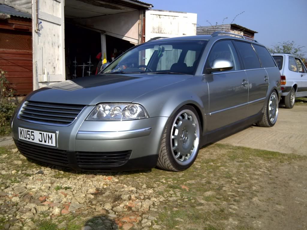

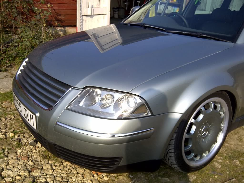

gave my borthers passat some buffing the other day with him
this is his daily and its daily ride hight

so brakes all bedded in now and stops on a penny and gives 5p change so well chuffed
have fitted 15mm spacers on the rear to give it abit of poke as i'm running 10mms on the front due to the brakes cars seems to look alot more squated now and has helpped it through courners too so real pleased.

wheels are 18's and 8 inch wide twist reps so their vw stud pattern.

From which car you got the brembos from?
I want to upgrade mines too but dont know what will fit and what not.
hi drka yer the brembo are one of my fav mods as well as the wheels in which i,d decided thats what i wanted to fit before i even had the car.
like yours alot loving the merc wheels plus leons look the best in red lol
gdjohny
brakes are cupra r discs 323mm and porka 993 turbo calipers but you'll also need caliper adaptors which can be brought from well know auction site. you may also need a wheel spacer the size will depend on the wheel you run

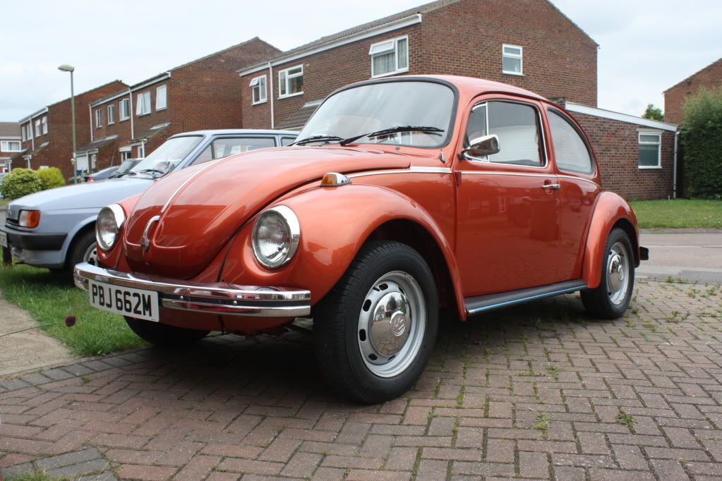

the bug i building to sell was finished and sold as i being used daily by the new owner who loves it :D

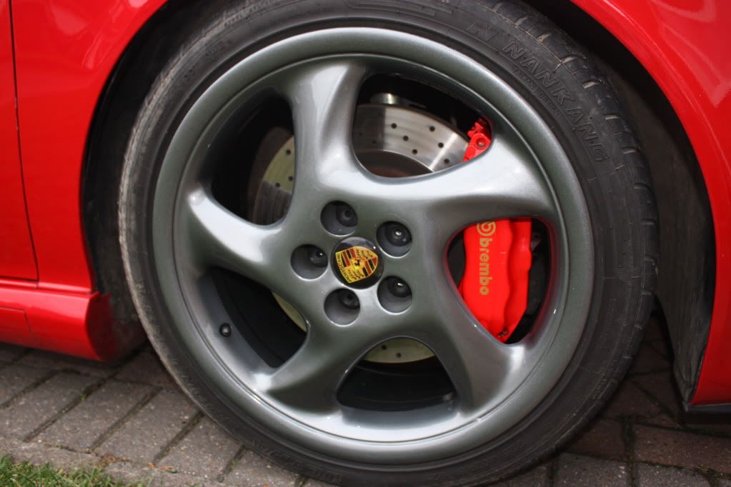

seat has had couple of changes too wasn't liking the wheels in silver as i didn't think they stood out enough so i have done them a dark silver colour. once i'd done this it made the brakes look rough so they have been off front and rear and have been fully rebuilt and paint with new decals also

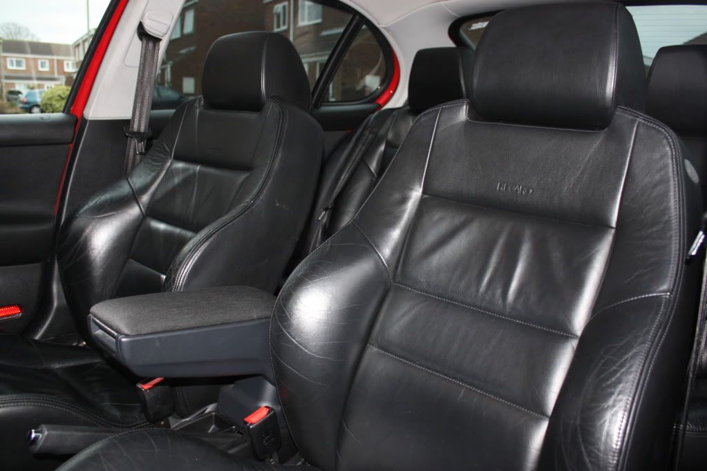

but i have had one last little spend on the car before the baby arrives and bought a full leather recaro seats from a v5 golf which are also heated.

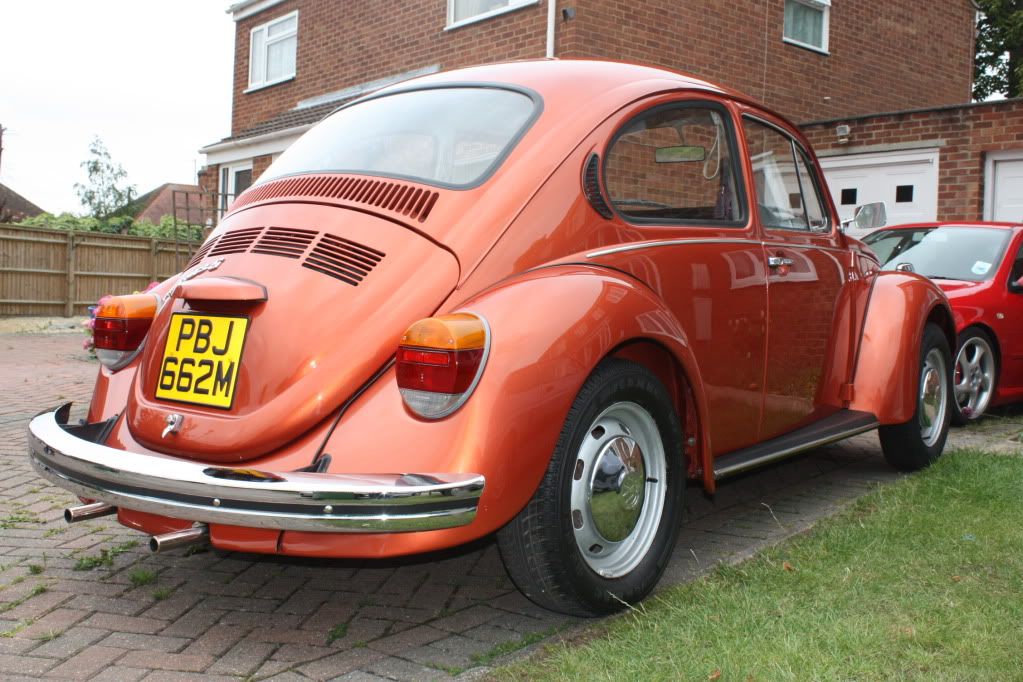

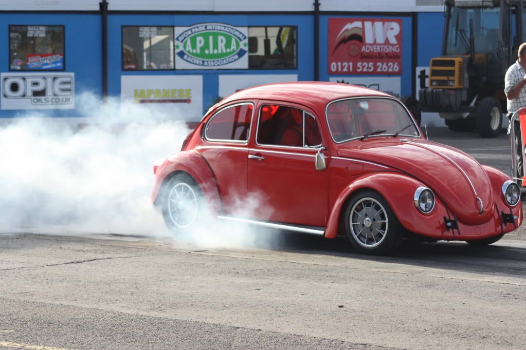

my bug has also had couple of updates also it's now fitted with cut slicks on the rear to help bring my quarter mile times down hopefully as not been able to test it yet and is also being featured in one of the uk vw mags in next month or two which has made it all worth while
http://i160.photobucket.com/albums/t163/alexvw_2007/I
oh and one it on the strip when we stripped it out before end of the year

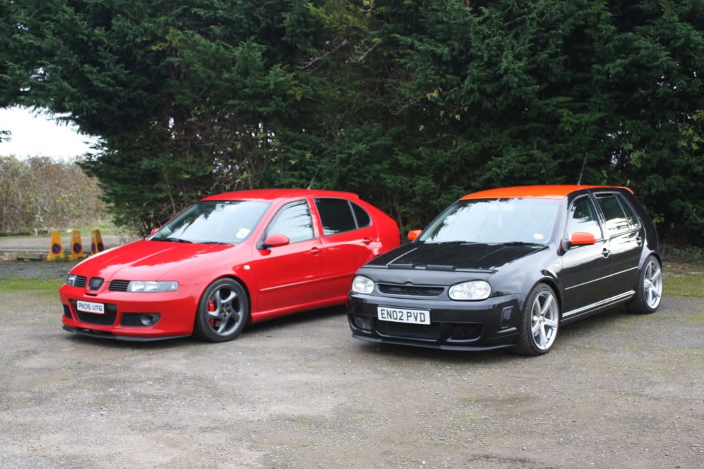

last pic is of the leon with a friends mk4 tdi pd150
let me know your thoughts
Been looking at the last pic and was thinking your car looked weird. It's missing the b puller trims. Looks much better with it on IMO
turboboy i did also think it looked odd with them missing when i first got the car. they had been removed by the old owner but i now prefere it with them missing.
Love the bug dude! Is it set up for anything e.g. 1/4 mile etc?
Can't beat porka's on a Leon but then I'm biased lol.
